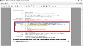

jaguar.awd, the code you are talking about can be caused by 5 conditions that the car sees:
1 Inertia switch activated
2 Throttle Limp Home mode
3 Engine starts and stumbles
4 Engine fail to start
5 Engine stall
Since you don't mention the engine RPMs being limited to 3000 RPM, we can rule out #2. We can rule out #1 since you say that you have reset the inertia switch and you are able to drive the car. So, this really leaves us with a rough running engine. Based on past experience with the car, I would say that you need to access the rear spark plug wells and see if you have oil in the wells. It would probably also be a good time to replace the spark plugs since you are in there. The seals to the valve covers can leak and allow oil into the plug well which can cause the engine to run rough. Granted, this tends to manifest itself with P030X (where X is a number between 1 and 6), indicating a misfiring cylinder.
Otherwise, have you noticed the engine is hard to start or needs multiple attempts to start? Lets see if we can get to the bottom of this.

Why do you suspect the gas cap is damaged? If it is, or something related to the evap system, that could cause the check engine light to come on. However, that would cause a code to be stored and it would sho up as a stored or pending code. Again, P1582 would NOT cause the check engine light to come on. You have to have another code(s). Borrow or buy a scanner that can read P Codes as well as clear the codes. And if you clear the codes, see if the check engine light comes back on and if it does, then post those codes here and someone here should be able to help you in diagnosing why the check engine light is on.
Are you saying your car runs perfectly fine, except for the last year the check engine light has been on? Or do you have any driveability issues at all? Can you rev the engine over 3K RPMs without the engine stumbling?

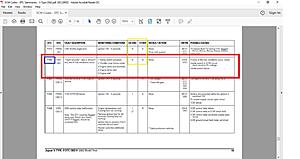

In May 2017, I had yellow check enigne light, and 2 in "Volvo - Toyota" service detected codes: P1647 and P1582. I replaced then sensor C2S51801 and all spark plugs.
After that replacing, yellow light was gone and I was "happy". But only 50 miles after driving, yellow engine check light came back. In "Volvo - Toyota" detected only "P1582", nothing more. They (in service thought - maybe problem is with throttle body)..
After all infos here on forum, I learned P1582 is just information code, not faulty code.
But, still remains that yellow (amber) light.
That yellow light remained on dash 10 month constantly.
Yesterday I made "hard reset" (negative wire to positive on accumulator) but yellow light is still on dash.
Today, I disconnected negative wire and after several hours I will see result, but I am sure, yellow light will stay.
Next week I will go to "Volvo - Toyota" service and they will check again codes. I do not know what to do if only code would be "P1582".
They will "swich off" amber (yellow) light by computer, but I am sure, after several miles, bloody light will appear again.

jaguar.awd,
The P1582 is not the cause of your CEL being on.
The reader being used must be missing the real culprit as JagV8 stated.
I do not know how much you have spent with these guys so far, but for less than $120 you can get an iCarsoft-930 OBD2 reader made for your Jag from Walmart, Amazon, eBay, etc. This device will also do ABS, Passive Restraint, etc as it can read and reset other modules in your car.
For around $10 you can get an ELM 327 bluetooth OBD2 reader from Walmart, eBay, Amazon and get Car Scanner Pro software for your phone/laptop at a cost of $2.99. There is other software also available (Torque seems popular). They all will read Pxxxx codes and clear/reset the CEL. Scanner Pro also allows you to capture the car's condition using a freeze frame when the CEL is triggered. Finally, you can monitor, log then download up to 4 engine sensors real time or set up a dash panel which allows you to monitor as many engine sensors as will fit on your screen.
I hate relying on others to tell me what my car was doing, and there are many, many inexpensive ways to keep track of it yourself, real time.
