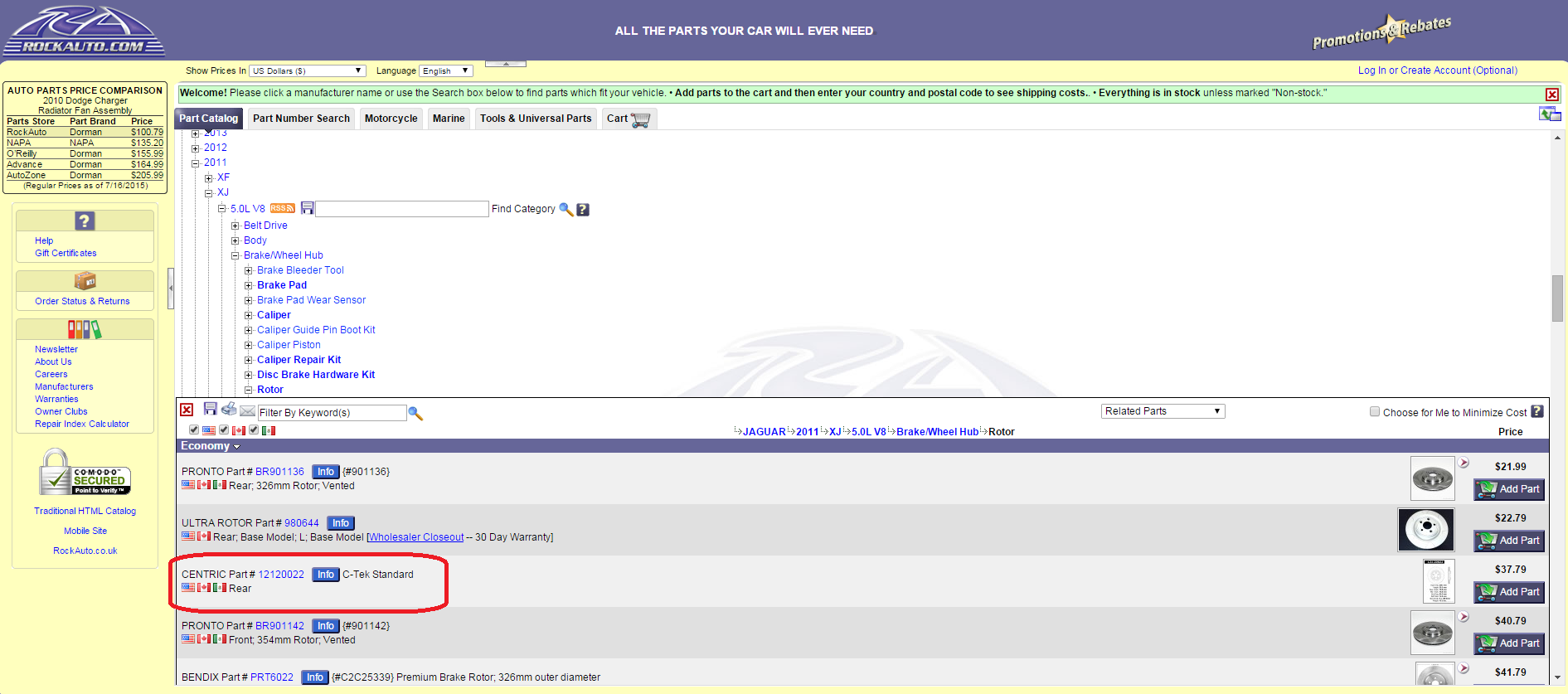

I did all 4 wheels recently with Centric Posi-Quiet Ceramic pads and Centric disks, all ordered from Rock Auto. I've had good luck with their products previously, 1000 miles later I'm happy with this setup. The reduction in brake dust from switching to ceramic is awesome - no more filthy wheels!
One warning. DO NOT buy Centric REAR rotors from RockAuto - they list the wrong part on their site, as indicated below.
