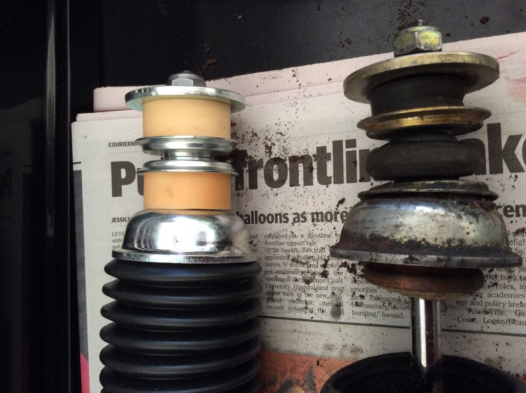

Having recently replaced front top & bottom ball joints & upper wishbone bushes I noticed my drivers side shock absorber (originals I presumed) not looking too good. The upper built in bump stop was shot, had gone powdery & not much of it left & the upper bushes were not of the original type, merely generic rubber style.
The bushes were replaced prior to my purchase & attached photo shows that mechanic (not impressed with ) had assembled them with the bottom washer incorrectly fitted plus the incorrect type of bushes as can be seen in photo.
Might just add that I replaced them with original specification green Bilstein 24 -018630 obtained from Michigan Trucksprings, Saiginaw USA & they were very reasonably priced plus received by me here in Australia in just 6 days.
Parts from our capital cities can take longer here in Australia.
I will attack the other side tomorrow. Looking forward to an improvement in front end behaviour.
John Herbert
On my list too. I replaced the rears a couple years ago (wow time flies) but I know the upper bushings on the front shocks are shot, and I suspect the inner bump stop is too.
The real crime is that to replace the bump stop and shock bushings approaches the cost of the entire shock.
I've got the four black Uro upper shock bushings on the bench for now. Not sure if I'll just replace the shocks, but they get pricey at ~150USD each as I recall.
