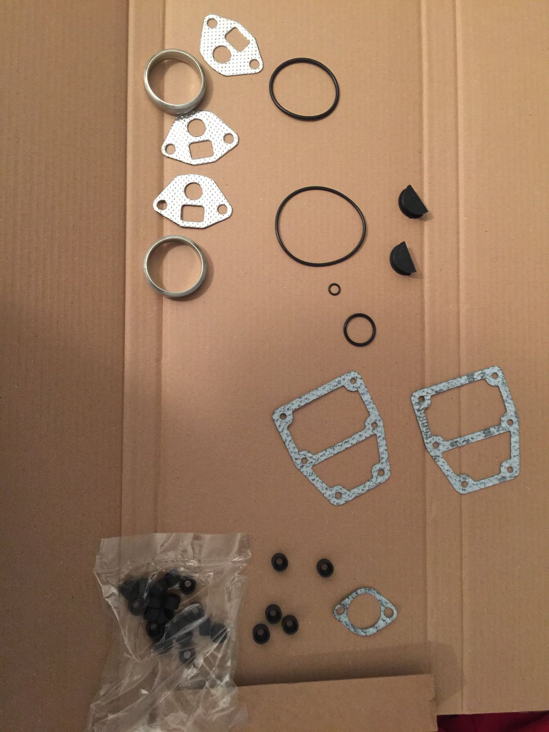

Okay, i got the engine gasket kit, but I don't know why the kit came with two intake manifold gaskets, and I don't know what these other gaskets are..?

Well,the two thick round donuts are for the exhaust manifold to downpipes. The one on the bottom right looks to be a thermostat gasket. The two half moon shaped black ones are for the ends of the valve cover. The bunch of little black ones look like valve stem seals.The three silver ones look to be for the EGR valve. Not quite sure about the rest.

**Correction** The one on the lower right may be for a water inlet manifold or if it's a universal set with six of these then it may be for the later X300 coil to valve cover gasket. Depending on what type of Thermostat housing you have you may either have a similar gasket ( only larger ) or one of those large o-rings.

I only saw one of those that's on the lower right. I just realized that those two square shaped gaskets may be for the oil filter housing. One goes on the block, the other goes between the oil cooler adapter and oil filter housing. In the midst of everything, I also ordered a new idle air control valve. Figured that I might as well get a new one cause i had trouble getting the old one cleaned. I may also see if I can get the oil filter housing off and change those gaskets since the top half of the engine will be removed. Still wondering why I received two intake manifold gaskets. Oh well, it's no big deal
Definitely a good idea to address all the common left side oil leak points while it will be so easy. I don't see the oil filter housing gaskets in your photo but you can just use RTV, which is what our '93 had from the factory. The earlier cars had gaskets and I happened to find a set so I used them, but on freshly-cleaned surfaces I think Permatex Ultra Grey RTV might be even better than a gasket (the Grey is more rigid and stronger than the Black so that's why I recommend it for metal-to-metal joints that do not require flexibility):
