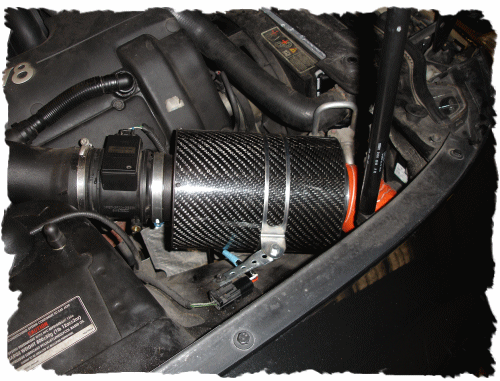

Totally agree I did the underhood Cone filter and it gave me the sound and mabe a little extra GO mabe the first five minutes of driving but on long trips or hot days you could feel it make more noise but seem a little sluggish. This is my setup now its a little rough but defenitly a difference dont really get the lag as much and I can do 140 with the top down with ease.Click the image to open in full size.
Reply With Quote
Old 07-30-2010, 09:25 AM
avos's Avatar
Join Date: Apr 2008
Location: Europe
Posts: 2,213
Thanked 374 Times in 312 Posts
Looks good, can't realy tel from the picture but have you removed the fog light?

no i didnt remove the fog light I had to do a little metal trimming here and there to get it to fit and not poke into my fender well
