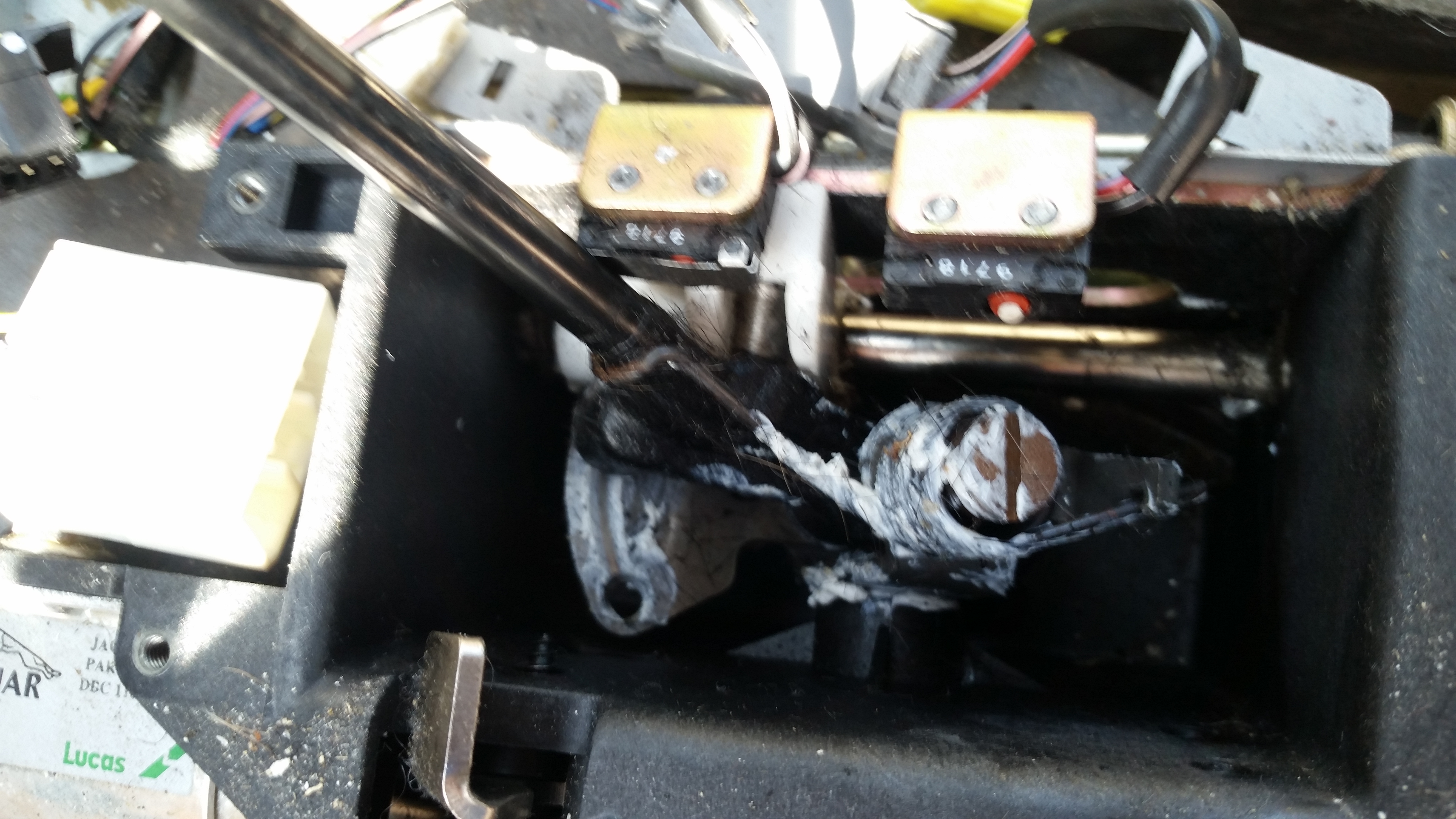

I know I probably seem crazy but I have looked at dozens of drawings of a linear switch and I can't for the life of me see it. Since I am not the kind who just starts disassembling things ***** nilly, Could it be hiding behind this stamped bracket? If so the drawings seem to show the switch sitting on the bracket.
Where is the linear switch in this picture?

The photo shows the micro switches he mentioned. They are under the J gate. The photo is from one of my parts car and if you look close one of the switches is missing the metal lever that sits on the switch. While you have the console open start the car up and put it in gear to see where you clicking sound is coming from. I'll bet it is from the solenoid on the top left side of the shift mechanism.

Yes, the solenoid is the item making the clicking sound. You can feel it when you put your hand on it. So, there is no U-Shaped Linear switch just the small microswitches?
