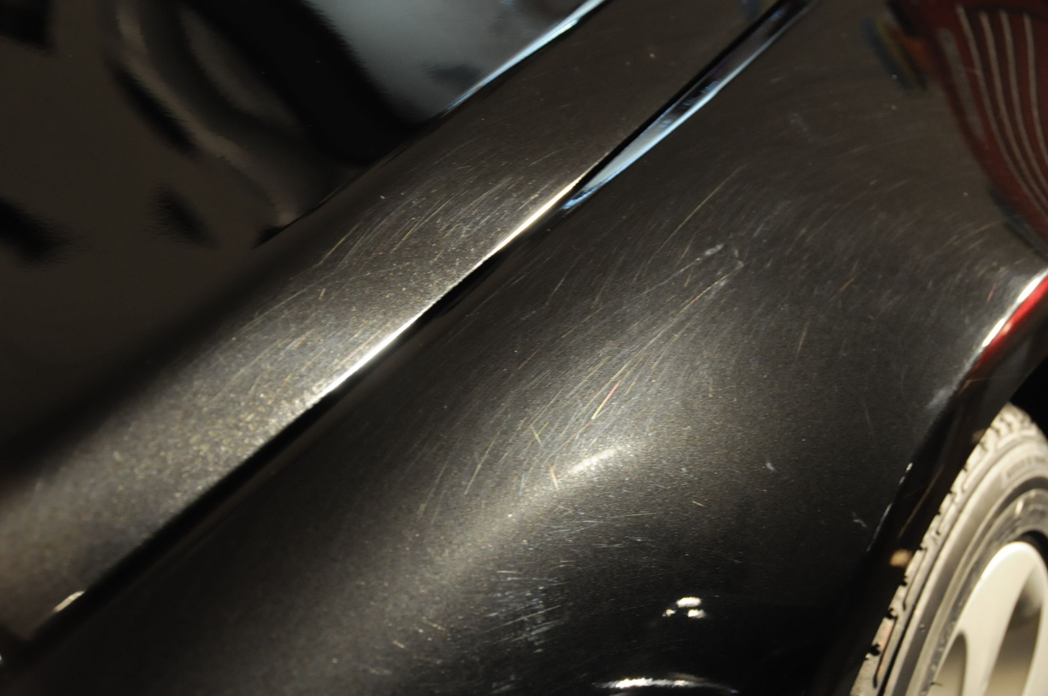

Front fender scratches and swirls
Attachment 65876

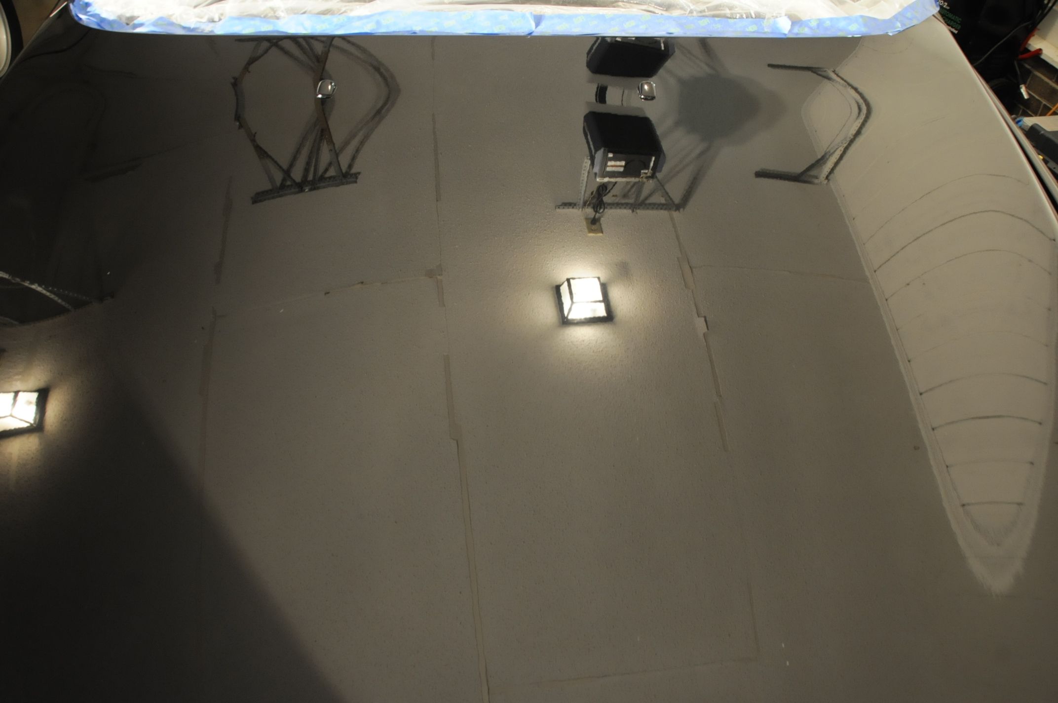

Fender after compounding
Attachment 65877
another shot of fender after compounding. NO polishing
Attachment 65878

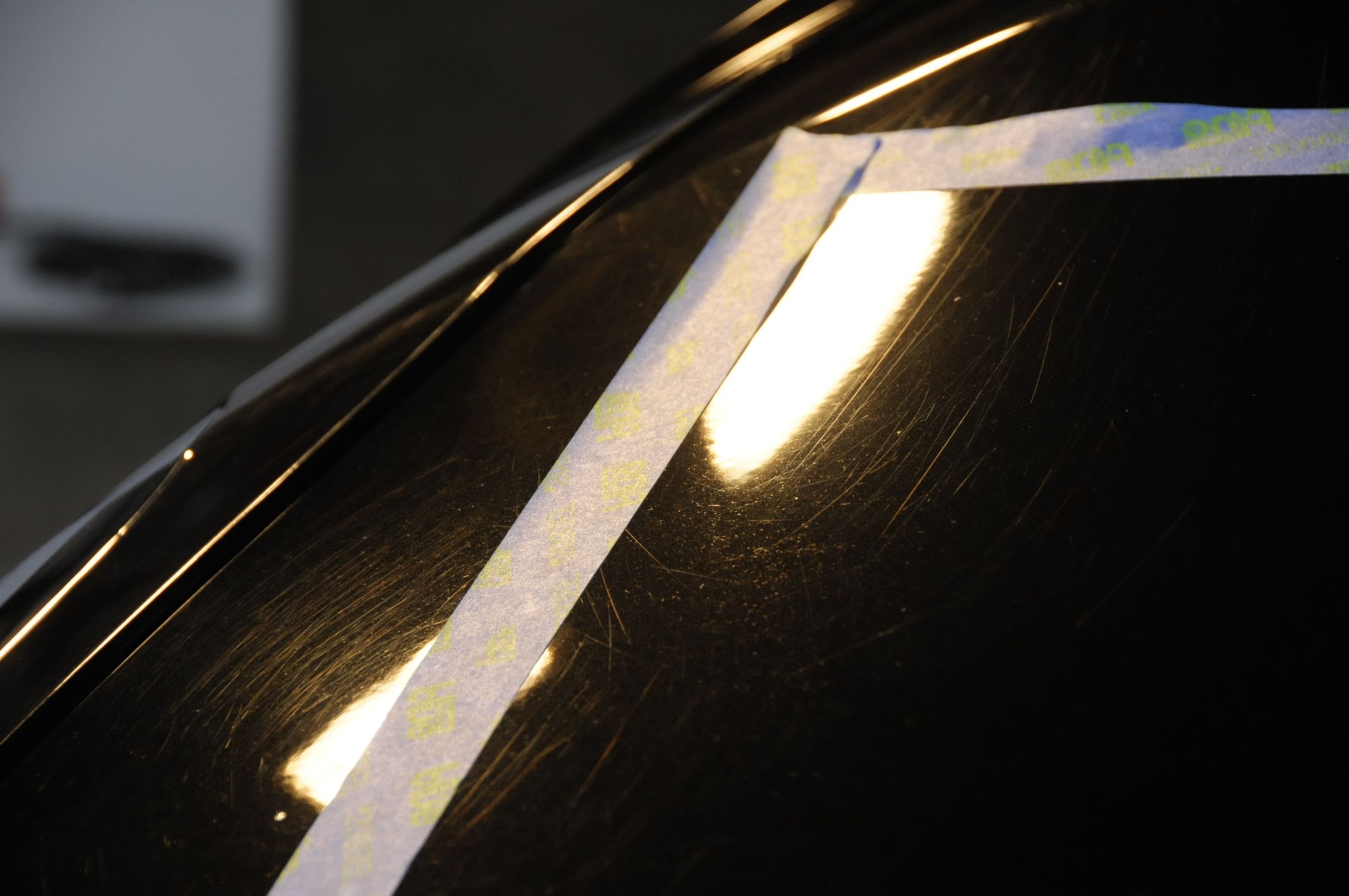

Really ugly scratches on the bonnet let down the side.
Attachment 65879
Bonnet after compounding. I say again, this is ter application of the compound with a yellow cutting pad. To my mind the finish is great, can't wait to see what it's like after I polish it :)
Attachment 65880
