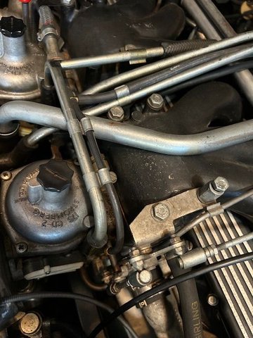

thanks, this is very helpful. really helpful. here's a photo before the air intake box was put back on. i don't seem to have that big pipe for the gulp valve. i'll check tonight if there's any gulp valve infrastructure in the V. Again, thanks very much.

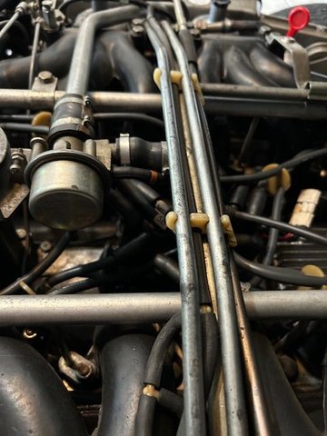

hi lr grindley. yes, my car doesn't have any of the gulp tackle. you might be able to help with another topic. there's a pipe coming from distributor, over the V and snakes under the rear throttle body. The Al pipe here is then , but it's open ended and terminates under the rear left throttle body. i can't find a logical nearby place to connect it. do you think it was part of the gulp assembly? there's a vid here, correct orientation, looking fwd from behind left rear throttle body. you can see the pipe on the right in the last second or two - has some green paint on it.

photo here might be more helpful. it's interesting, i come from england so we didn't have to go through any of this smog situation.

English - I'm away from my car until tomorrow but will check then and get back to you. I'm pretty sure that's a vacuum pipe that runs between the intake and distributor but want to double check. If so it should have a rubber connector that connects to the intake manifold on one end and a rubber connector to the distributor on the other end. I'll confirm tomorrow.
In the meantime do you have a vacuum line connected to the distributor retard capsule? Also do you have a group of black rubber vacuum hoses (4 IIRC) coming out of a thermal switch on the right side, rear end of the intake manifold water pipe? If not your whole vacuum system may have been removed. Most of it is emissions related so the engine will run fine without it but you want to make sure all the inlet manifold vacuum ports are plugged or you'll get a lean condition on one or more of the carbs. Vacuum leaks in that system are a common cause of poor engine performance, especially if someone has tried to tinker with the carbs to offset the leaks in an attempt to get it running right.

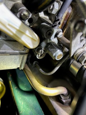

Hi lrgrindley, thanks for your message. i wanted to write and clarify my mistake. the open metal pipe from under the rear left carb/ throttle body does not go to the distributor. it goes to the other side of the engine (video), where there's a group of three tubes, with horizontal yellow stripes, going into what might be a part of the RHS air intake. I don't know the meaning of this.

I checked my car and that thin metal tube you showed should connect on one end to the intake manifold just behind the LH side rear carb and the other end to the black plastic part with the four rubber lines in your photo (not directly to the distributor as I thought). That black plastic part is a thermal switch and is screwed into the back end of a coolant pipe. The rubber and metal line that connects to the back of the LH side manifold connects to one of those four rubber lines and supplies vacuum to the switch. The vacuum it provides is switched to the other three rubber vacuum lines depending upon the engine temperature. One of those other three rubber lines connects to the distributor to retard the timing when cold, another runs to the gulp valve (which you no longer have), and the third (I believe) runs to the two air boxes to open and close the warm air intakes (for emissions control, to warm the engine up faster when cold). As long as the vacuum supply line from the manifold and line to the distributor are connected you should have all you really need. Just block the other two lines on the thermo switch (to gulp valve and air boxes) so you don't have a vacuum leak.

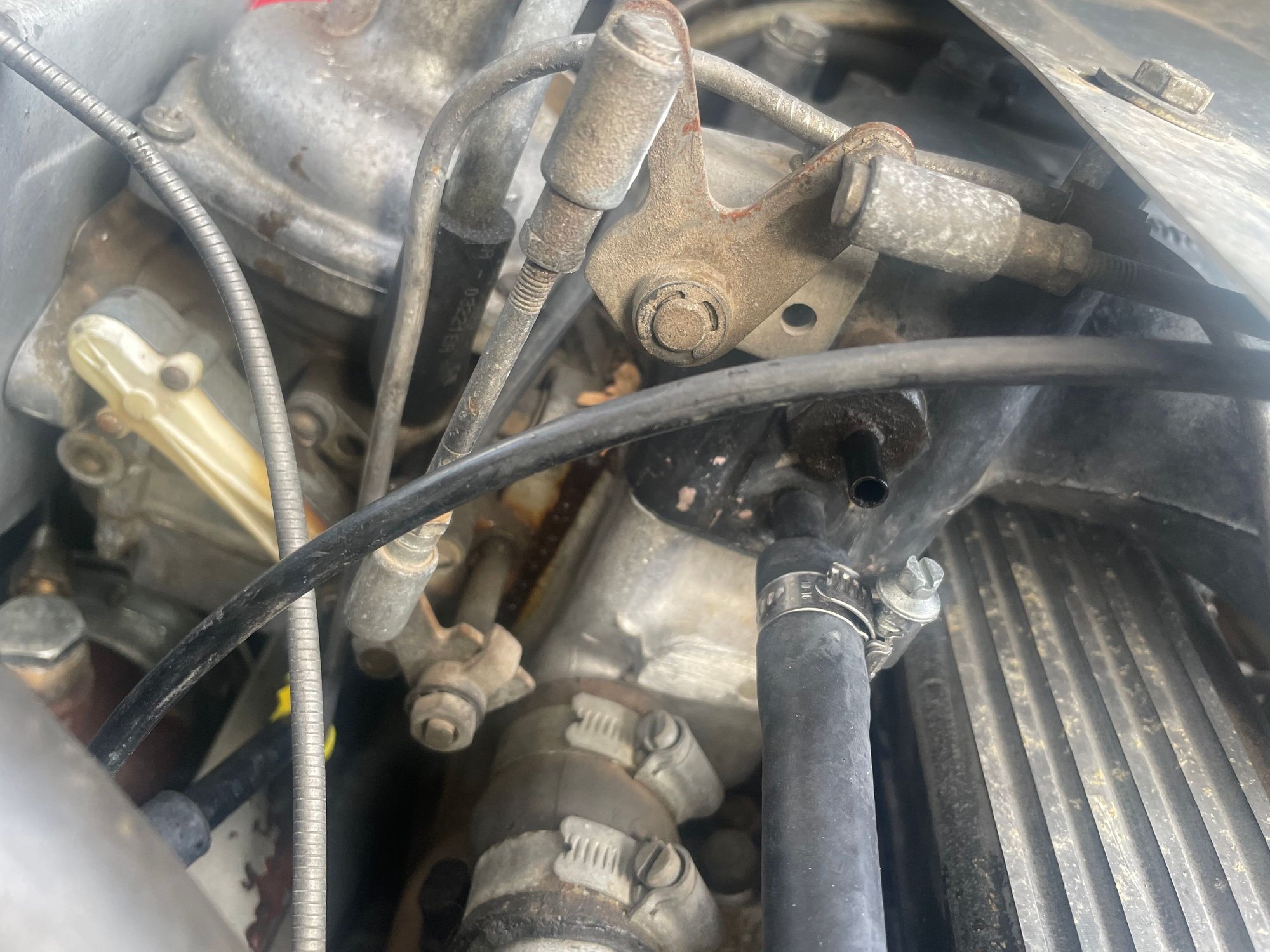

Hi lrgrindly. Is this the nipple on the air intake that I should route to? In the middle of, slightly right. I uncovered the nipple-was capped before.

The open nipple in your photo is blanked off on my car too. Not sure what it was intended for but it's not used so keep it plugged. The small metal pipe attaches to a rubber elbow below and just downstream of the LH rear carb. If you can get your hand in there you should be able to feel the nipple. You can just see it in this photo.
There are lots of places where you can get vacuum leaks and as you have found out they can really hurt the performance so are worth tracking down. All too frequently ill-informed mechanics have screwed up carbs and timing trying to make the engine run right, not realizing that a vacuum leak (or two) was the cause of the problems. Keep at it. I'll try to help as much as I can.

hi lrgridley, thanks very much for your photo. its that your "hanging" thin pipe routes under the LH rear carb, as mine does. and i see there's a stout rubber connection on yours. you describe the rubber piece as an elbow. would you know what the elbow connects to - is it another thin metal tube? if so, could you describe in which direction does the elbow point? is it 12 o clock, 3 o'clock etc? i ask because i cannnot for the life of me find a receiving end near the front of the rear left carb i the space between the two carbs.
or am i being dimwitted - does it go to the gulp circuit that i no longer have?

There is a short thin tube (nipple) that's attached to the very back underside of the LH rear carb sticking straight down. You should be able to feel it next to the fiber gasket between the carb and the manifold. The rubber elbow is attached to that carb nipple, goes straight down then turns 90 degrees to attach to the metal tube on it's way across to the engine to the thermo switch. That's the black plastic thing with the 4 black hoses (it's one of those hoses). It supplies the main vacuum to drive the thermo switch that diverts the vacuum to the other 3 hoses - going to the gulp valve, distributor and intake heater valves.

thank you lrgidley. great commentary. your directions are great, I just was waylaid by my dimwittedness. i had been looking for the nipple on the carb side facing the firewall. i've found the nipple now that i've searched at the back of the carb, facing the manifold. excellent. i'm just trying to figure out finding a 3/16" rubber or silicon elbow, so that i can avoid using four clips. thanks again, great help all the way along.
