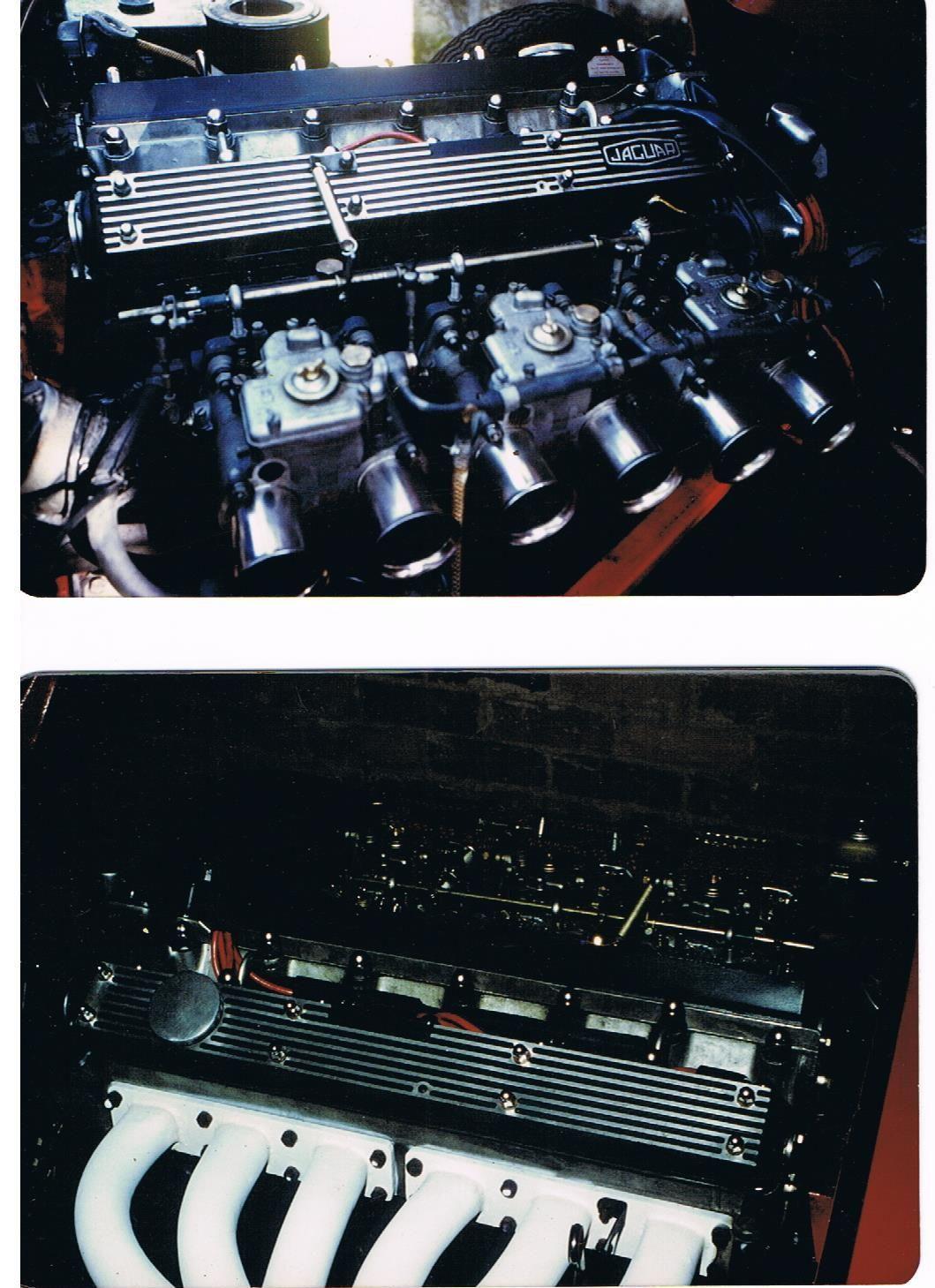

Despite searching Google and here I couldn't find much discussion/recommendation on spark plugs for a mildly built 4.2 with headers and 45 DCOE webers. Looking for high performance street application and to avoid plug fouling. Using a standard gold ignition coil.

Show us a picture - always ran N11Y in mine many years ago

Thank you. I have the NGK now, BP5 I believe. Heard good things about the NGK in general. Would they be right for a 300 hp motor I wonder?

Just want to say that is a pretty motor!
