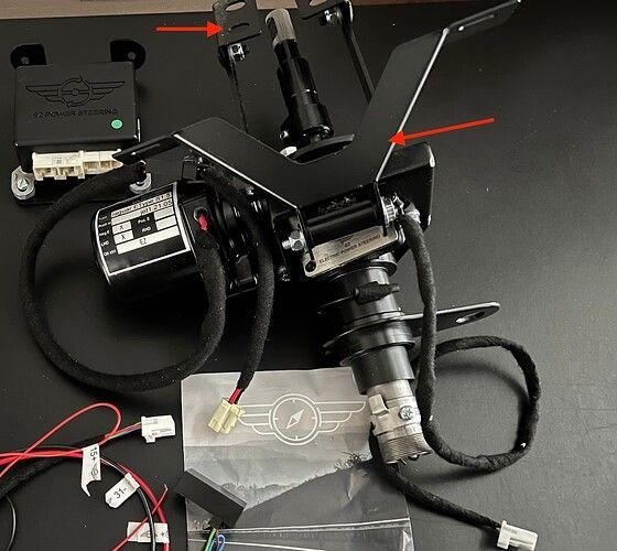

Despite my plan to start on this project today, last night around 6:30pm I couldn’t contain myself and I went out to the garage with the plan to just remove the steering wheel. An hour later, all of this was on my work bench
​​​​​​As I mentioned, I’ve had all this off before dealing with 1) a turn signal assembly that had its wiring hacked up by a PO since the horn didn’t work and the turn signal indicators were wired wrong (by him), 2) a stripped upper steering column section (the telescoping piece) from the PO who over tightened the steering wheel nut and then decided to hold the steering wheel in place with 1/2 a roll of teflon tape, 3) replacing the column bushing (nylon) that had worn out and needed replaced which with the cause of the wobbly steering wheel that the PO thought tightening the top nut was the answer.
Today the plan is to pull the thick red wire directly from the terminal under the bonnet that the battery + terminal connects to for the various components of the car that are directly wired. This red wire already has a 40 amp inline fuse attached, this goes directly to the EZ wiring harness. I will also attach the device that goes between the speedometer cable and the speedometer, that way the unit can detect the speed you are going to provide little or no steering assist. Also, I will be attaching the brackets that attached to the EZ unit self to the back of the instrument panel and its underside where the original column was attached. The two small brackets at the back of the unit go on the underside and the the larger of the three brackets mounts to the upper two captive nuts that held the original bracket (the large bracket in the upper photo that had four attachment points on the back of the dash). Finally, the plan is to find a location to mount the brains of the system (its ECU)…more on that to come.

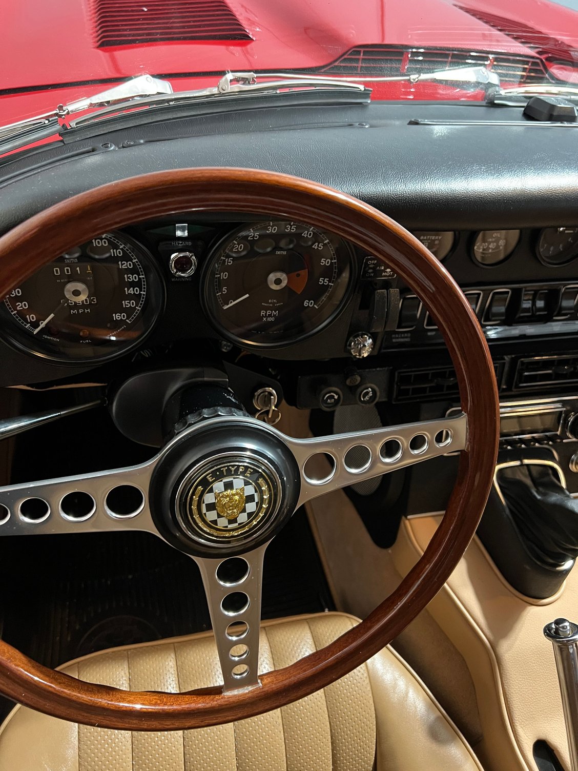

The EZ Power Steering unit installation in my Series 2 is now complete (or nearly so). I have bolted the unit in place, run all the necessary wiring (only three electrical contact (thick red wire to positive post from battery), ground wire, and a switched wire from fuse box), and I’ve dressed all the wiring. The final step was to fit the ECU. In my case, I chose to use industrial Velcro and cover the black plastic cover with it and attach it to the underside of the dash. It is totally out of the way and will be completely covered when I fabricate the under dash cover I’m creating (ditching the cardboard pieces).
Here are some finished pics.
​​​​​​From the topside, it is completely unnoticeable that anything has changed, except when you turn the car on and realize that the steering wheel will turn at rest with no effort whatsoever. It is a joy to back out of the garage and make all the slow hard turns necessary to navigate out of the garage, my property, any my street. What an amazing difference!
