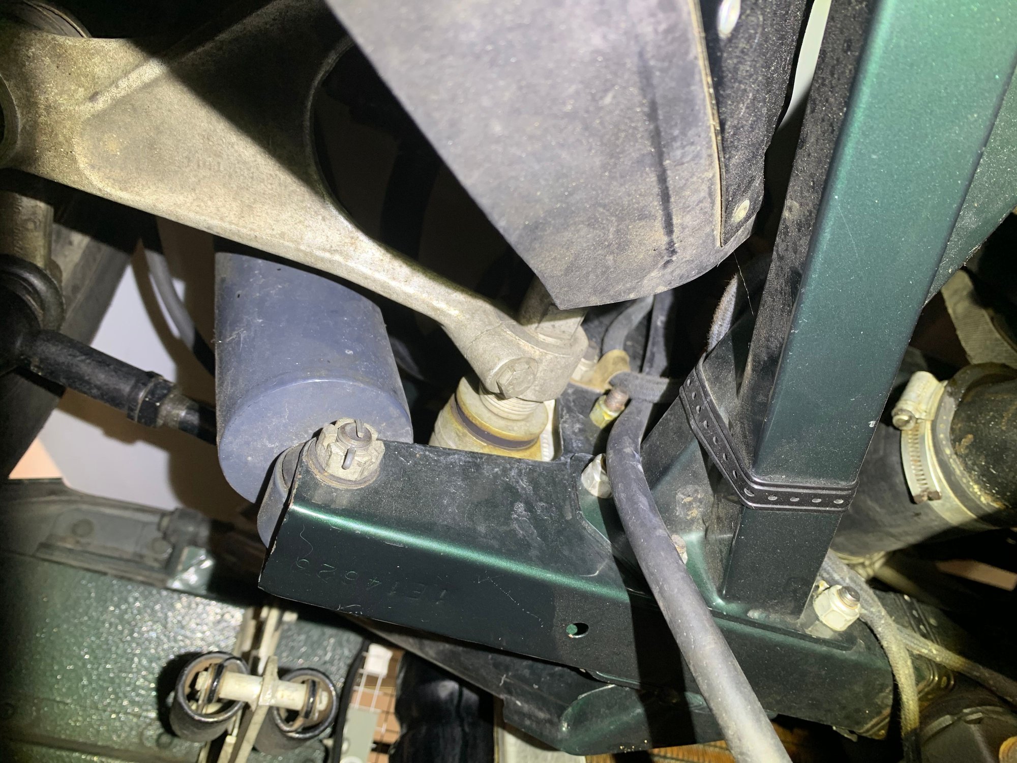

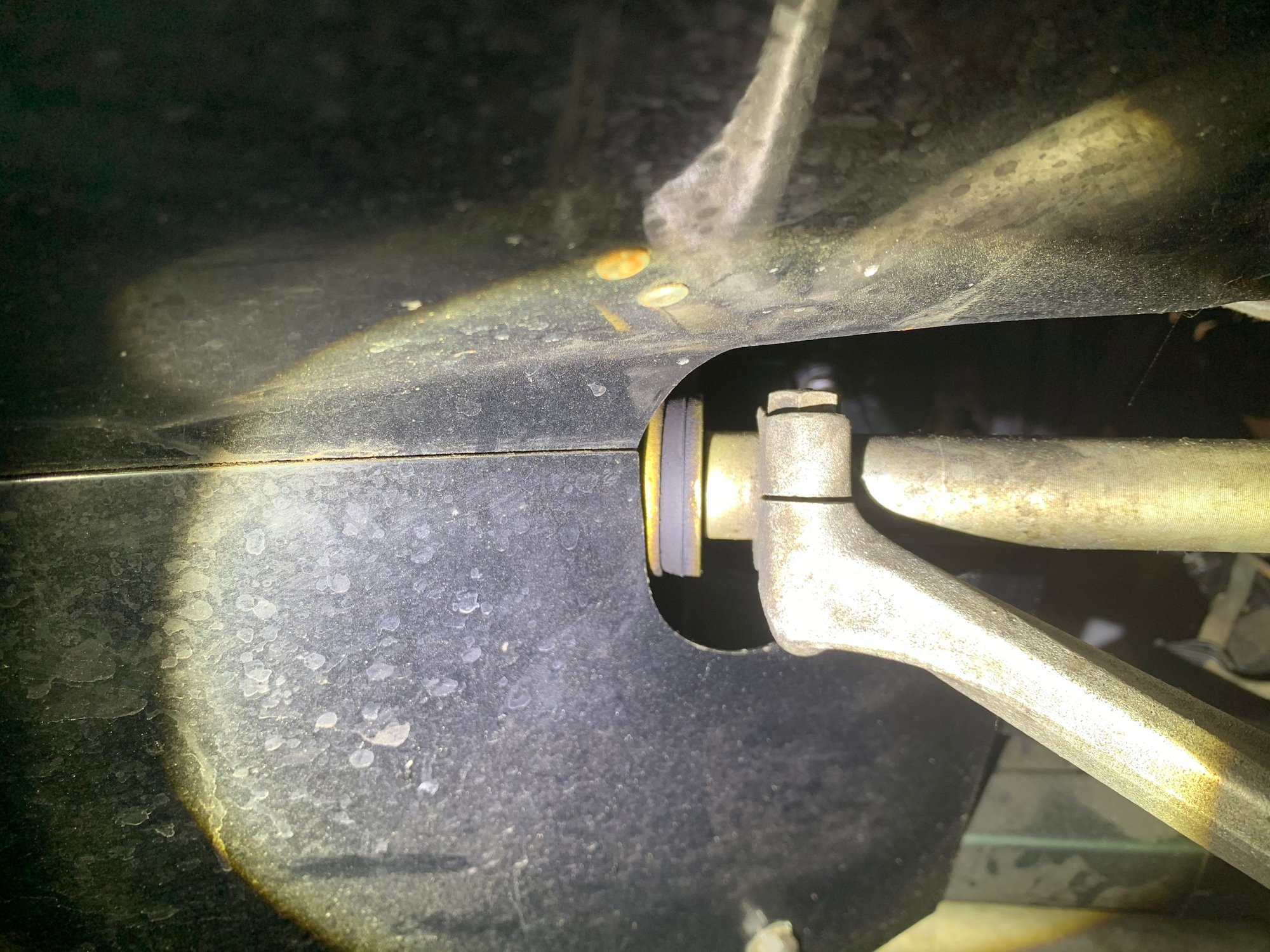

Thanks for all the info gents. So generous of you all to help. So I took a couple of suspension A arm photos. I believe they have stock style rubber bushings. I think the squeak is coming from the rear one, but not 100% sure. If I need to replace them, is it a reasonable job? Early 911s are a PITA. what bushings do you guys like?

Sorry, that first pic is upside down.

The bushes seem to be purple in colour which would tell you they are Powerflex. Could you give them a quick wipe and rephoto ?

Fraser, I wiped off one of the bushings and it is definitely black rubber.
Powerflex use various colours to denote the hardness of the material. The only real way to see if it is Powerflex is to dismantle the bush. Powerflex bushes use a stainless steel centre that rotates in the plastic hence why you have to grease them on installing and at regular intervals afterwards, I think it's 5 yearly.
This is what SNG Barratt are selling: -
https://www.sngbarratt.com/English/#...c-93863768c675
You'll note the originals are NLA and there is an aftermarket repro, but not in stock. I suspect most people just fit the polybush item.

Hi t6dpilot,
If you decide to replace the upper A arm bushings, it is not a difficult job. As Alan mentioned, the workshop manual is a must have.....it has very good detail on the suspension work. Be careful to note the position & number of shims under the bushing mounts as they control the caster angle. Since you will have to separate the upper ball joint in the process, it is a good time to inspect it carefully and replace if needed. I used the poly bushings from one of the usual suppliers when I rebuilt my suspension and have been pleased with the results....no squeaks so far! As others have mentioned they will last considerably longer than the rubber ones.
At 20 years since the restoration, I suspect the lower bushings may also be in need of replacement. That job is a little more invasive because the torsion bars have to be disconnected to remove the lower wishbones. Removal is not difficult but replacement can be tedious because the ride height is controlled by the torsion bars. In my experience it can take a couple tries to achieve recommended ride height on both sides.....even with the setting tool mentioned in the manual.
