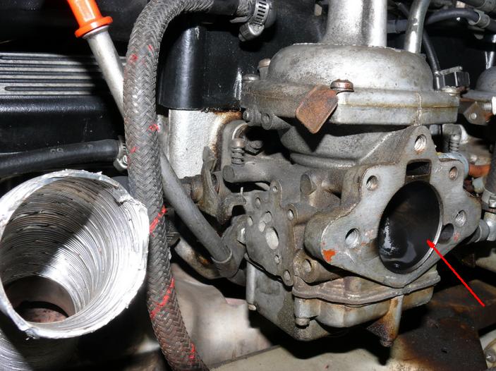

In my opinion you should opt for the full rebuild, as there are components that should be serviced as a matter of course, not included in the basic service kit.
In Australia, the rebuild kit for all four carburetors (CDRK1) retails for AUD480.00. The ultimate price will then depend if you do the work yourself (not difficult - just tedious). Obviously the carburetors have to be removed. They can be removed leaving the manifolds in place, but there will be a lot of swearing and dropping of the nuts when replacing the carbs. The easier method is to remove with the manifolds, and then further dismantle on the bench. You should replace the gaskets between manifolds and heads if you go this route.
After replacing, the carburetors will need to be synchronized and air/fuel ratio set, so as not to be too lean or rich.
A decent operator should be able to complete the job is a longish day. Attached are pictures of carburetors before and after rebuilding.
