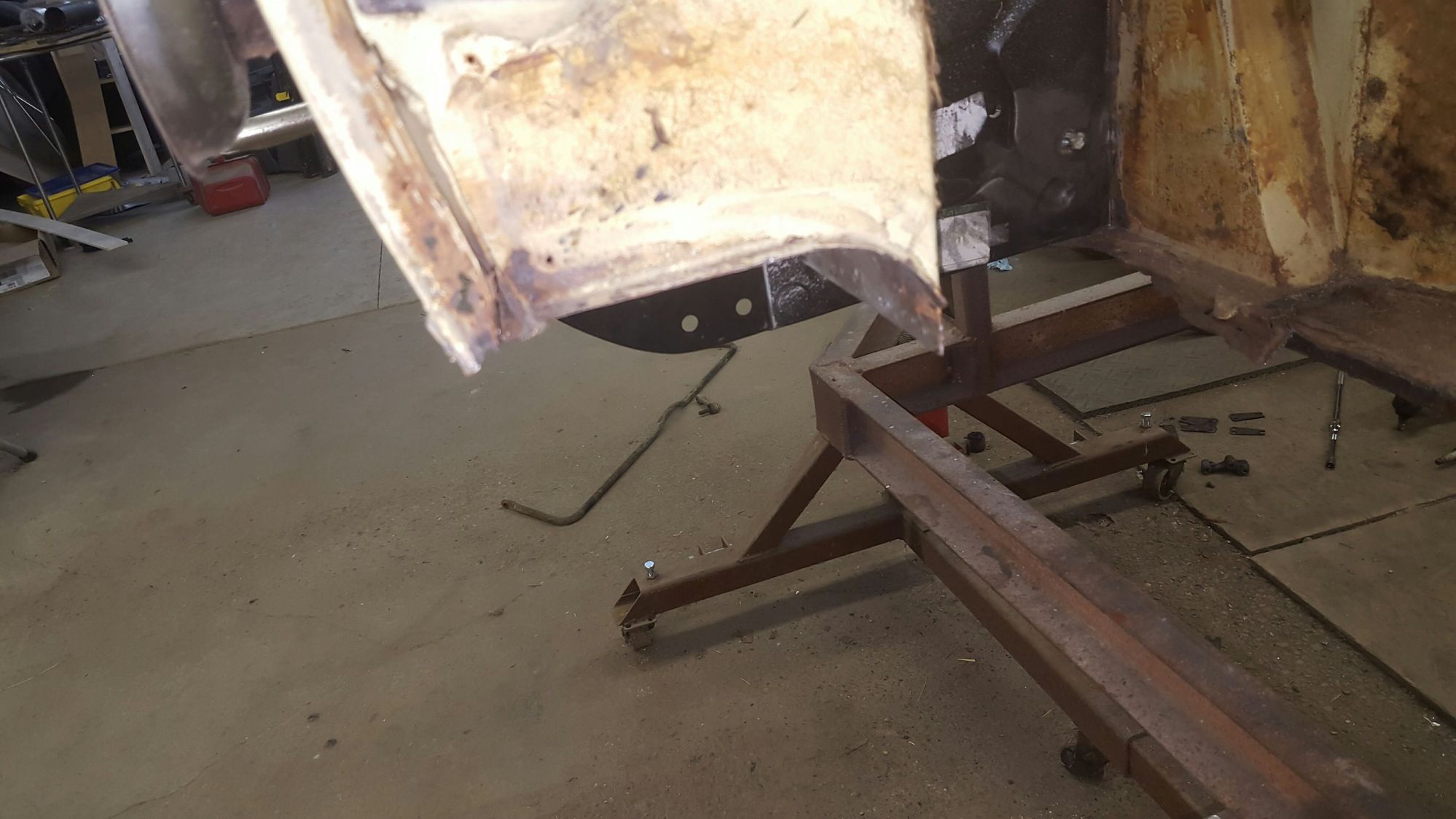

https://cimg4.ibsrv.net/gimg/www.jag...e709effcd3.jpg

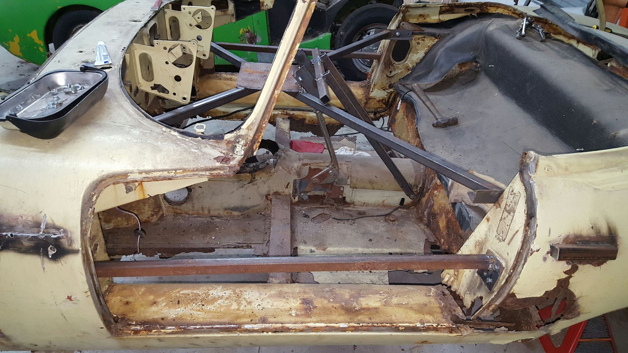

Built bracing off of my 62 FHC, so points should be bead on
https://cimg5.ibsrv.net/gimg/www.jag...4bc4421f98.jpg
https://cimg6.ibsrv.net/gimg/www.jag...483405baa6.jpg
https://cimg7.ibsrv.net/gimg/www.jag...99132d6336.jpg
The double arm brace goes seatbolt points on tyunnel: will stablize floor

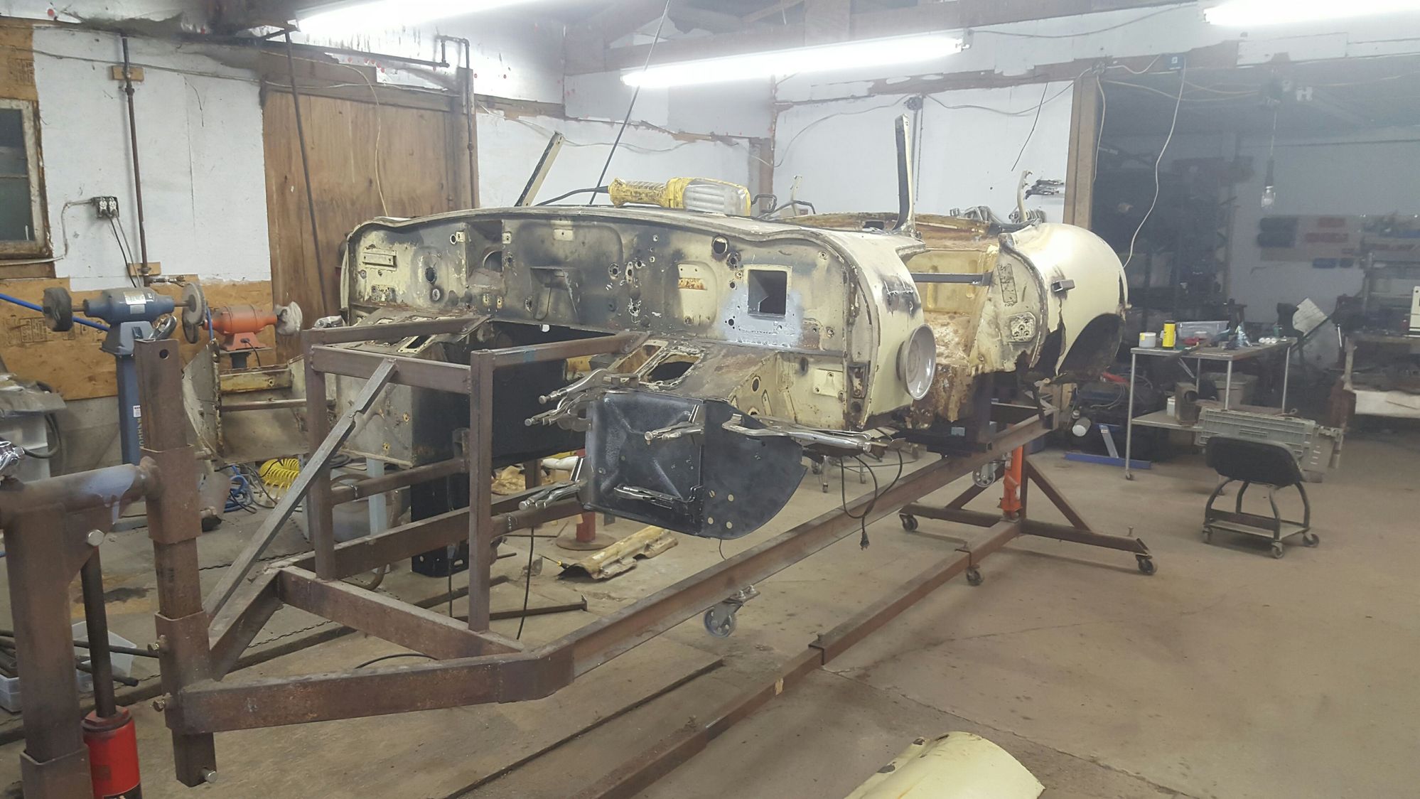

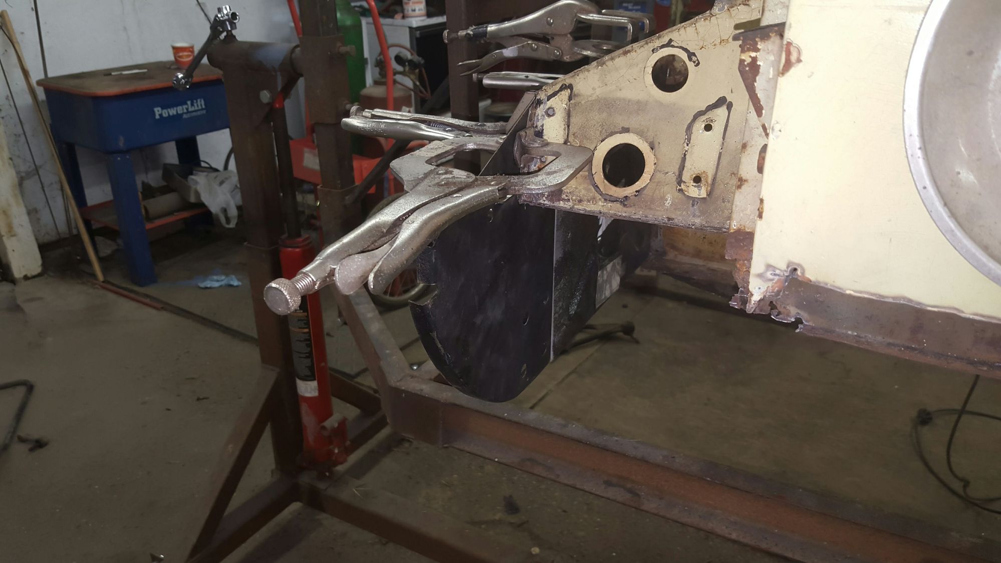

https://cimg8.ibsrv.net/gimg/www.jag...b5b3d117df.jpg

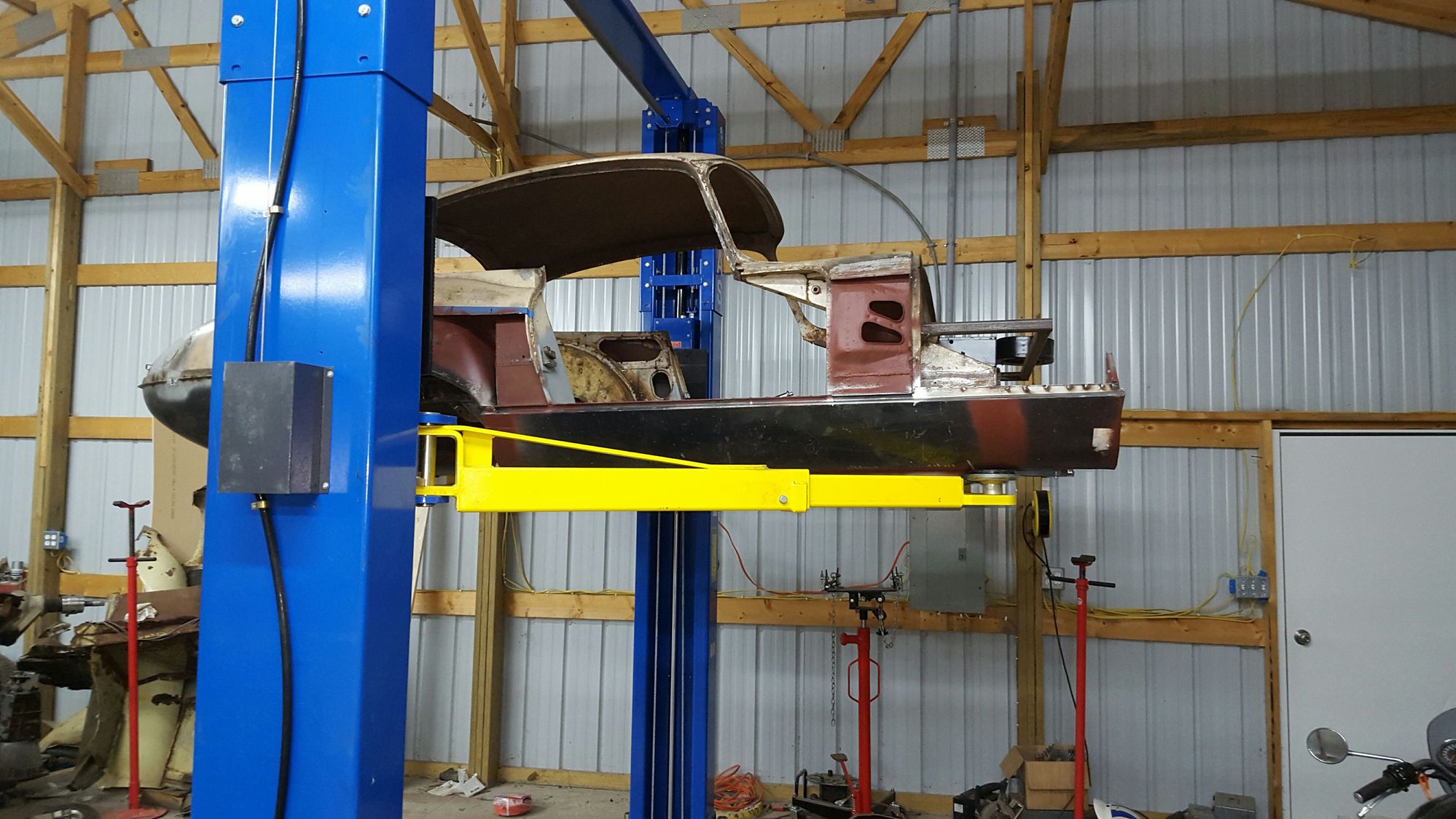

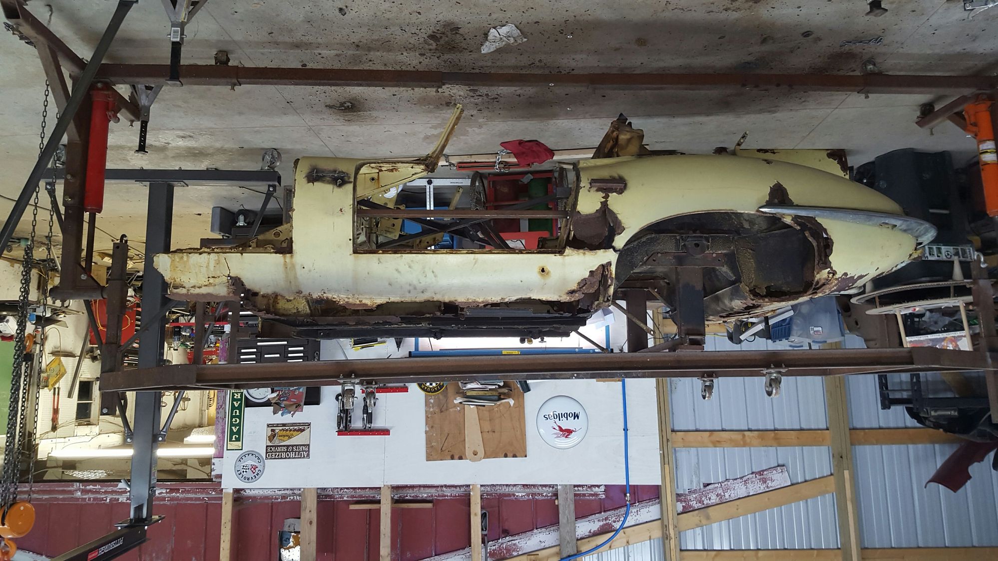

FHC off of the jig and ready for next rotisserie
https://cimg0.ibsrv.net/gimg/www.jag...b79b6cbe56.jpg
OTS picture flipped, is actually hanging from jig. <br/>Bolted right to points-
https://cimg1.ibsrv.net/gimg/www.jag...1245f19944.jpg
Another view of FHC on lift

Finished second rotisserie for my FHC e-type and mounted the OTS on the jig (IRS mounts and frame rail mounts lined up great. Starting to remove rusted panels and first big one will be the rear bulkhead. Will post some pics soon!!

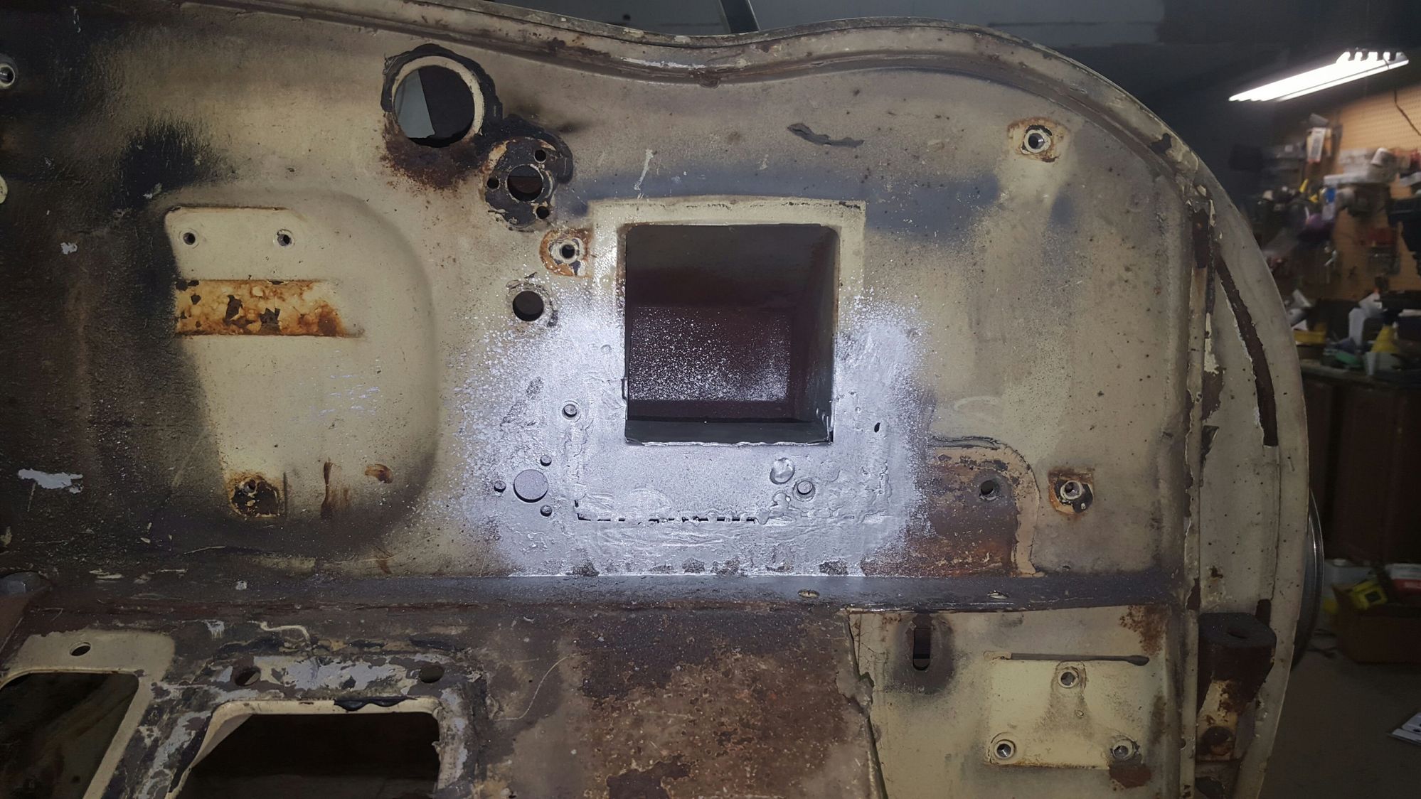

https://cimg9.ibsrv.net/gimg/www.jag...b140ccf488.jpg

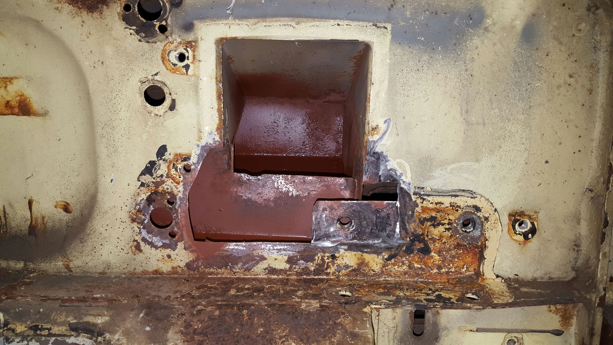

Dag nab rust area between scuttle and heater box cut out
https://cimg2.ibsrv.net/gimg/www.jag...8b9926afaf.jpg

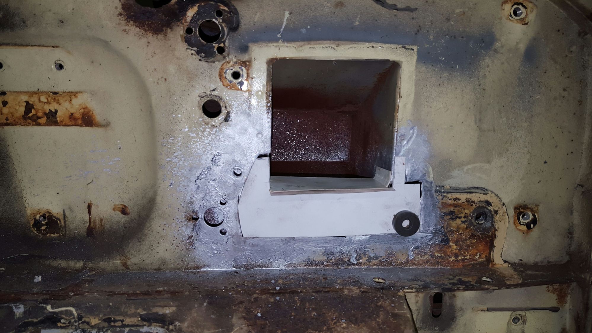

Fabricate patch panels
https://cimg3.ibsrv.net/gimg/www.jag...575cf9feea.jpg
almost there, stitch welding in place and will smooth after a little more welding

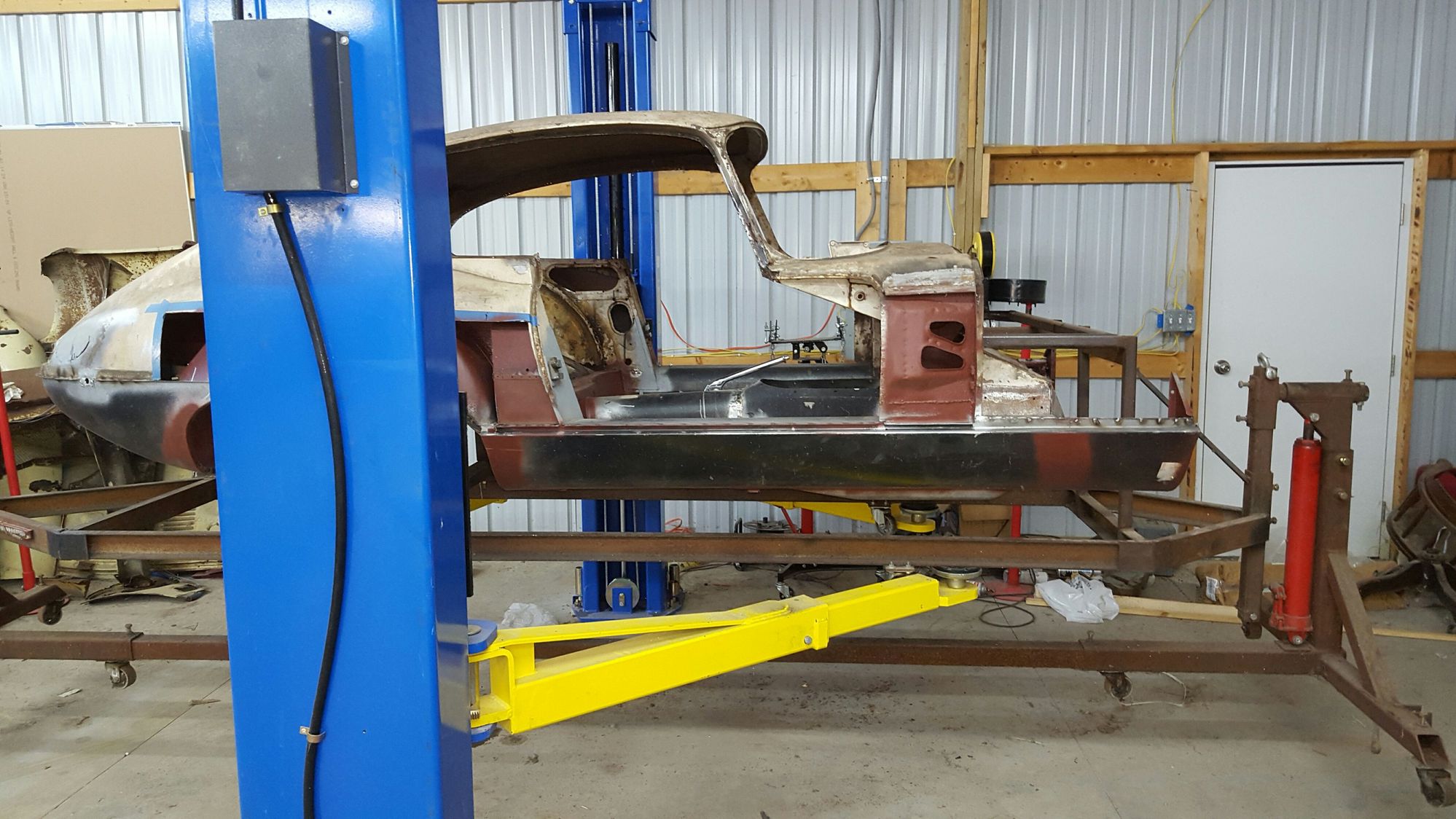

https://cimg7.ibsrv.net/gimg/www.jag...11c15e17dd.jpg
on the jig

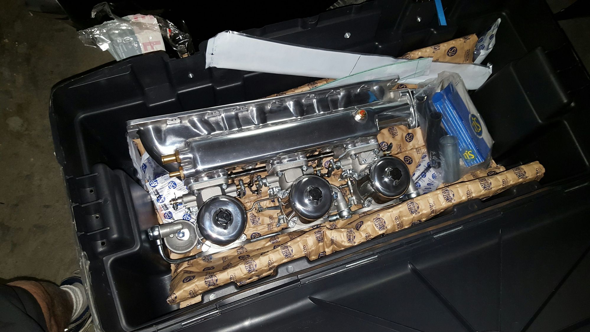

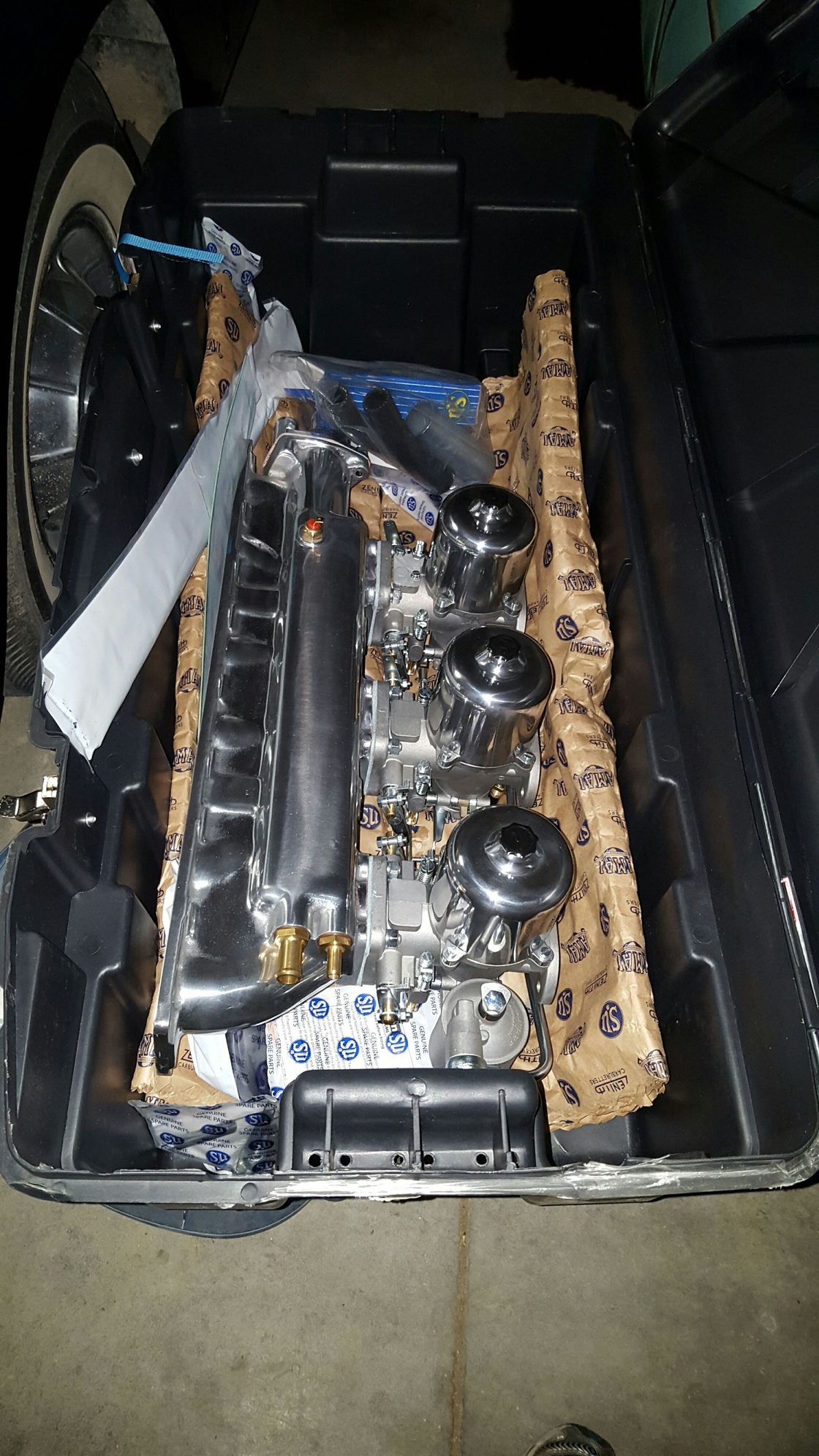

https://cimg6.ibsrv.net/gimg/www.jag...bf25af9ece.jpg
https://cimg8.ibsrv.net/gimg/www.jag...163dc78769.jpg
look what Santa brought!!
Jagrick Dec 29, 2015 01:39 PM
Panels are on there way so hopefully make some head way this week. Have one sill fitted and will tack in awaiting rear panel. Concern over my motor however, builder says may be un repairable :( if that is the case will keep block and head for sentiment and search for another 4.2 engine.

Originally Posted by Jagrick (Post 1361516)
wow how much did that cost?
Jagrick Jan 1, 2016 01:28 PM
got an sale. complete $3900
1970WillowGreen Jan 1, 2016 01:48 PM
Damn. Hella money. Its nice. I think we'll stick with the stock setup
RedRider48 Jan 1, 2016 05:06 PM
Nice score. The best improvement I made to my engine's performance was to swap the standard needles in the SUs to UEs. Oh, how the engine did respond!
