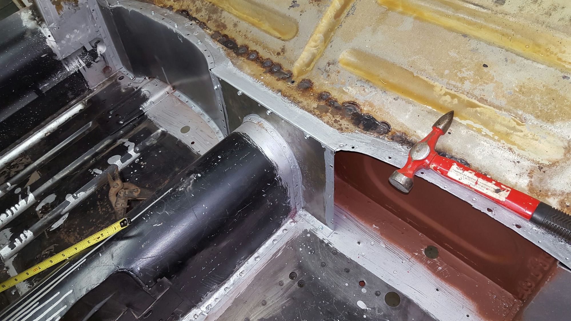

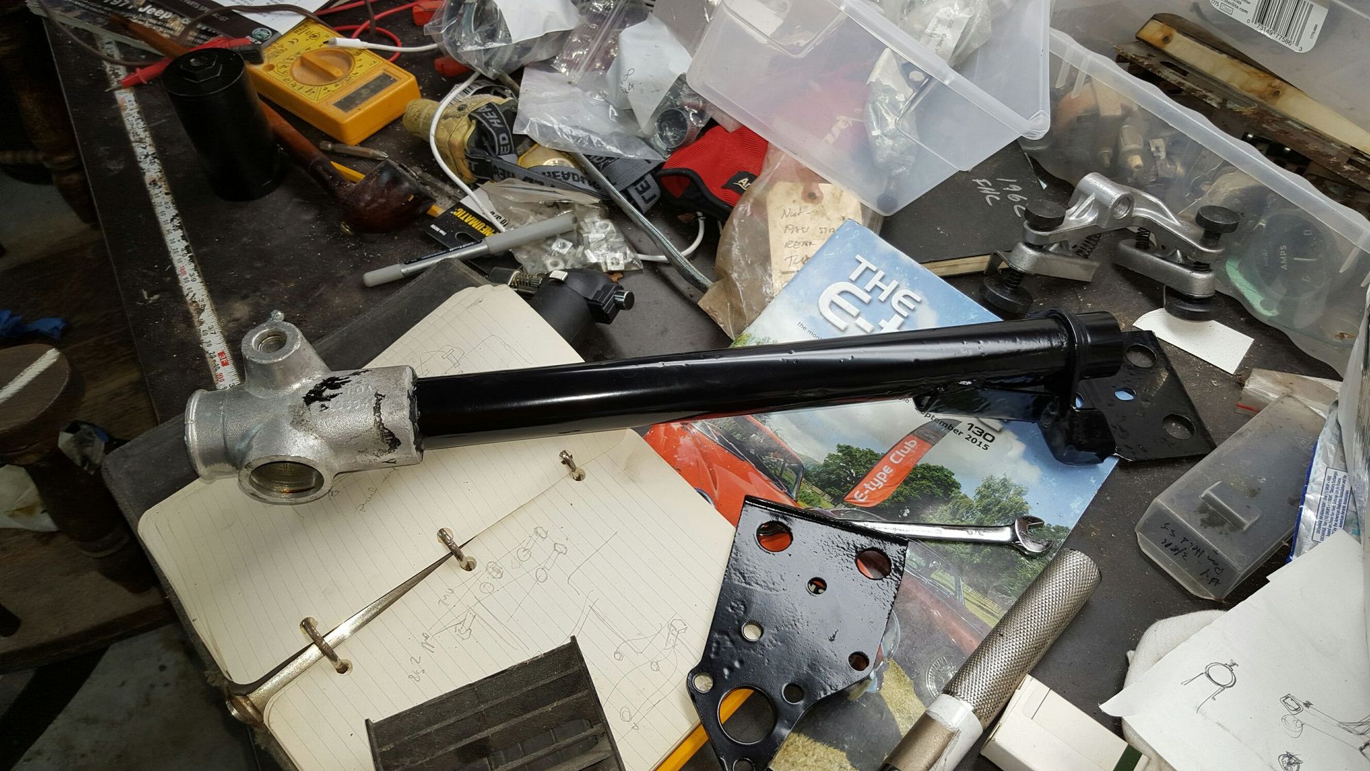

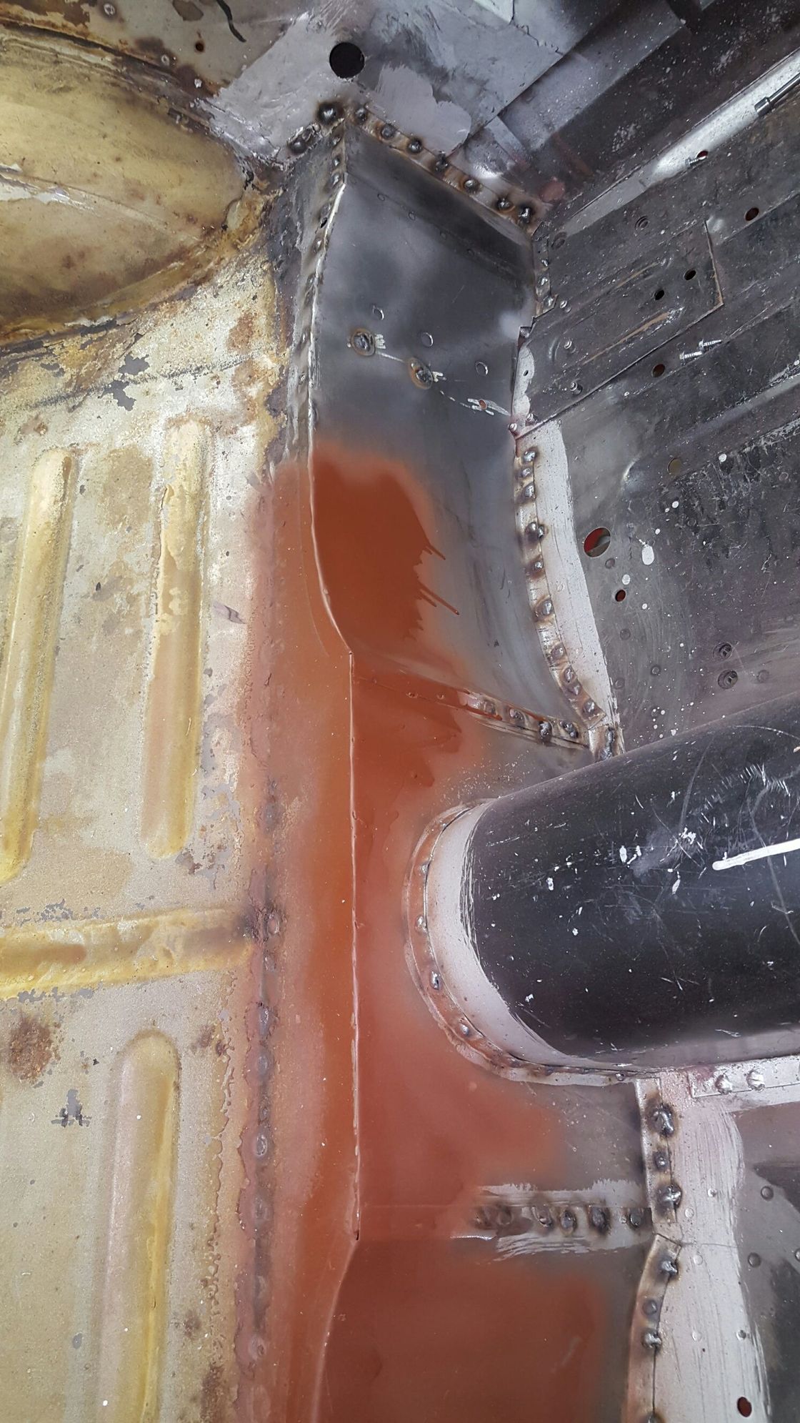

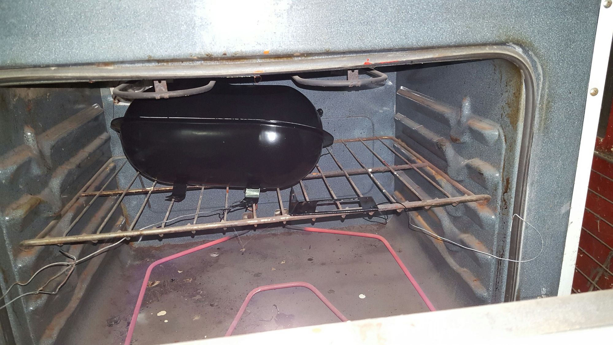

Painted the vaccum tank and will use in house stencil on it. Lots of fitting but finally got inner rear bulkhead welded in now a lot of finishing to do.
https://cimg2.ibsrv.net/gimg/www.jag...327b8629b4.jpg
Hmmm, smells good almost done!!
https://cimg3.ibsrv.net/gimg/www.jag...2852fe135c.jpg
A few rust depressions I couldn't get out, but good integrity and ready to rebuild the rack
https://cimg4.ibsrv.net/gimg/www.jag...ba77d8b8b0.jpg
https://cimg6.ibsrv.net/gimg/www.jag...4788e4cea3.jpg
Its in to stay now

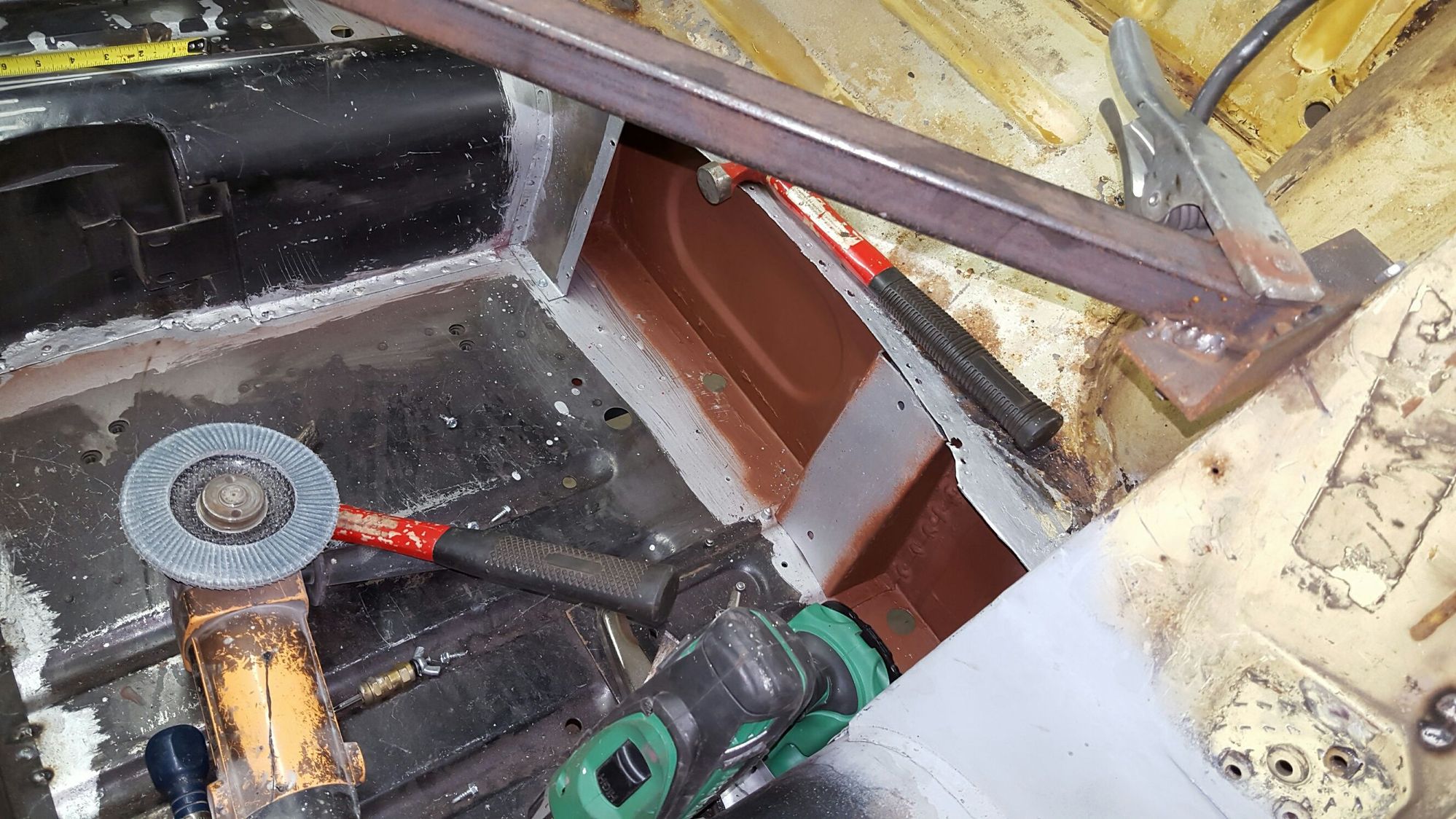

Trial fitting the bulkhead
https://cimg1.ibsrv.net/gimg/www.jag...60186fe1ae.jpg
Fitting the brace

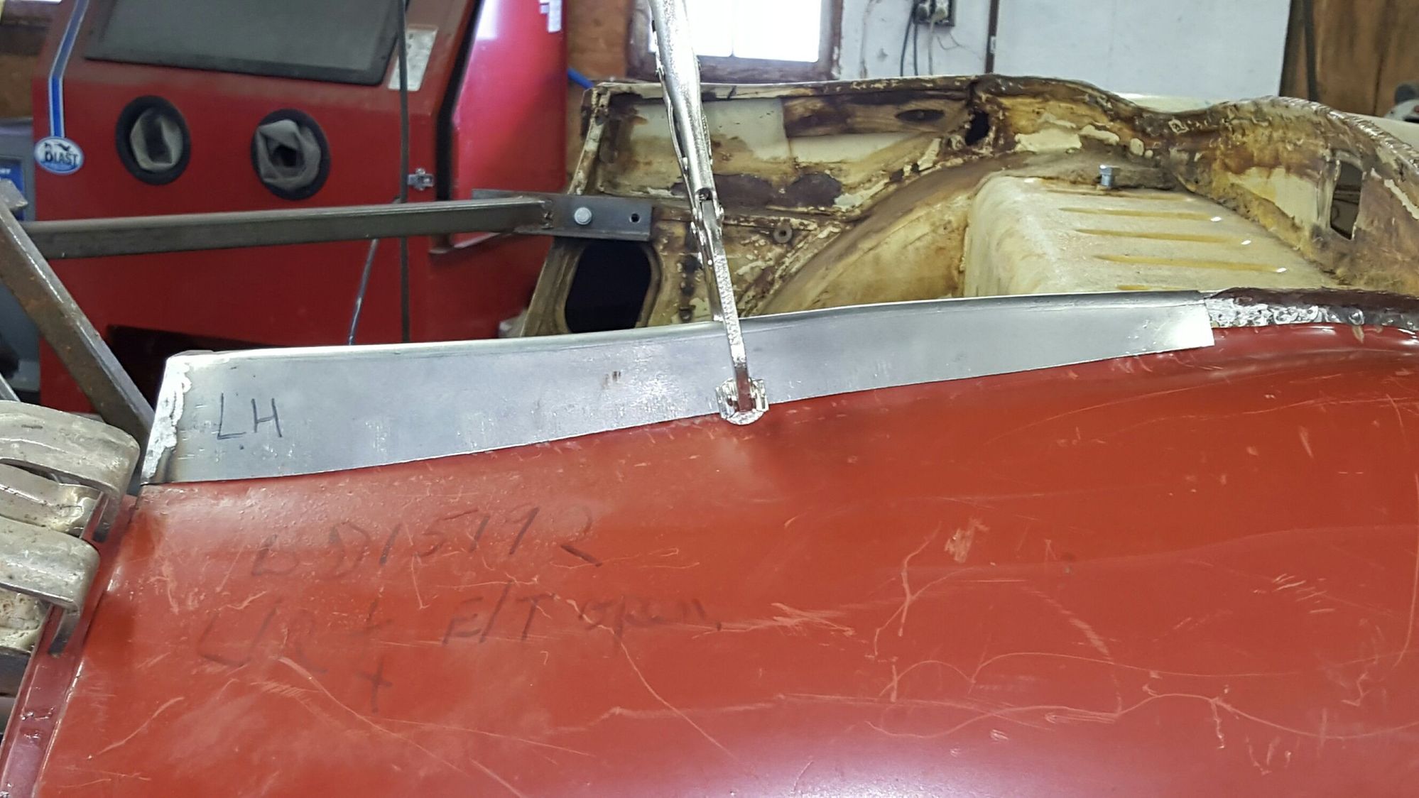

Jagrick May 14, 2016 09:32 AM
https://cimg0.ibsrv.net/gimg/www.jag...9ebd694bc0.jpg
Another monocoque metalworks piece (upper quarter cP), needed to add a little touch to custom fit but as always a good panel

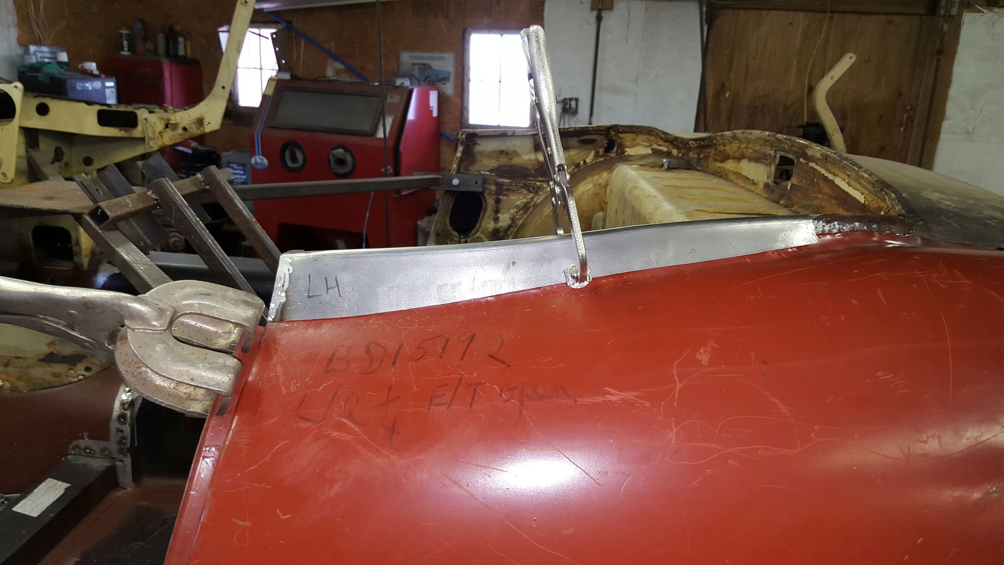

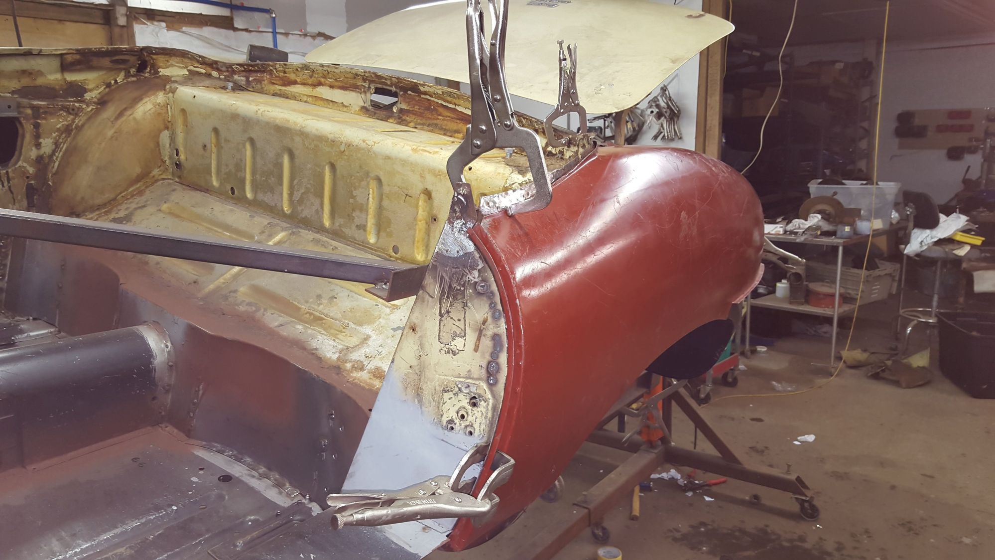

Jagrick May 15, 2016 09:04 AM
Contemporary replacement panels have us spoiled. Have had to use the English wheel on several areas of the wing to accentuate curves in some areas and decrease in others. I feel that each of these cars on the assembly line went through similar handling.

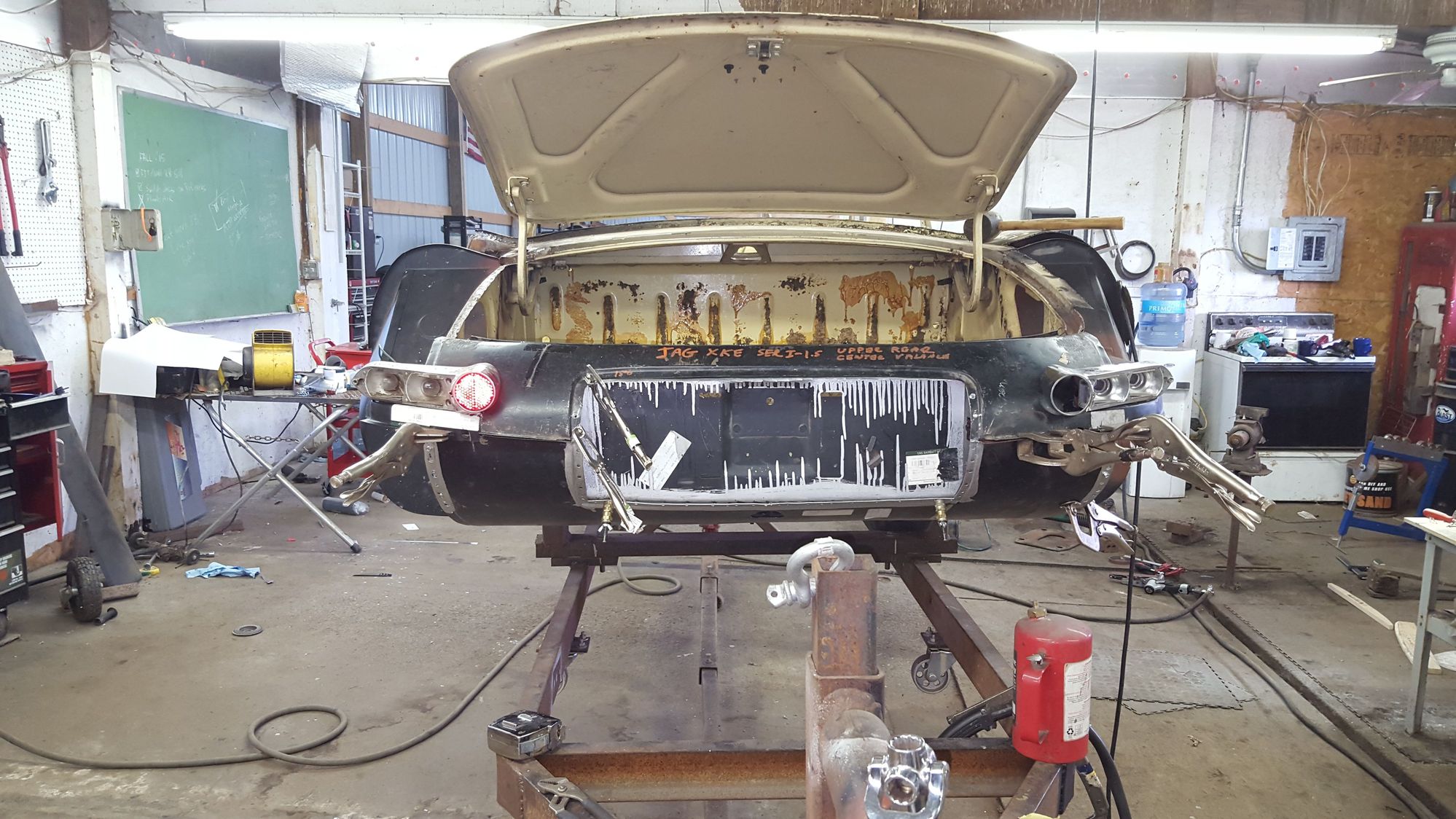

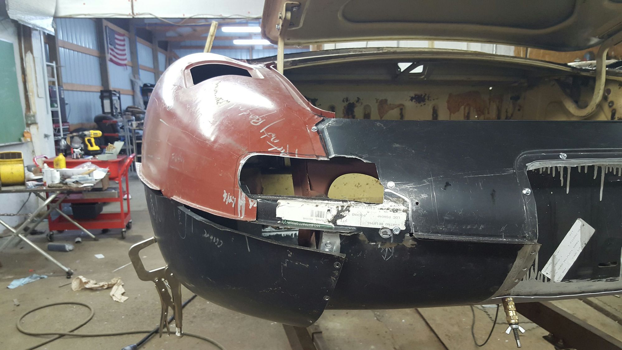

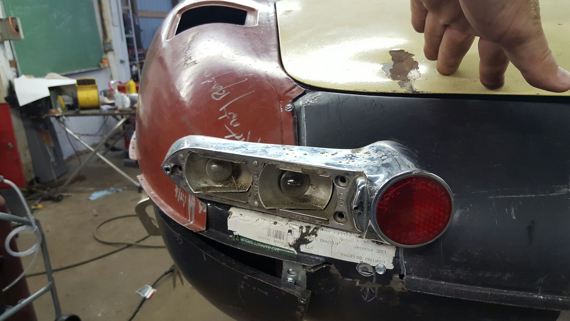

Jagrick Jul 14, 2016 11:06 AM

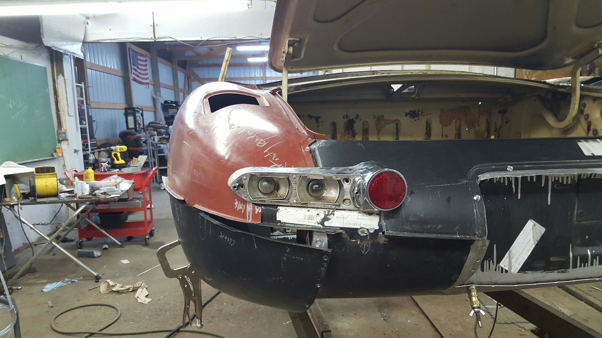

This is probably one of the more critical aspects of rear wing replacement...the taillight postioning
https://cimg6.ibsrv.net/gimg/www.jag...48f4c9eb9b.jpg
Wing clamped to start final fitting
https://cimg8.ibsrv.net/gimg/www.jag...af1df6f190.jpg
Template for roughing in taillight openings
https://cimg9.ibsrv.net/gimg/www.jag...d758c4e606.jpg
https://cimg0.ibsrv.net/gimg/www.jag...9a8916aeb1.jpg

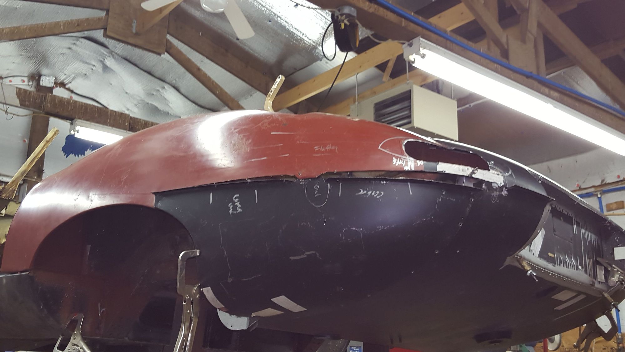

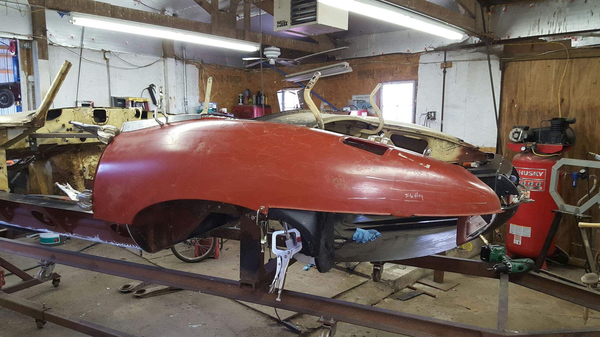

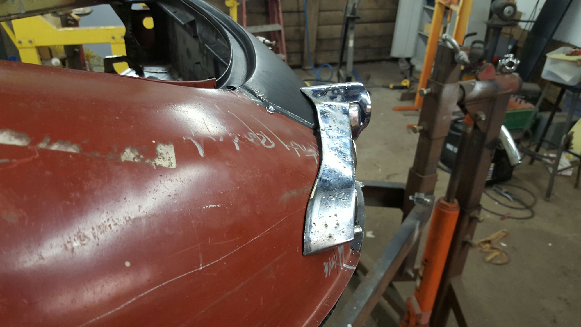

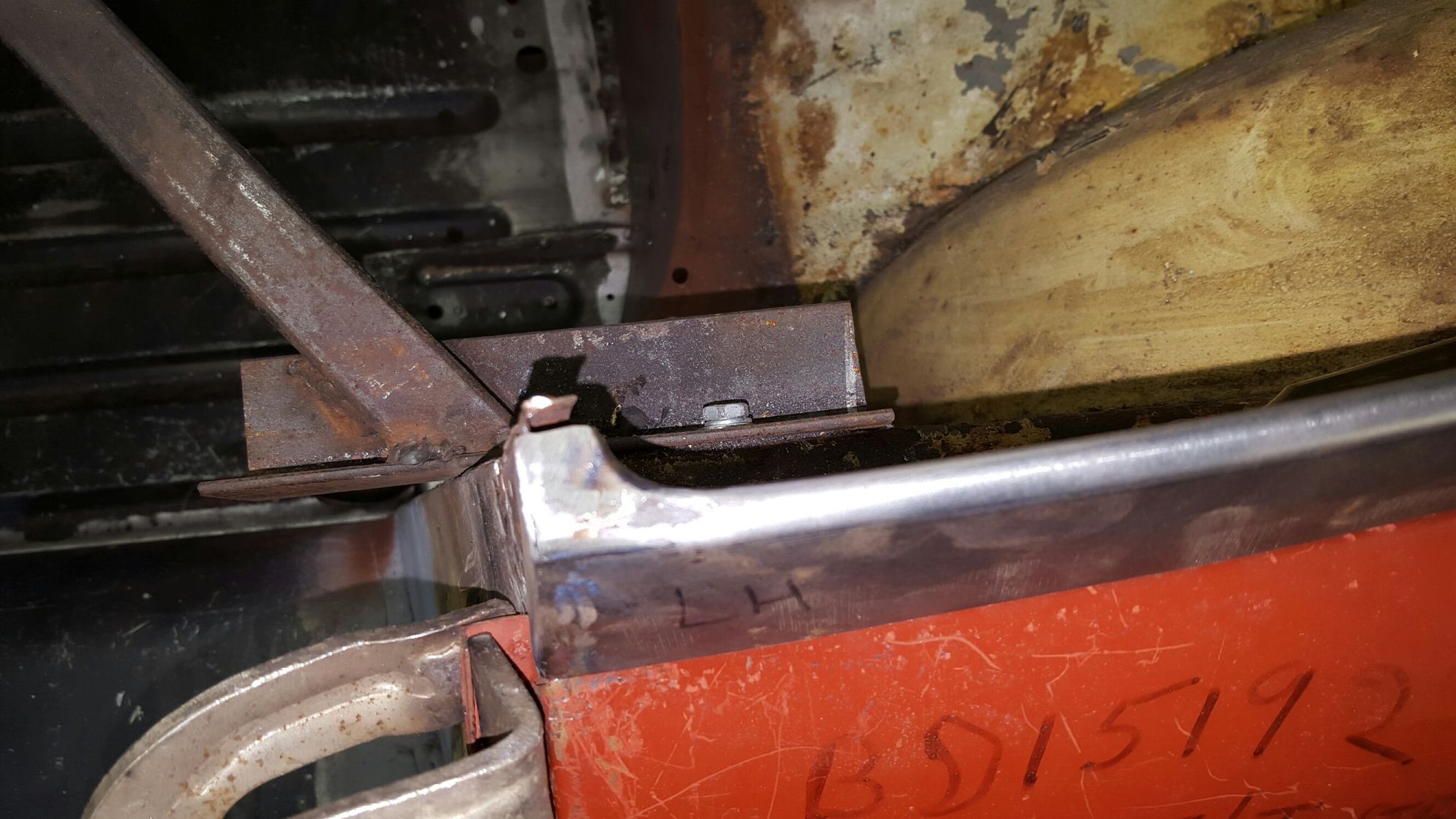

Jagrick Sep 16, 2016 02:54 PM
https://cimg2.ibsrv.net/gimg/www.jag...9936240bf2.jpg
haven't fitted mounting tabs yet-will do once weld in fender
https://cimg7.ibsrv.net/gimg/www.jag...891246a1ef.jpg
Trial fit
https://cimg0.ibsrv.net/gimg/www.jag...33d186c2ab.jpg
From above, looks right as Jaguar put a lot of lead in this joint as will I
https://cimg2.ibsrv.net/gimg/www.jag...7bfc8b4ac6.jpg
Happy with fit

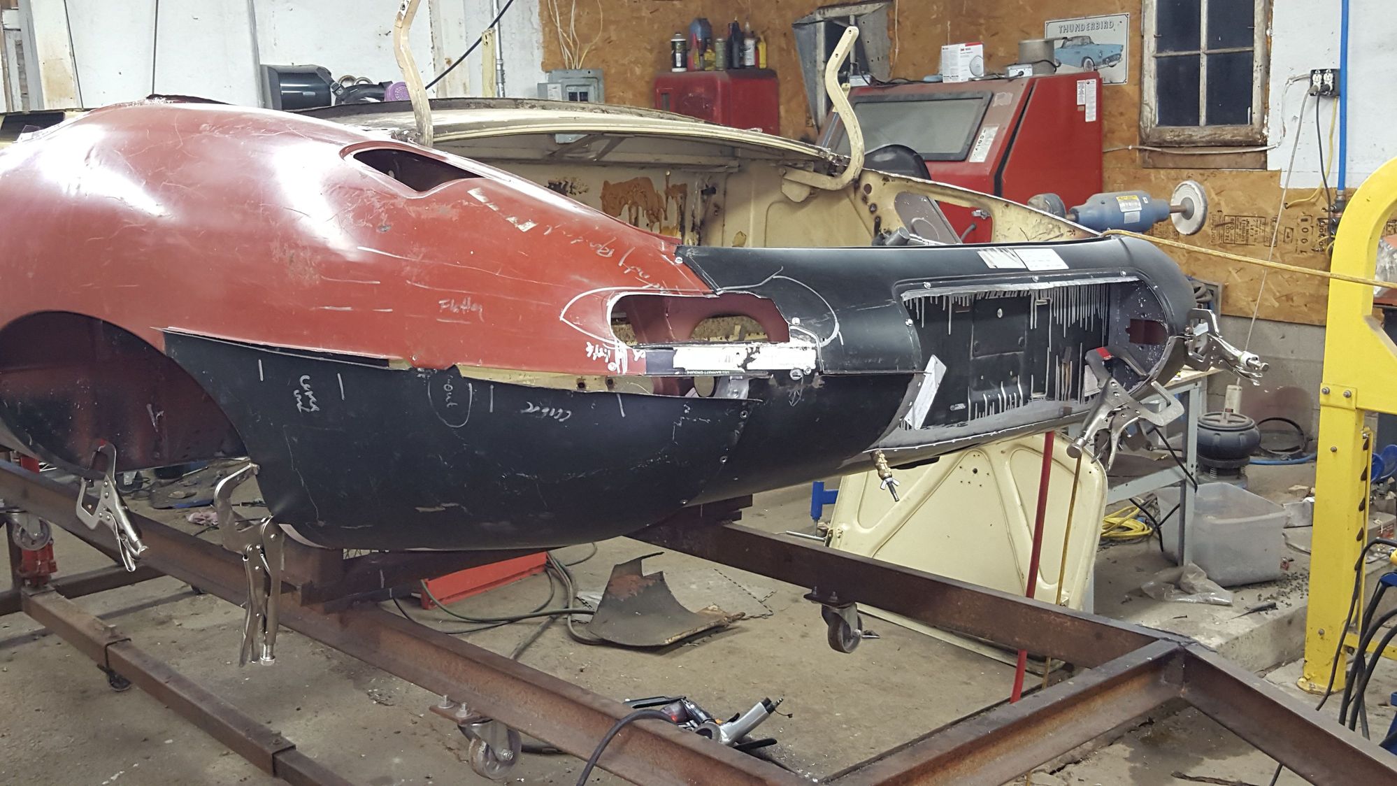

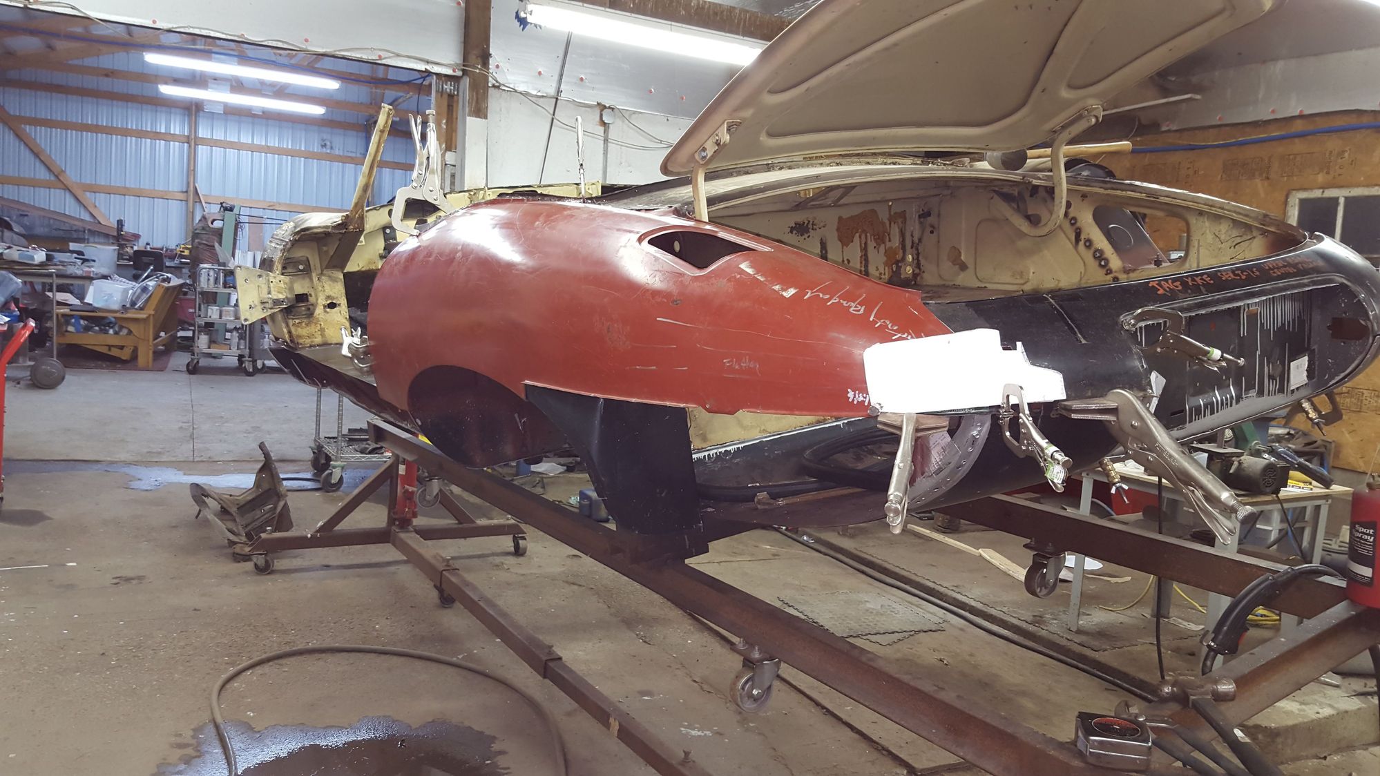

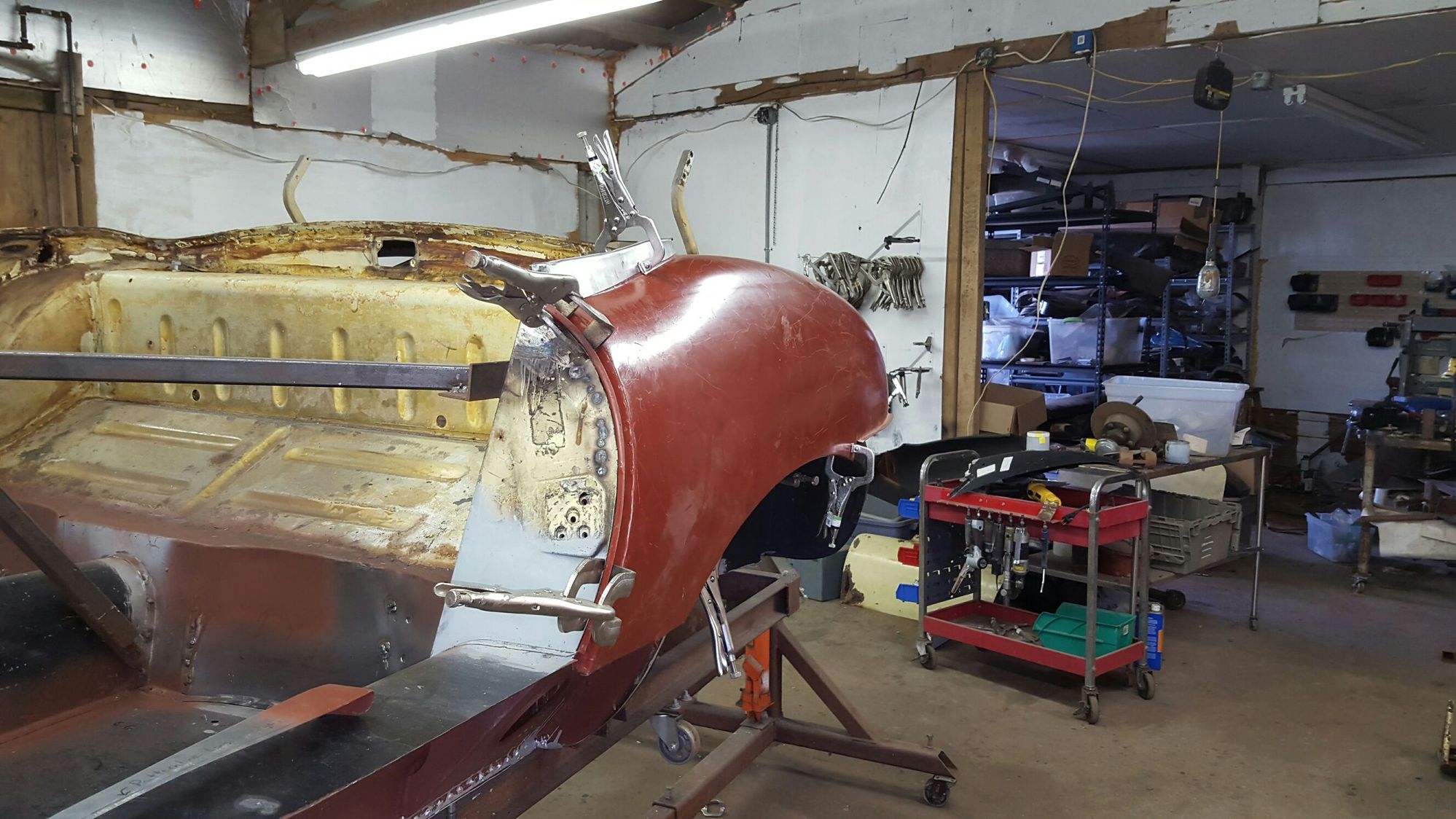

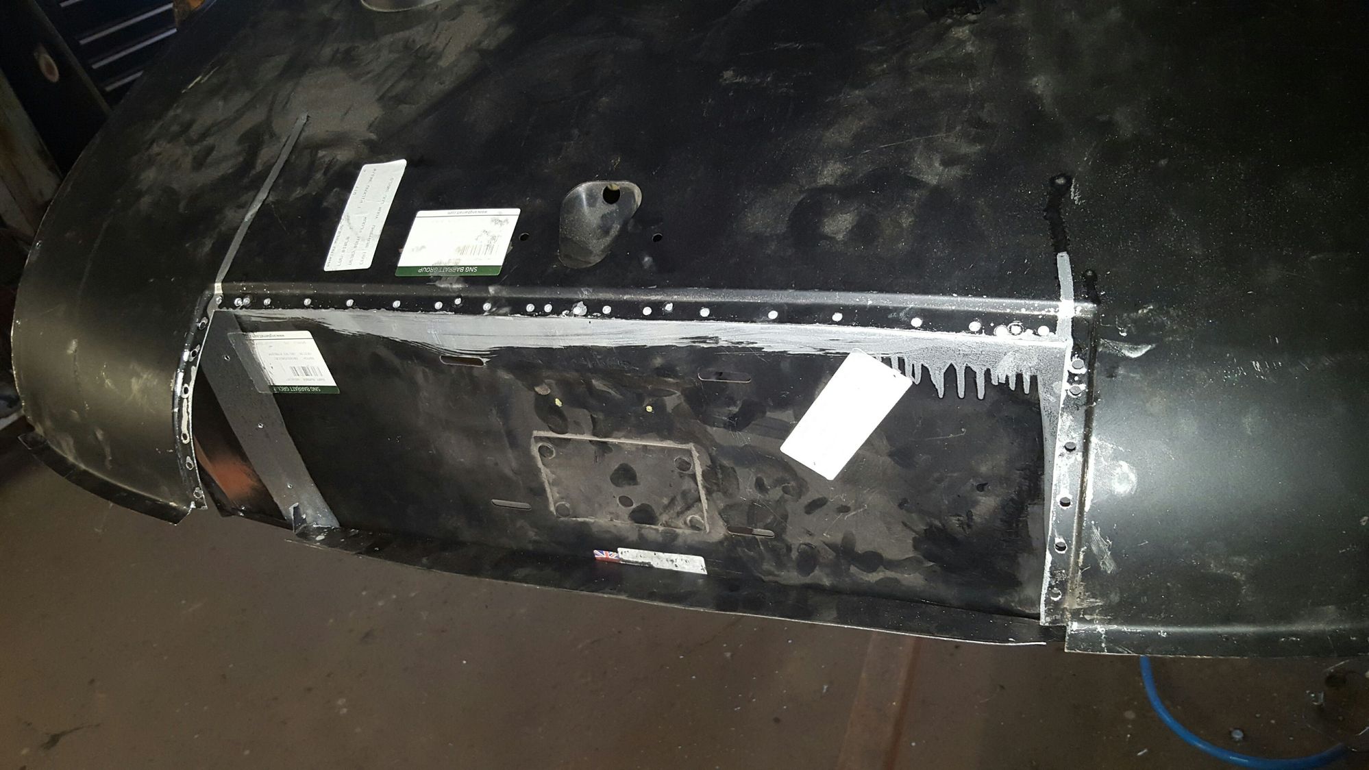

Jagrick Sep 26, 2016 01:58 PM
https://cimg7.ibsrv.net/gimg/www.jag...9176abdda9.jpg
https://cimg0.ibsrv.net/gimg/www.jag...f4c7f39dd7.jpg
Trial fit of new wing and sill. Doors finally got here so can do fitting and get ready to weld!!
https://cimg1.ibsrv.net/gimg/www.jag...8fd513d9dc.jpg
All the pieces are coming together on LR
https://cimg2.ibsrv.net/gimg/www.jag...bcb71c2163.jpg
From below, getting it dialed in pretty well--right side next

Jagrick Sep 28, 2016 07:21 AM
Thanks, definitely takes longer as a one man shop, and a lot of the panels need massaged to get them to work so can only do 1 side at a time to preserve symmetry and compare. The FHC I am doing I had to build the jig before anything and that took a while. Finally got the doors in and can start the final fitment before welding (always nerve wracking to afix permanently!! Hope to get out in shop more this fall
