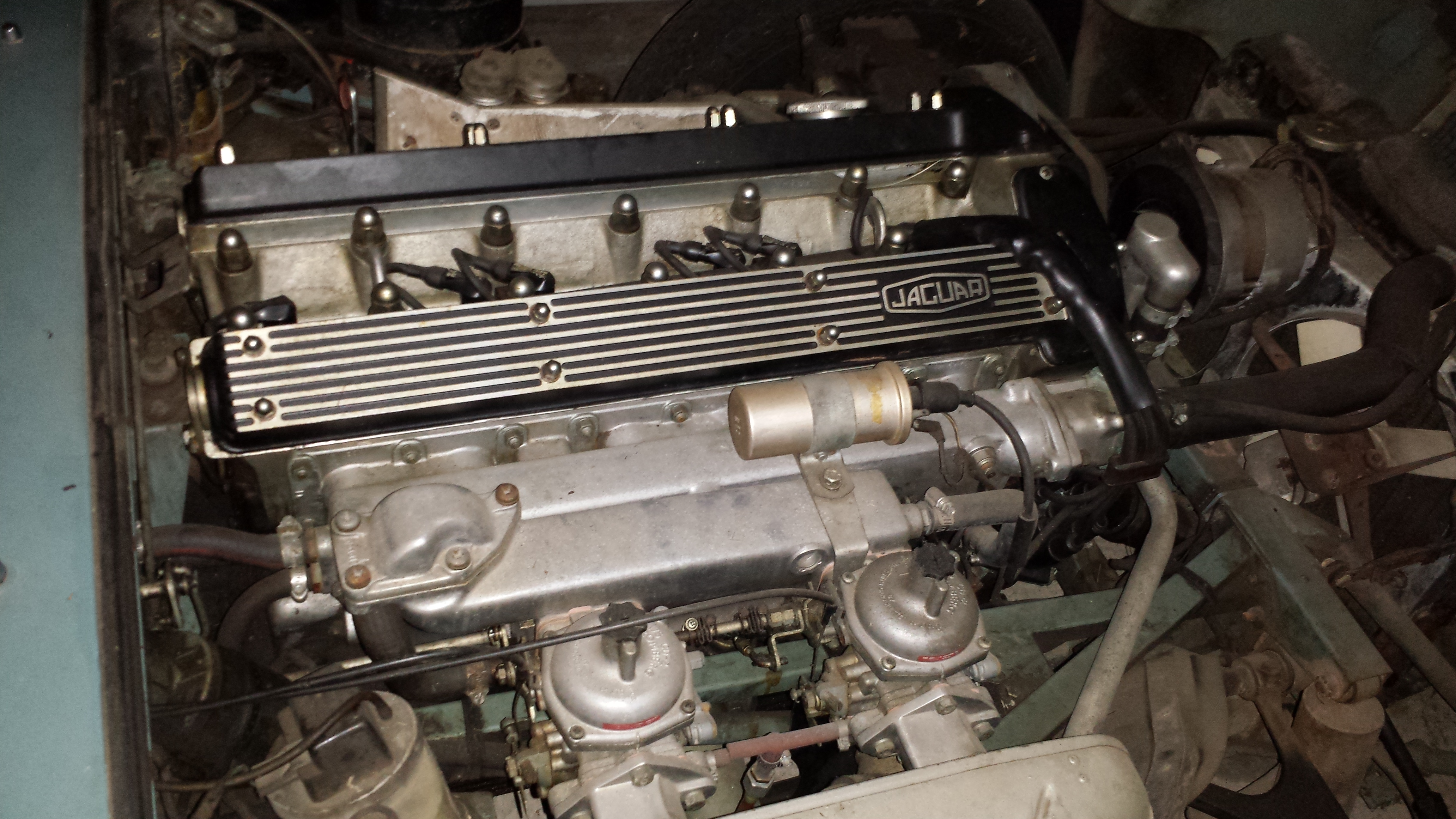

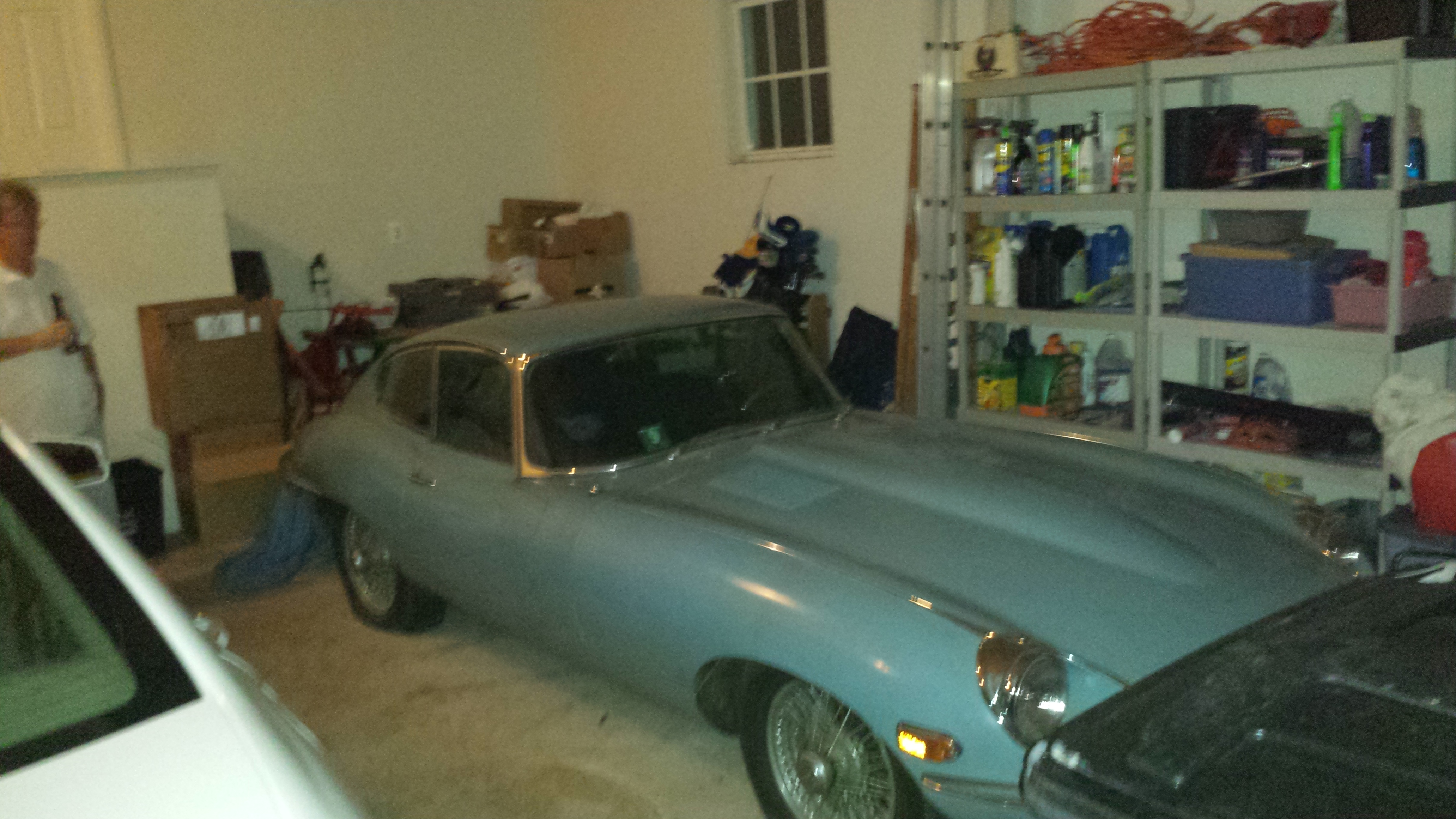

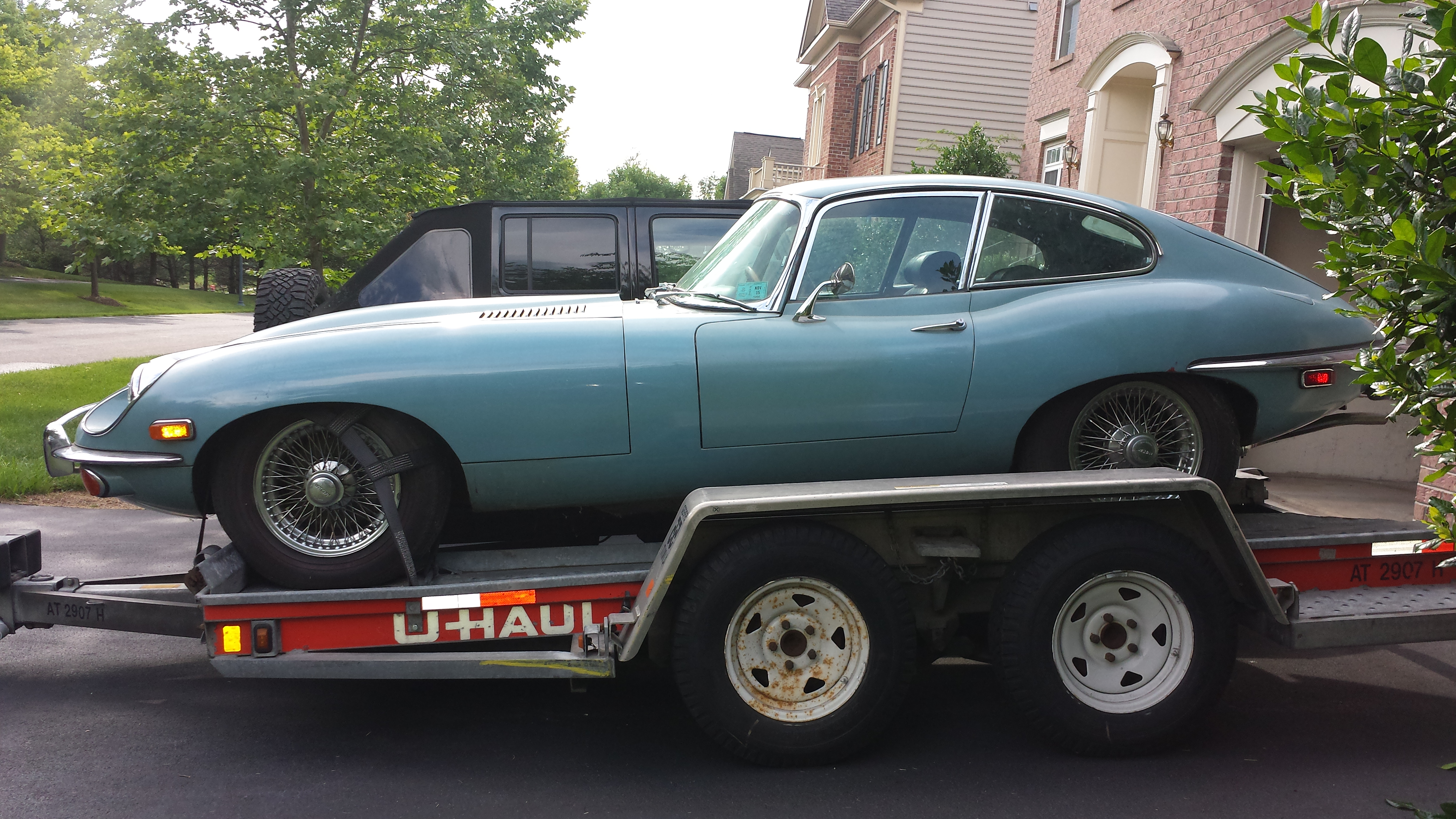

Default Update with photos
Here Are the Photos. Body is decent ( aside for the small dngs I made when I was young on a bike)

Great looking car! To bad it is on a trailer.

Has it not run for those 20 years in a garage ? I took over an MG Midget after a 14 year lay-up, but it was started and warmed through occasionally although not run on the road. Re-commissioning of the Midget involved replacement of all fluids, and freeing-off of the clutch. You'll probably also find the clutch won't free-off and you may have some difficulty doing this, as it is a known Jaguar syndrome. In the end, you might have to split the engine and gearbox to get at the clutch.
You do need to make sure all the brake calipers are free and working, and check all the flexibles. Suspension joints should all be OK. Exhaust system may be rotted out, so plan for a replacement in stainless steel. Battery will be shot and alternator output needs checking.
PS - all the tyres are well life-expired, so it is essential these are replaced even if the tread depth is OK
