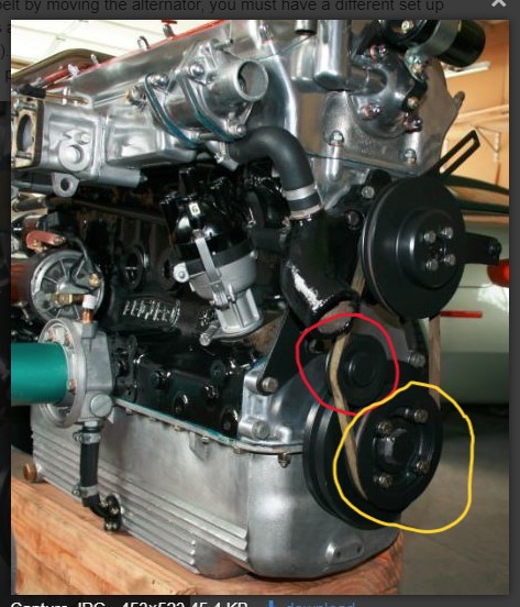

This happened while driving @ 35 miles an hour on a road course re-enactment at Road America this past Saturday. (9/17) Car temp gauge pegged full right, oil pressure dropped from 40 to 20, charge needle indicated under 12 v. Once I found that the belt was off, the gauge indications all made sense. Did not go more than 1/4 mile to safe place to check car over. Car was flatbedded home, to await discussion with shop that did the rebuild. Here are photos: First is stock engine, red circle is tensioner, yellow circle is water pump pulley. Second photo is what is left on my engine.

Very much depends on how hot the engine got before you shut it down. The worst extreme case is a blown head gasket and warped head but I’d suspect little or no damage was done in this case.

Sorry to hear about the trouble…..frustrating to have a shop rebuild fail so quickly. You didn’t drive very far afterwards and you still had oil pressure. So I would not expect damage. I would perform a compression check to make sure there is still a good head gasket seal and check the color of the oil looking for any sign of water. It would also not hurt to change the oil as well. Probably some coolant was lost so that should be checked and I would examine the belt closely looking for any cut or fraying. These engines are prone to tappet guide loosening in an overheat situation. Maybe your rebuild included tappet guide hold downs? If not I would remove the cam covers and examine each guide to make sure it is still seated….especially the exhaust side. Hope there is nothing serious, Cheers, Richard

Yes, I believe that the short duration of the no-charge, high temp and thinned oil was the saving grace for this episode. The fans come on at ignition (there are supposed to) and we cranked the starter a couple of seconds and the engine turns. Yes to coolant change, oil change, belt, compression and tappet guide checks. There don't appear to be any leaks... oil or coolant. I believe I have found an alternative shop, but I will go down there first to discuss what happened and to do a sniff test of the operation. I am often treated in a dismissive manner in shops and if that happens I go elsewhere.
