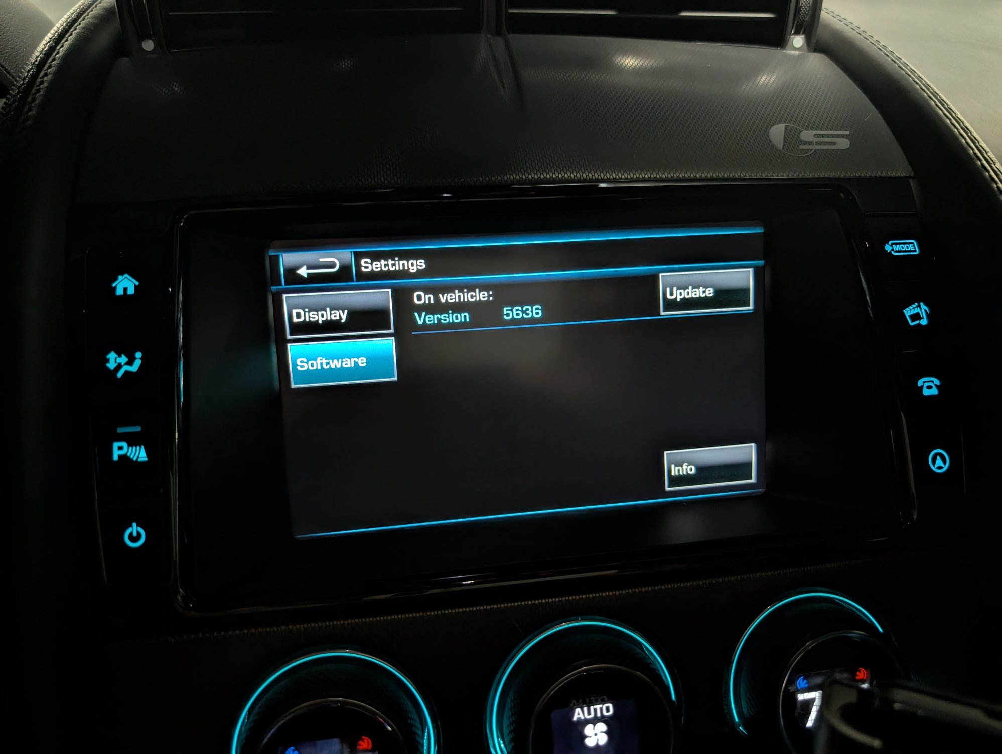

This is what I currently have, I'm actually pretty happy with it. Would I be happier with Carplay, or in my case, Android auto? Yes. ☺️
Ideally I'd love it to be wireless, just wondering what my options are given my cars current setup, and of course how much is be looking to empty from my wallet.
Thanks in advance for any info, I've read quite a few threads already but I'm not sure which solutions are relevant to my unit and software version.

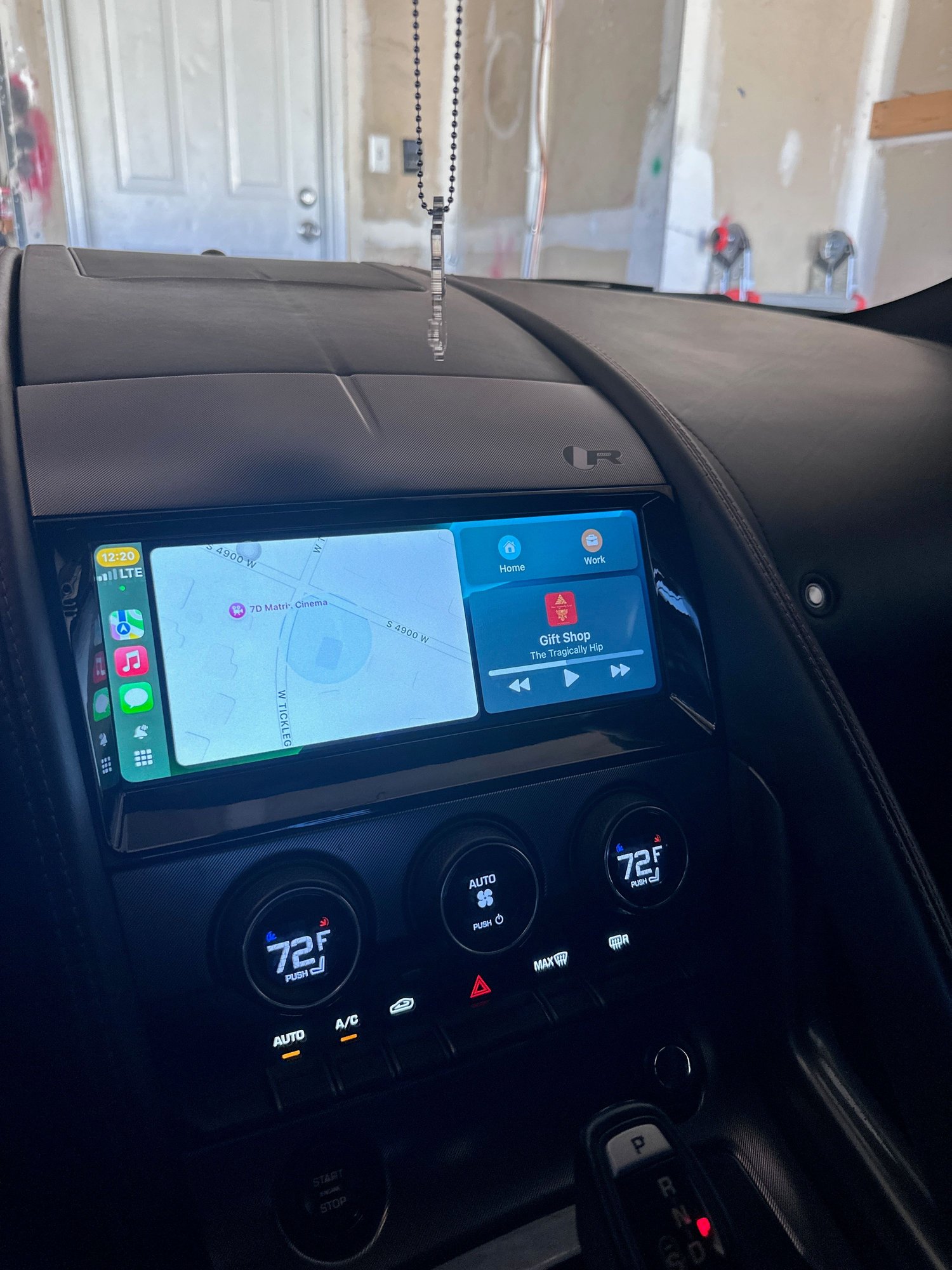

Originally Posted by FTypeInTheSu
[img
https://cimg9.ibsrv.net/gimg/www.jaguarforums.com-vbulletin/1500x2000/image_07b30b72854d1aab3510308e0c511e802c944d9e.jpg
n;2897398]
https://www.alibaba.com/product-deta...iABEgICkvD_BwE
I have the above unit installed in my 2017. It was straightforward to install and retained all the steering wheel controls
