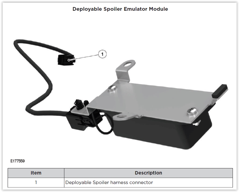

Originally Posted by Cambo
Attachment 210926
Attachment 210927
Attachment 210928
I checked the price on this module as a spare part a while back, it's, umm...
Just cut the rod
Do you know what it’s part number?

SDD is Sympton Driven Diagnostics. It is the JLR Dx Software (one of them). I purchased a Mongoose (Drew Technologies or other aftermarkets available) cable and JLR offers the software free from many download sites.
It is not the most intuitive software, but I have tinkered with enough to be able to do some basic things. You can go in to the programming section and change deployable spoiler to "no"...Then it stops looking for it or throwing errors.
All moot now anyway. Just bought the JLR F-Type Fixed wing, and looks like it comes with a connector to disable it anyway Still have to get it painted first The switch was easy. I mounted mine in a pre-existing hole under the steering column area.
Got this from this forum.

Dwelter, before you go shelling out on SDD be warned that it's not quite as simple as DC makes out and you can very easily brick your ECU if you get it wrong.
I'll let our resident SDD expert Cambo fill in the details.
