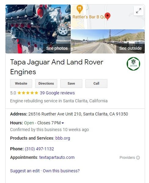

assuming you're doing some research on that company...if not, here's some quick things I pulled up based on a quick google search on their phone number. no idea if good or bad, that's for you to decide.
their own site: https://text-a-part-auto-jaguar.business.site/?m=true/
https://www.bbb.org/us/ca/santa-clar...e-1216-1278229
https://www.yelp.com/biz/tapa-jaguar...e-sun-valley-4 (only one review)
https://www.loc8nearme.com/californi...7975/comments/ (this and the one below pull reviews from google)
https://www.merchantcircle.com/tapa-...yon-country-ca
no other reviews on other sites that I could find. this is either good or bad depending on how you look at...good in that not many motors need to be fully rebuilt or customers had good experiences that don't require review or had nothing to complain about...bad in that they don't do many rebuilds.
good luck. I'd also be interested to hear about what you found out about the car prior to you purchasing it. do you have it's history?

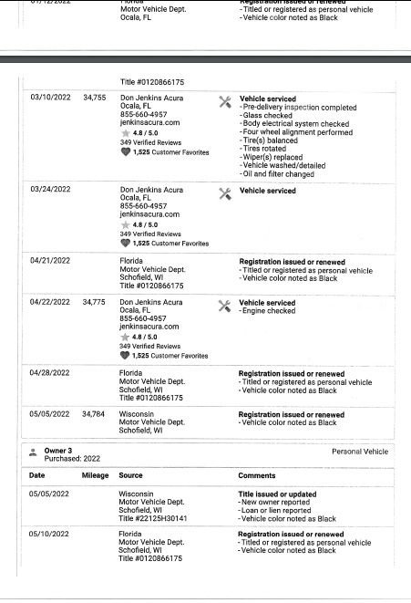

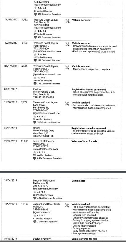

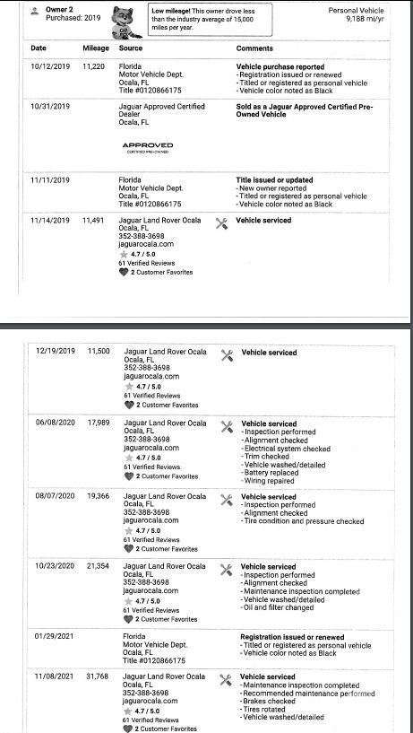

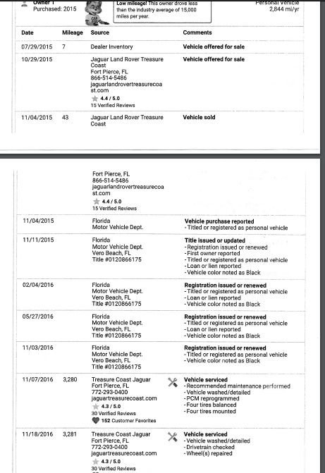

Car fax from the car...
Man I really hope I don't get screwed over on this purchase of the engine now.. So tempting tho and I still think it might be my best option.
Giving credit card details is always sketchy af. Least the bank can reimburse if fraud or anything.
