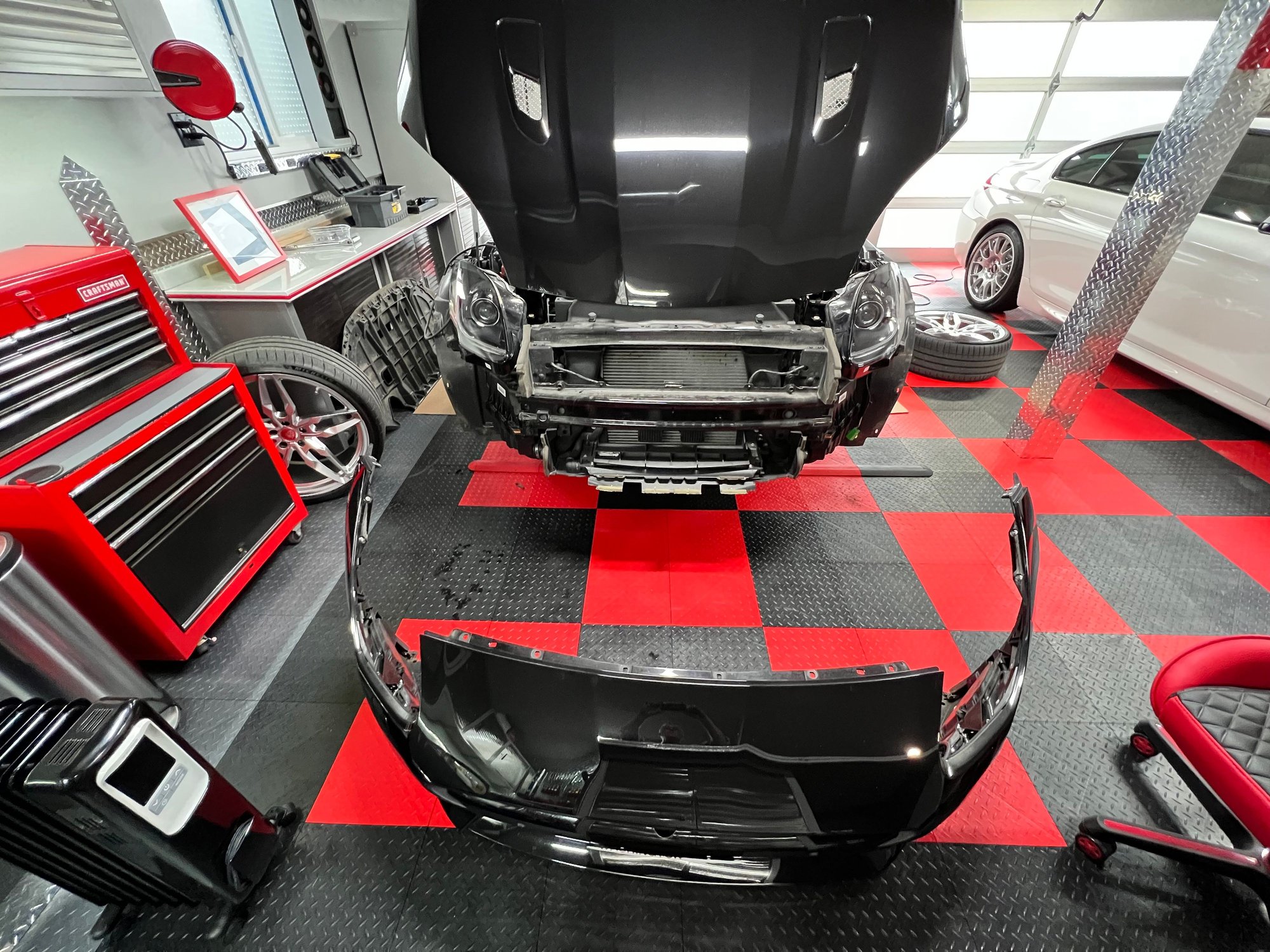

I couldn't find any videos on how to best remove the front fascia on an F-Type, so I muddled through it and made one so others could make use of it.
Pretty easy, but this also helps me remember how to put things back together
