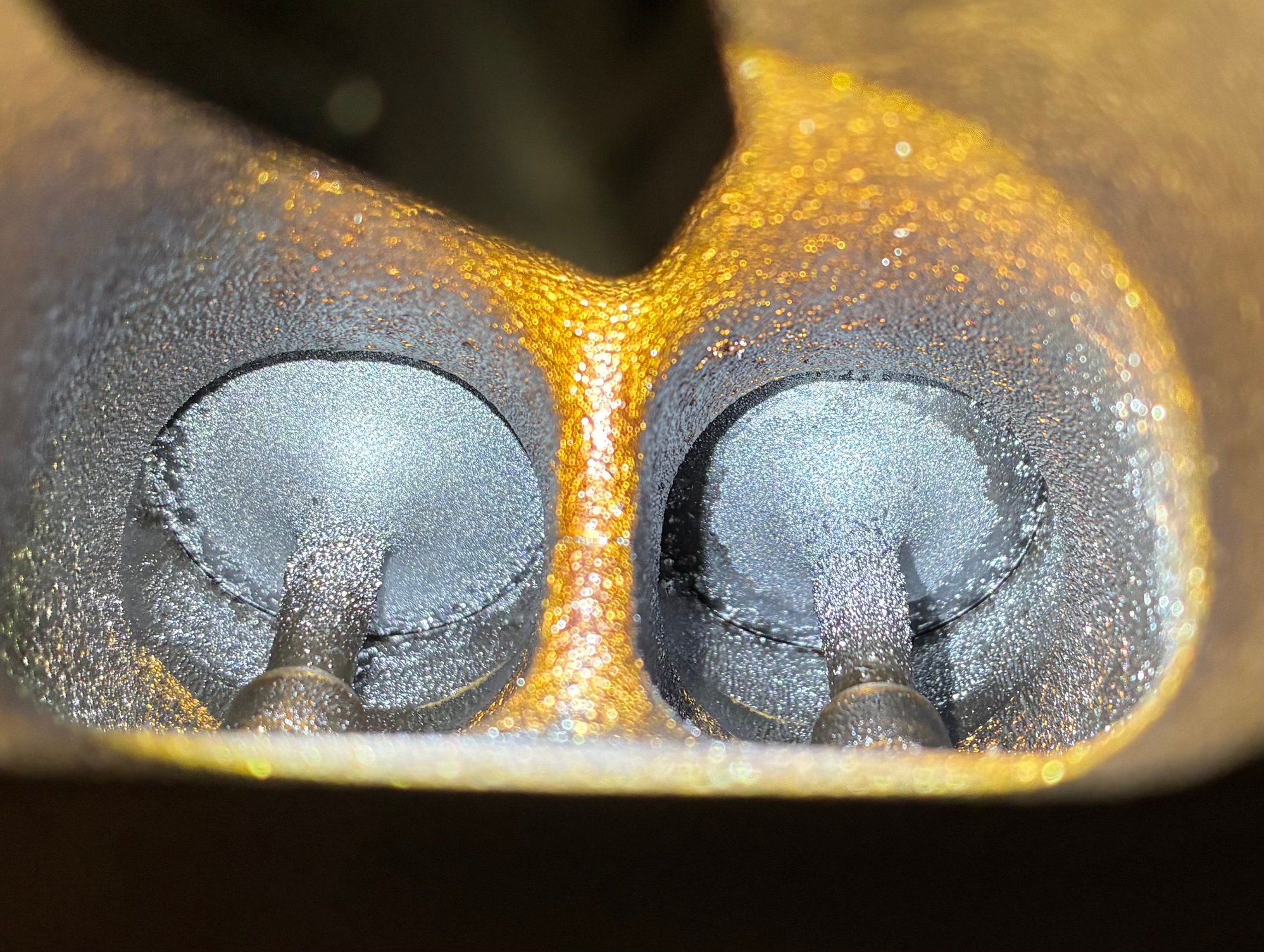

This is an older thread, but these DI engines need the intake valves cleaned. Here are mine at 34,000 miles before and after I cleaned them. Noticeable difference in how smooth the idle is now. All 16 valves were like this. I added an oil catch can to help.
Old Feb 9, 2026 | 07:09 AM
  #36
clubairth1's Avatar
Community Influencer
Posts: 12,134
Likes: 3,383
From: home
Nice clean valves! Never seen them that clean before.

I’m not a JLR tech/mechanic, just a shade tree mechanic who’s worked on his own cars for over 30 years. I had an 07 Mini Cooper S with a bigger turbo, meth injection, and questionable tune (only owned it for six months - horrible cars) that probably needed the valves cleaned every other oil change. Then I had a tuned VW Golf R that could probably go 30-40K without a problem.
I had the supercharger off changing out the Y pipe and other coolant pipes and took a look at the valves. Saw what they looked like and went down the two day rabbit hole of chemically cleaning them. It’s a PITA, but smoothed out the idle dramatically.

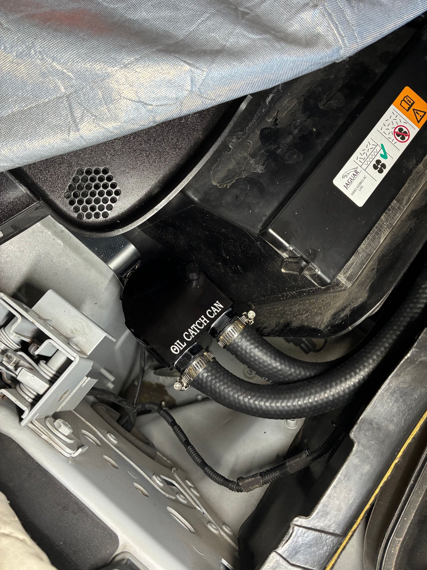

Adding a catch can seems to be the obvious solution and I am considering it as others (Mainly F-Type guys) do run them. Still not convinced that will solve it as people with catch cans have had to clean the valves too. Another interesting thing is Ford finally gave up and added a set of port injectors on several engines (Coyote is one I am aware of). This did 2 things. Allowed more fuel into the engine and the intake track is once again cleaned by the intake charge.

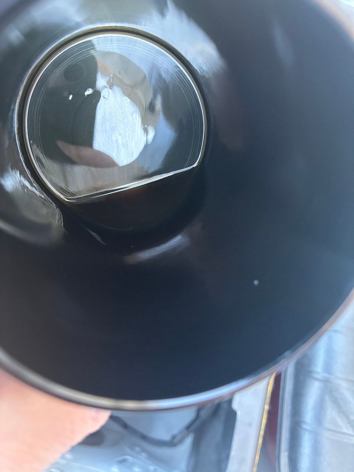

This was in the catch can after 300 miles, spirited driving, and three trips down the drag strip:
Probably about a teaspoon worth of oil that didn’t go down the intake
