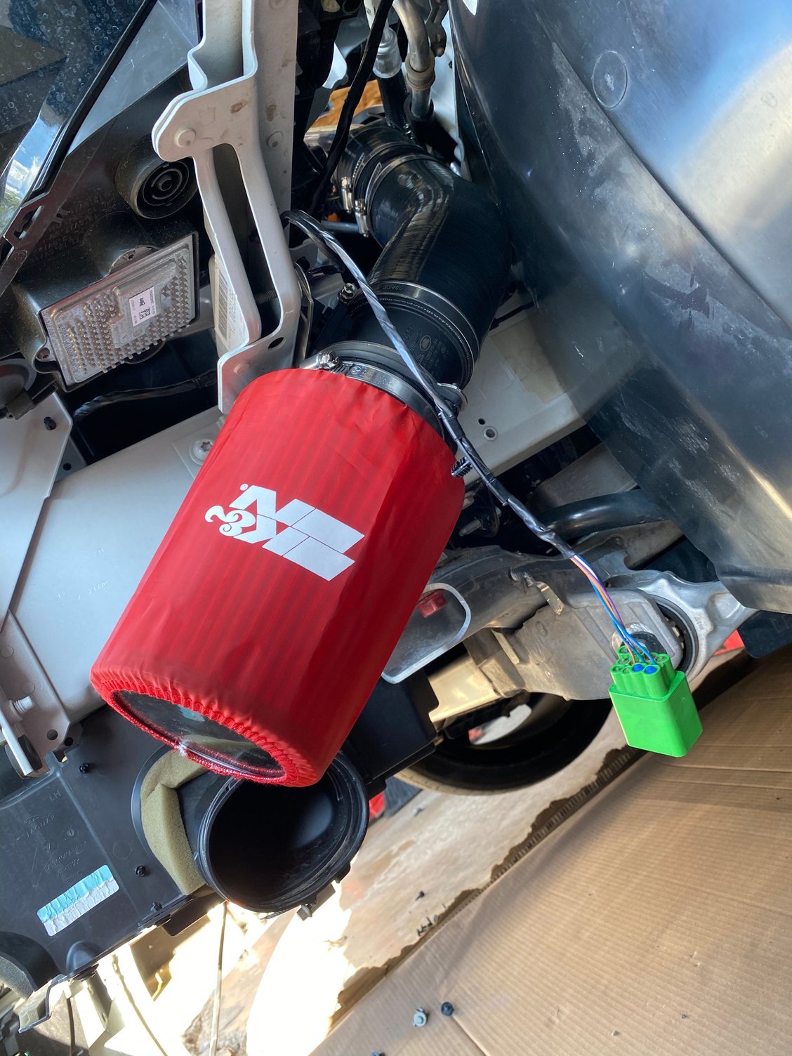

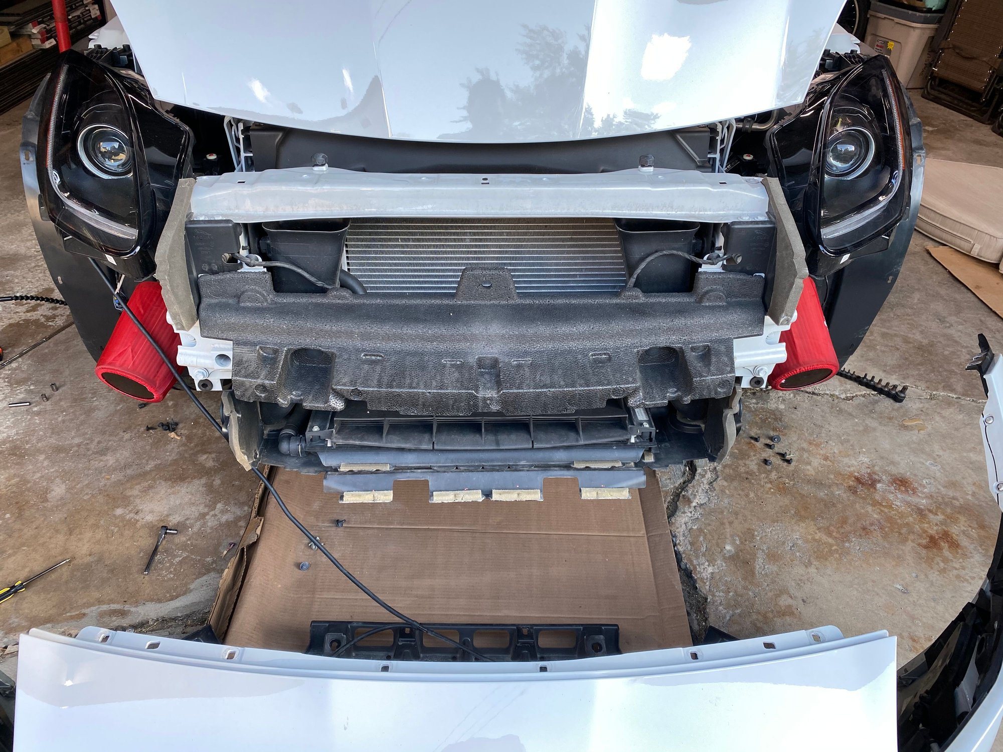

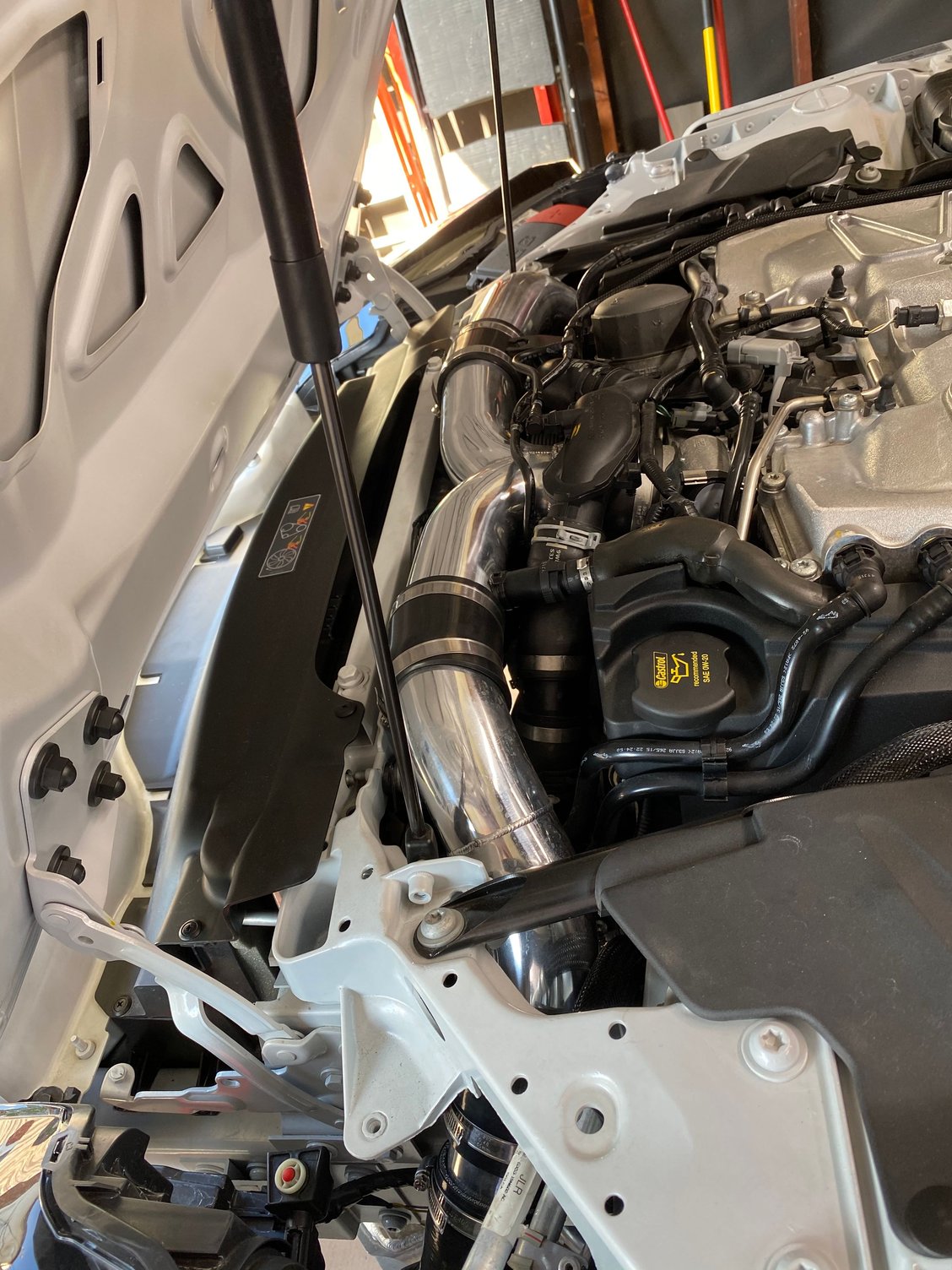

Chris from VAP sent me a batch of 5 different test tunes. Long story short it’s a tune issue. It is NOT a Mina Gallery lower intake or upper intake tube issue.
Call Mina Gallery and speak with Chris if you want to order the new lower intake...definitely worth it. Also it’s WAY easier to remove the front bumper to have them installed. I’ll post some pictures below. I also bought K&N pre filter wraps just to be safe.
