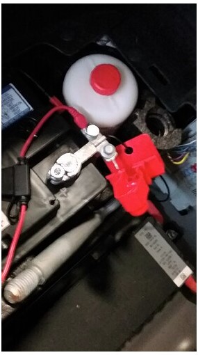

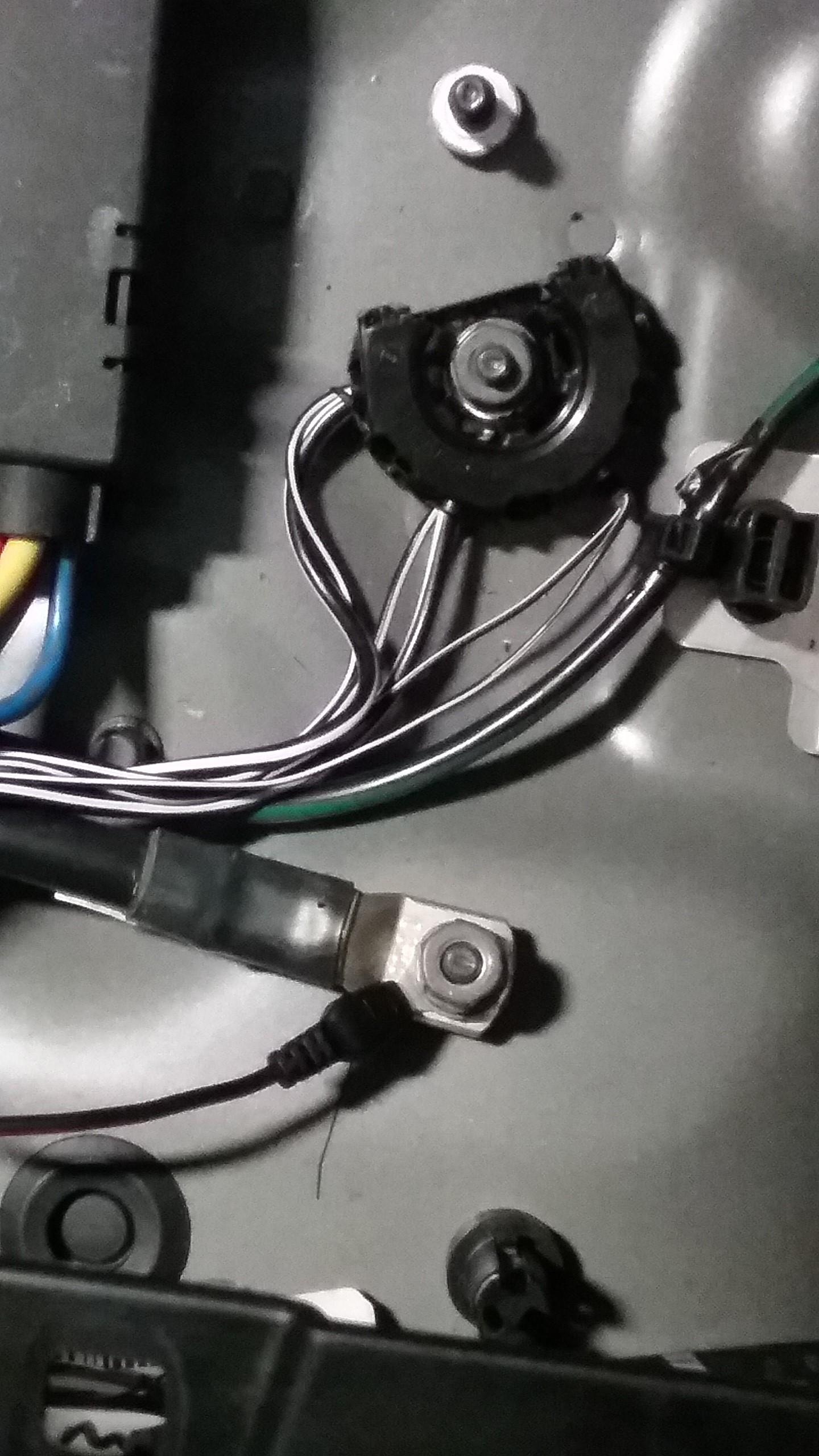

Default this is the charger many of us use
Amazon Amazon
You can connect it with the 'alligator' clips or the rings. Several threads on the 'best' way to connect it. I used the rings, attached it to a 'sidebar' on the positive/red post on my battery and the black/negative to the ground post/bolt in the bottom of the trunk/boot. This was what my Jaguar tech recommended, but there are MANY opinions on how to connect it. The Ctek has settings for AGM battery and standard lead/acid battery. Car battery and motorcycle battery. The Ctek has a 2-piece lead wire, which allows you to separate the wall plug end from the battery connection end. While charging I have found that it is safe and non-damaging to run the wire out the trunk/boot over the soft weatherstrip seal and also close the lid. Like anything electrical, always check what's happening on a frequent basis to make sure everything is OK.
https://www.jaguarforums.com/forum/f...harger-239829/
and yes, do replace the battery. The AGMs do not always have a life beyond 4-5 years, though there are some owners who report longer. Best to take the car out for a good long drive to make sure the battery gets the recharge it needs and prefers. The other thing that may be happening is a software update. My 2017's backup sensors started acting strangely and that was cured by an update.
