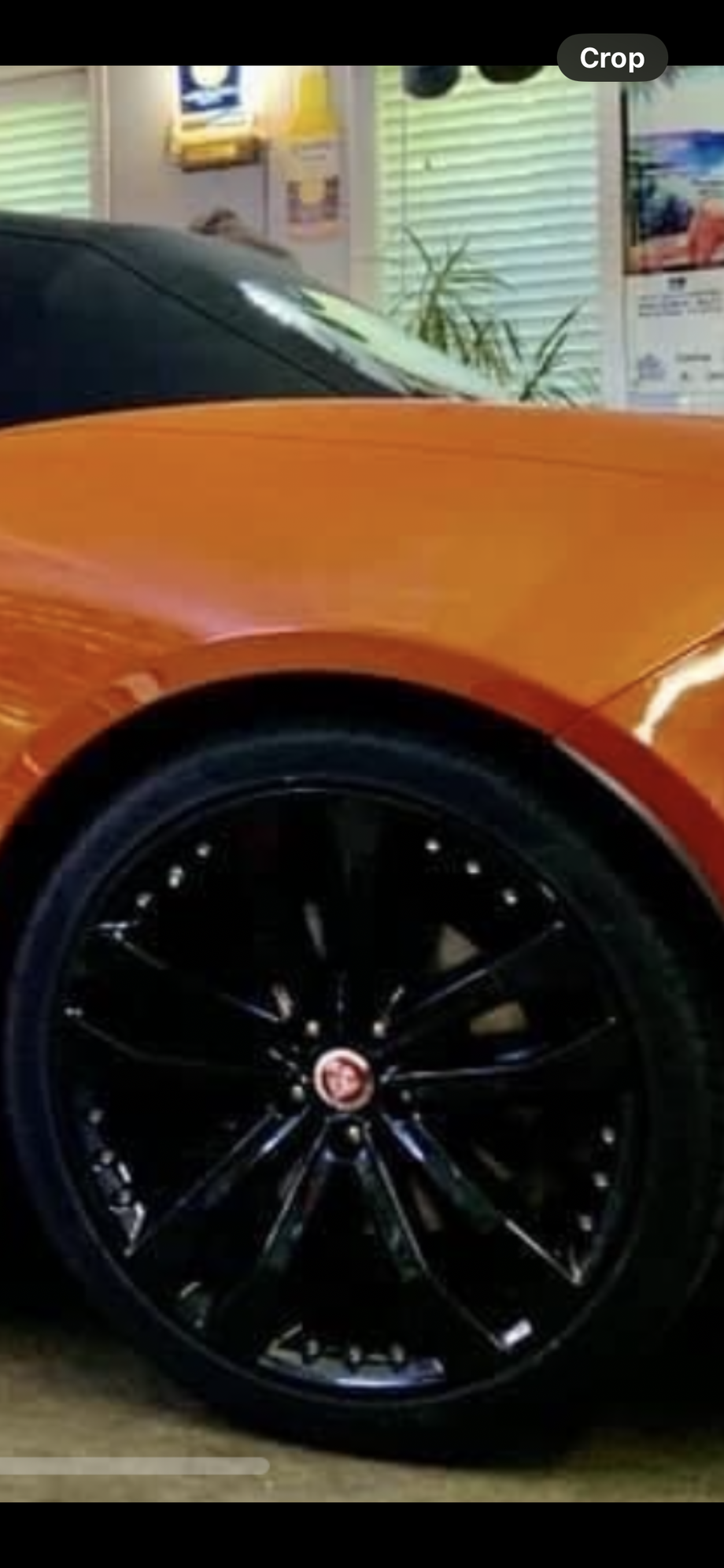

Looking to fit H&R 15mm spacers (part # 3035634 SW) on my 2016 S convertible. I know that the studs require shaving/grinding- but does the wheel nut/hub need any alterations… I’m running these 20’s…conversely anyone suggest alternative spacers brands if the H&R’s don’t work????

The wheel stud trimming is dependent on the wheel. If that is your car in the original post, those wheels should not require shaving down the wheel studs.
Yes, that’s my car…I thought only the “blade” rims required no stud trimming or grinding…I guess my shop will let me know once they get the spacers and lowering springs in…

Correct, the only OEM wheels which do not require trimming of the studs to fit 15 mm spacers are the Blade wheels and your wheels will require stud trimming.

Not exactly true. I have the split spoke 19" wheel and it didn't require trimming. It's really apparently when it's needed so I just recommend everyone to not assume and start cutting their studs.
Thanks for the correction.
I should have said only 20" OEM wheel.
