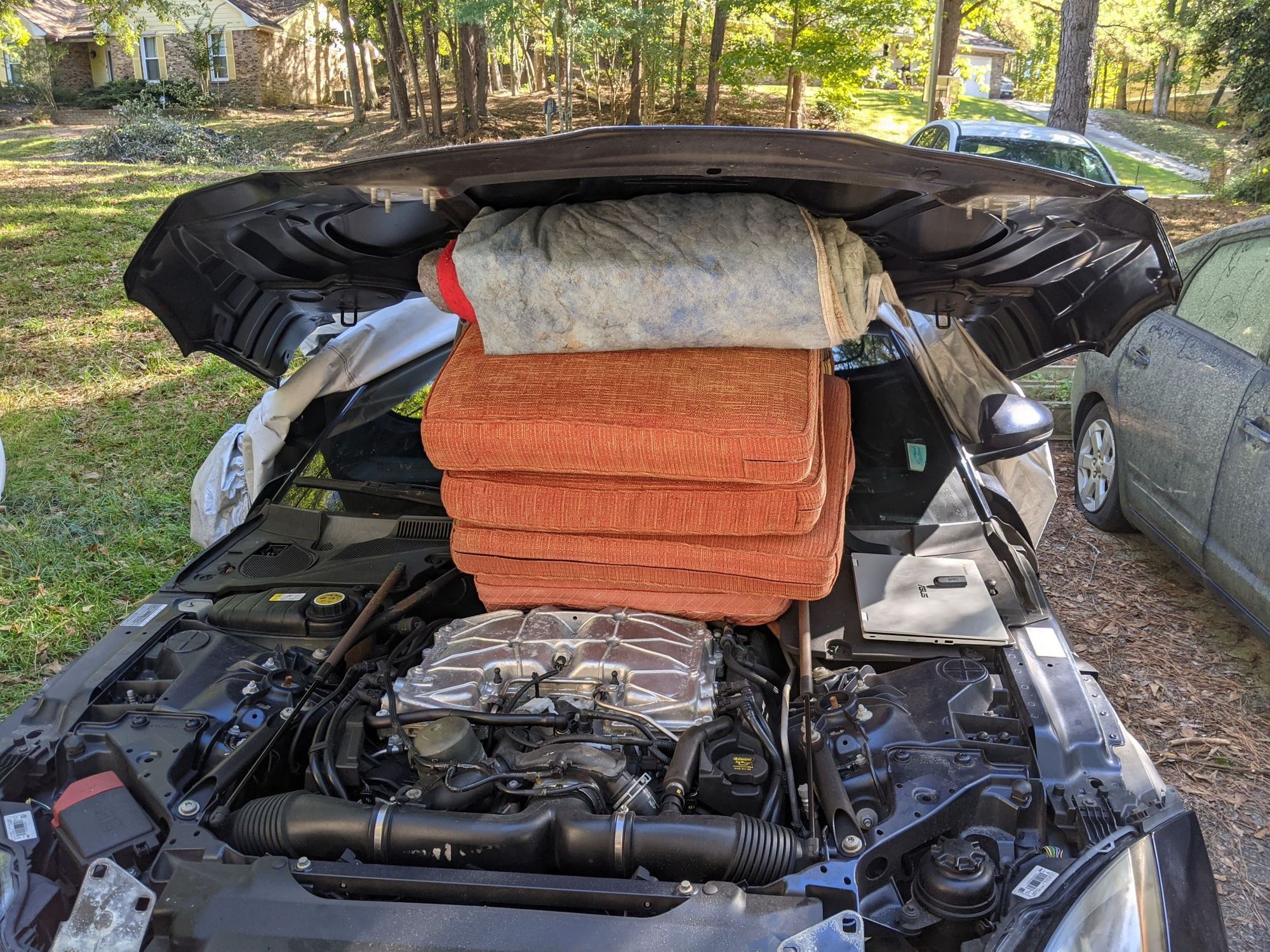

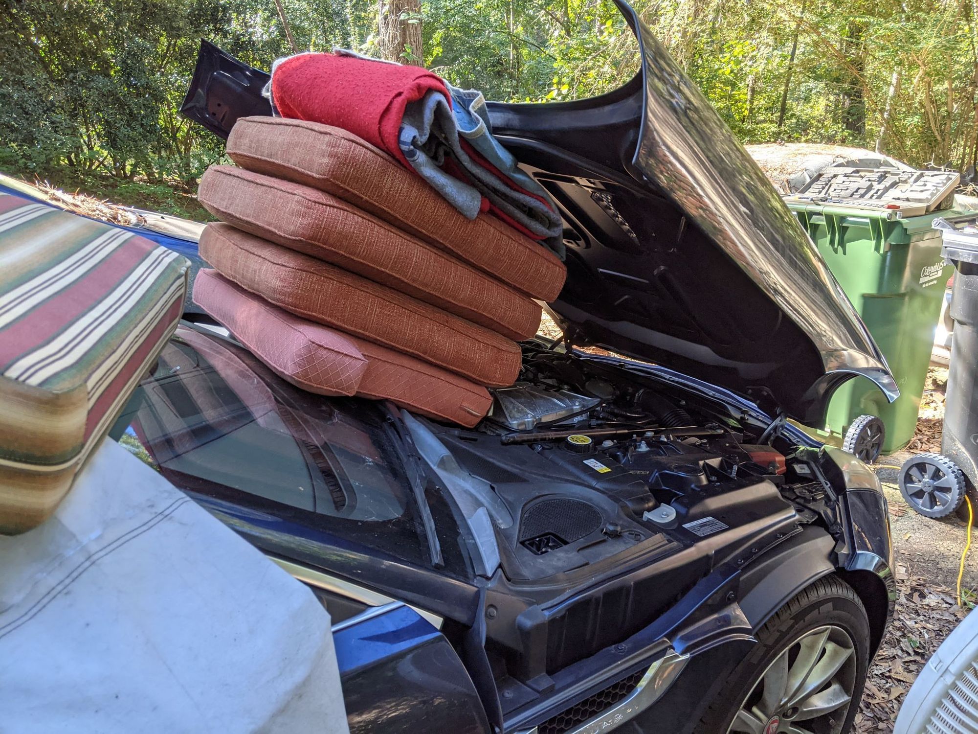

This worked perfectly for me - disclaimer - do at your own risk. 😲
Place 4-5 couch cushions on top of engine & one wide one on windshield - strongly suggest you place an old clean towel/blanket/etc. between engine & bottom cushion, another on top cushion and another between winshield & wide cushion or be prepared to face the wrath of your wife 😱 😲 😵
Remove the bolt caps (4 each side) then loosen all 13mm nuts (8) & remove 3 from each side
Using a small screw driver, carefully pry circlip loose on each strut - I removed mine but think if you just pry loose where there's a gap, strut will pop out
Pull off both struts from hood & lay hood on cushions

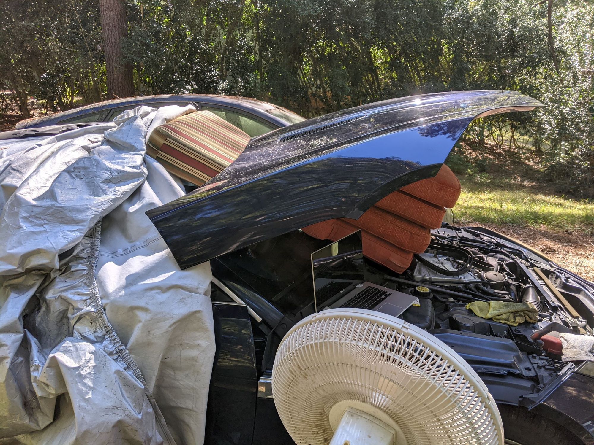

Remove remaining nut from each side then gently raise the front of hood & slide towards rear until back of hood rest on wide cushion on windshield
If you need to work on the back part of engine, you could place a thick blanket on top of car then lift back of hood, put enough cushions on wide cushion to raise back of hood just above top of car then slide hood further back onto top of car.
Now you can easily work on front of engine
Reverse to install - NOTE, when replacing struts, if you removed the circlips, put circlip on strut from top 1st then snap in place

FWIW - my method - 5 minutes to remove and only 5 minutes to put back - easy peasy. As mentioned by Dennis, be sure to line up brackets & bolts perfectly for proper alignment of hood.
