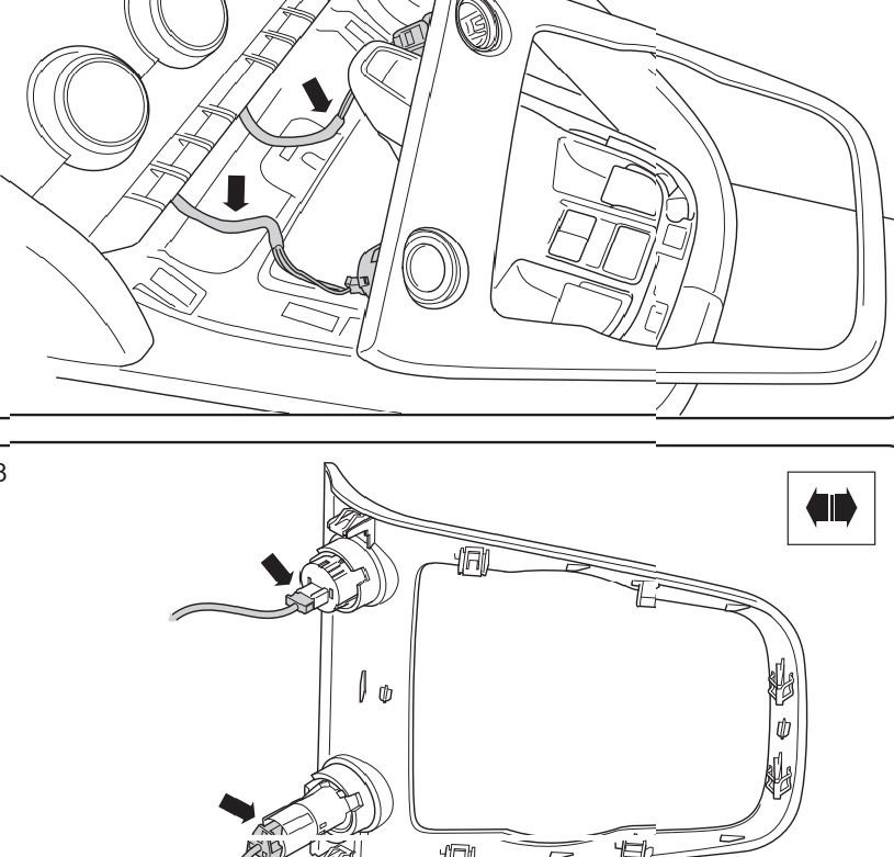

Here is a diagram that may help.

Default Great diagrams!
Where did you getthese diagrams... they are amazing!

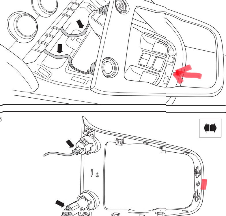

Using a plastic pry tool leave up the front lip of that part
The lip is only 2-3mm , if you insert your pry tool more than that it catches on another fixed lip beyond that and won’t budge.

New and older members. Try to remember that his forum is your friend. Just look a little. The diagram is found at the beginning of the forum page under: Sticky F-Type 'HOW TO' Guides and Information. Scrool down to: Fitting Instructions #2 INTERIOR and you will see a topic: Center Console Trim. There you will find your picture.
