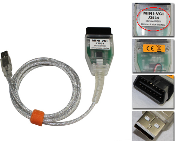

In the past few days I've read quite a bit about JLR, J2534, this thread, etc., and have a rather lame question:
As plums has stated earlier, "The Mongoose is a protocol converter, nothing else." On one side it has J2534-1/2 standard, and on the other a number of industry standards (CAN, J1850, ISO9141, etc.).
As far as I can tell, there are other such "standard" protocol converters (see attachment). Is there something really special about Mongoose design/operation that other converters don't have? Do they really utilize one, or more, of the "Manufacturer discretion" lines from the OBDII J1962 connector to do full diagnostics?
I mean, what do you think will happen if you run JLR through a non-Mongoose converter? Or IDS on a Ford vehicle? Get "generic" OBDII diagnostics only? As this is the original idea behind the J2534 and "pass thru" concept, right?

You would need to verify capabilities with the particular vendor.
There are only three devices on the "approved" list from Jaguar.
In the case of the Mongoose, it has to be the Jaguar specific version. That is because there is one particular signal used by Jaguar and implemented in that version that is not implemented in the other versions.
