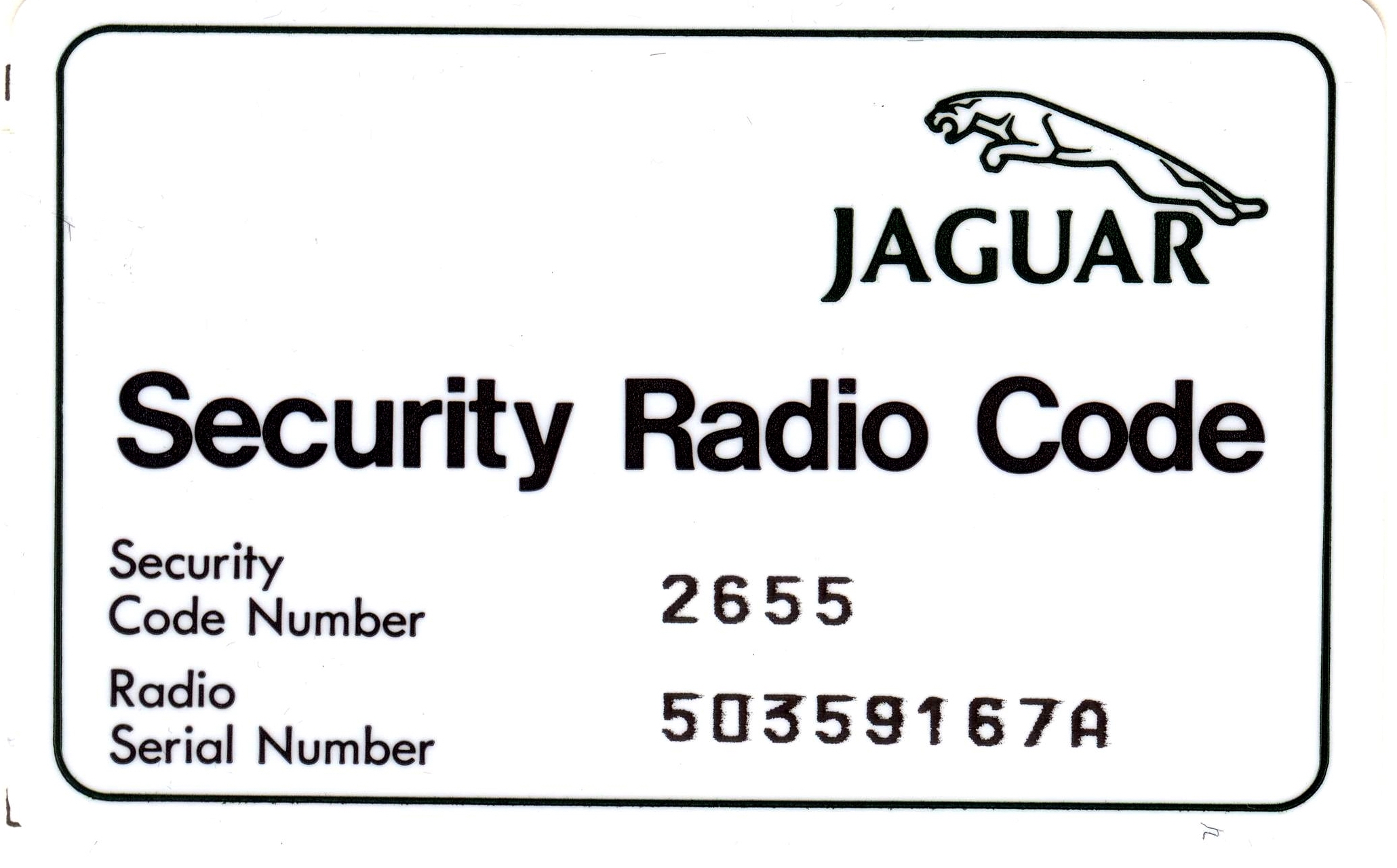

Jaguar Radio Security Codes are 4-Numeric:
Attachment 47292
Very rare to find a secured radio fitted in a non-UK spec vehicle but it does sometimes happen. Such vehicles are originally supplied with two code cards (the size of credit cards) with the 4-Numeric Security Code Number and the Radio Serial Number.
It's even rarer to find the code cards with a used Jaguar!

307883281600350 Jul 7, 2013 02:43 AM
But, what is this mystery code that does come up when 2 & 6 are pressed together?
