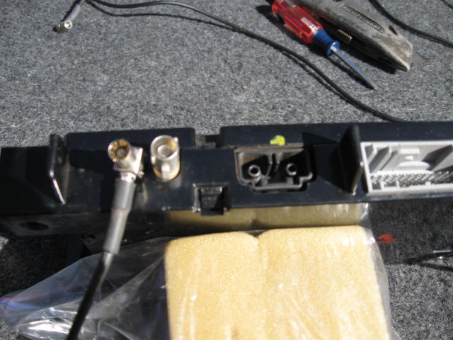

OEM Bluetooth retrofit has gotten easier for Jaguars using the D2B fiber-optic system!
This post is applicable to X-Type, S-Type and XJ but based on my 2007 X-Type.
A combined PSE (phone support equipment) module and BTUM (Bluetooth upgrade module) is available. Part # 7W93-10D893-AB takes the place of the PSE and eliminates the need for the BTUM.
Attachment 158168
The new phone module is installed in place of the PSE module and also requires antenna and microphone connections.
Phone connector (PH1) and D2B fiber-optic connector (CD3) are located in the left side of the Boot, behind the trim panel in pre-wired vehicles. They plug into the phone module which is typically mounted in the electronics stack (bracket). If no stack/bracket or extended trim panel is present, the phone module will fit behind the standard trim panel.
Attachment 158169
The OEM installation includes a Bluetooth antenna located under the package shelf trim panel. Retail is $60 or so but there is a simple alternative. A Jaguar/European radio connector and coax cable can be adapted for use with the Bluetooth module. Remove the plastic shell from the radio connector to yield a smaller metal connector that fits the phone module perfectly. The coax cable can then be routed under the folding left rear seat hinge and under the door trim. It is not necessary to remove the door trim. Just tuck the coax up and under the door trim from rear to the front, beside the driver.
A dipole antenna can be fabricated at the end of the coax cable: Strip the coax outer jacket 31.25 mm, fold back the braid 180 degrees and tape to the side of the coax cable. Do not strip the center conductor. The result is a very effective ¼ wave antenna for 2.4 Ghz. It works very well located beneath the plastic door trim.

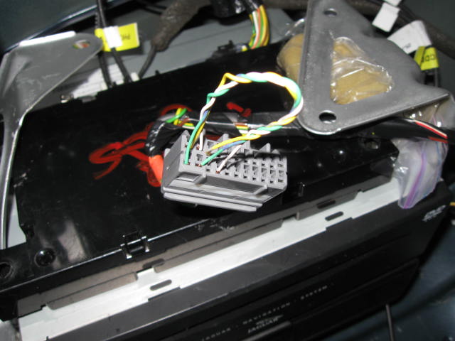

If you have no VACM (voice activated control module) the microphone circuit must bypass that plug.
The VACM plug (PH2) is a 22way black connector located adjacent to the phone module in the left boot.
The bypass can be done using the voice activation shorting loop which is part number XR837852.
However, if you don’t have the shorting loop, it can be done simply using 22 ga copper (telephone) wire:
Use three 22 ga copper wires (green, white and yellow are recommended to maintain the color code), each 3-1/2” long, stripped 3/8” on each end. Fold each bare end back and crimp to form a 3/16” tab similar to the male plug pins. Insert the wires into the VACM plug:
Jumper Pin to Pin
Green 12 - 13
White 2 - 15
Yellow 1 - 3
The PH2, 22 way black connector is numbered on the back: 1, 11, 12, 22.

Prior to the "all-in-one" 7W93-10D893-AB module, our cars used a PSE (phone support equipment module) in the trunk and a Bluetooth interface module located under the console. The wiring between the connector under the console and the PSE is not required for the new Bluetooth module. However, the yellow and green microphone jumpers at the PSE module are required.
The PSE was originally designed to work with a cell phone and the Jaguar emergency network. The cell phone was located in the console. The Bluetooth interface module was located under the console to take advantage of the existing cell phone connector/connection to the PSE in the trunk.
The combined module that you have replaces both the PSE and BIM.
