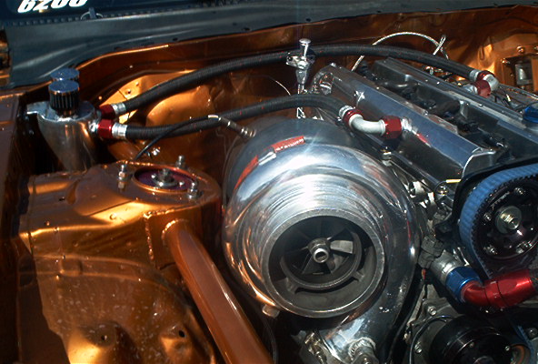

someplace in my books i have one of the best reads and tests of evaporative cooling i have ever read!
it absolutely does work, basicly anything that lowers air inlet charge will help engine performance, tuned accordingly.
should be mentioned that water /meth injection will and does cool incoming air charge also!
i was at a Dyno tuning session,the car,a 1994 Supra I 6 turbocharged, made 70hp more with W/M injection,VS not injected, of course tuning was different between tests!
timing could be advanced more,also not as much retard under higher boost numbers, and could run slightly leaner A/F ratios!
you need a experienced tuner for these tests tho!
when dealing with over 1000HP you had better know whats happening!
Attached Thumbnails Intercooler Upgrade.....laminova-tx2k8-2008-houston-009.jpg   Intercooler Upgrade.....laminova-tx2k8-2008-houston-008.jpg

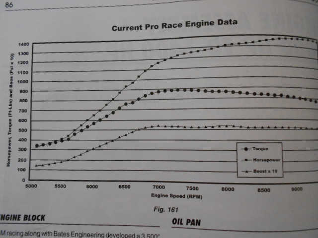

while we are talking silly engines, dyno sheet for a GM ecotec ,4 banger, 2.2L!
thousands of them out there, in lowly cobalt, malibu, ffr, and many other Gm cars!
back few years, GM was selling them as crate engines(cant remember cost), none of the muscle head car guys wanted a 4cylinder engine, so they dropped the compact race program when GM almost went under 2008, downsizing!
i got hold of one of there books on complete modifications of the Ecotec, has part numbers and specifications for the machining and parts availability vendors.
a very engine savvy piece of reading, the mod i liked, was they run the ARP cylinder head studs, thru the complete block into the lower end main bearing girdel, the block end up like a sandwich in between the head and main bearing caps/girdel, NO more lifting the head or blowing out the bottom end!! NICE. lotsa boost 50/60 psi, OMH.
Attached Thumbnails Intercooler Upgrade.....laminova-ecotec-engine-003.jpg   Intercooler Upgrade.....laminova-ecotec-engine-001.jpg   Intercooler Upgrade.....laminova-ecotec-engine-002.jpg
