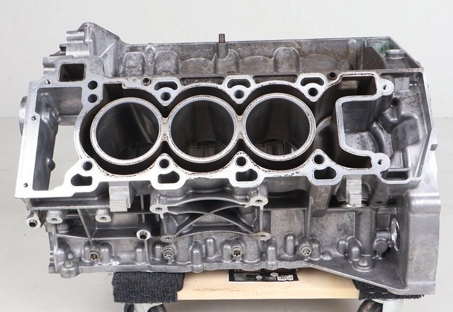

Old 01-13-2024, 07:24 PM
Paulnunya66's Avatar
Join Date: Jan 2024
Posts: 1
Received 0 Likes on 0 Posts
Default Actually they are
https://www.reddit.com/r/CarDetails/...tm_name=iossmf
Originally Posted by Stuart@VelocityAP
That sounds about right. I didn't mean literally blanked off, like there's a plate bolted to the top or something, hence the parentheses.
It would be interesting to see where the bores are physically located in the block. My conversation with a Jag dealer technician seemed to indicate that they were offset towards the front of the block, which would make sense from a weight distribution point of view.
