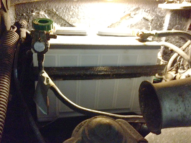

Default Battery as found
Preliminaries on battery

I use Interstate Batteries in my two Jags, they hold up to storage with a maintainer and have enough reserve power to keep cranking when the darn things don't wanna start.
if you store your car mostly, never driving it, and you like to spend big money, then get the Odyssey Battery sold by Star Auto Electric:
Star Auto Electric Company - Battery Review

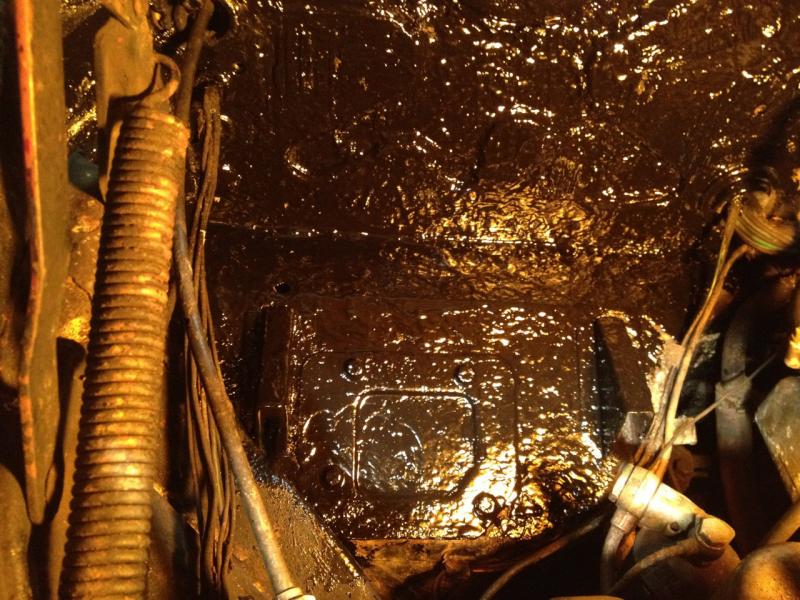

BATTERY RECAP: Replaced battery cables with #1 gauge, battery with Group 27 type, Cleaned brass attachment screws, strap, added rubber (gummed against the strap) between battery and strap, felt under battery. Tossed the disconnect. It was for smaller battery terminals. Everything fits nice and tight. Attachment screws in to the last thread.
First step done in moving toward a start up. Next, checking oil. Removing plugs to clean, turn the motor by hand. Clean fuel line and tank. I'm sure there will be other issues.
