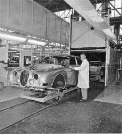

One certainly can but the cost differential of just re-boring a 3.4 & fitting oversize pistons vs the major surgery required to revive a 4.2 with cracked block back to good health would be considerable on my side of the pond. I think the smooth revving 3.4 engine is a gem. I love my balanced & weight matched rods & pistons 3.8. My crank & flywheel/clutch assembly were way out of balance when we started my restoration.
Finished cranks & cams were part of the CKD kit we received from Jaguar. We only machined blank heads & blocks here to meet Lyons arrangement with government on our local content program which at the time was based on weight (Phase 2 = 55%). All upholstery was local as were items like batteries, springs etc. Silverton made tropical radiators locally as an example. Finished woodwork was part of the kit. Book-matched veneering was not a developed SA skill set at the time. We could do it but not on a volume basis. (Lyons was clever. He managed to get UK castings of heavy components accepted into the weight deal)
CKD S Type.
