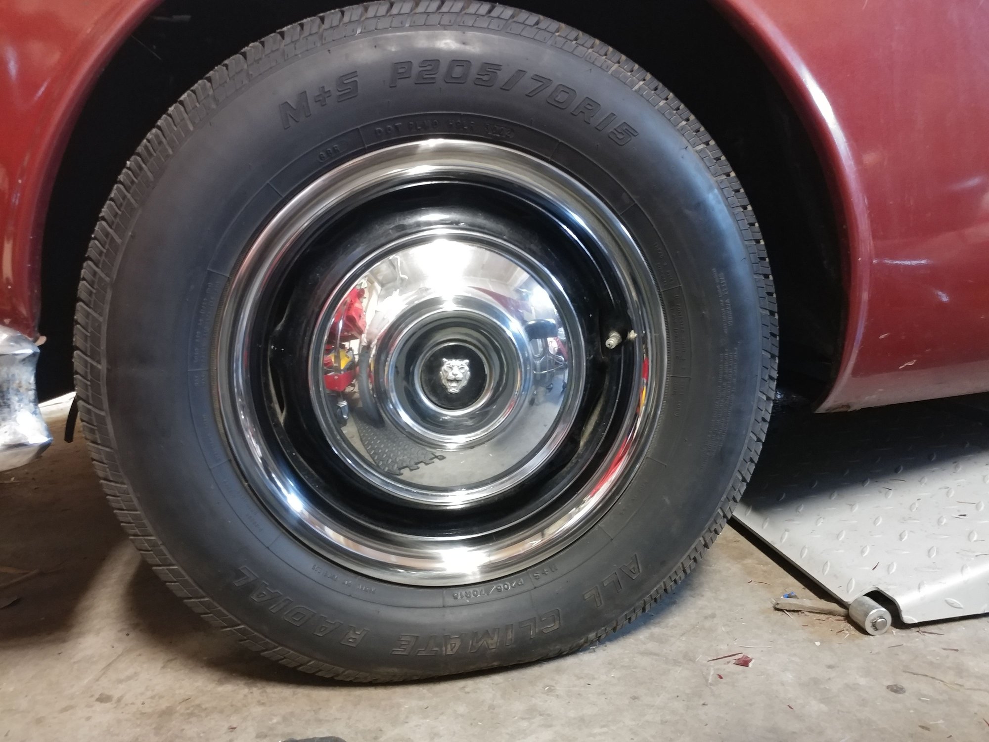

I really wanted wire wheels.....then I thought about the cost of replacing the hubs, assuming of course I could get the rear hubs off. Then I figured I'd just use the bolt-on style, they are pretty good after all - but then I remembered how horrid wires are to clean, and they're not without some upkeep requirements as well. Suddenly, good old steelies with trim rings and cap, seems quite sufficient ;-)

Yes. & it does give us the opportunity to shine up the hubcaps, which are much less tiresome than Wires, it must be said.
