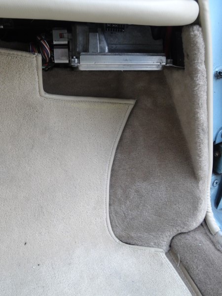

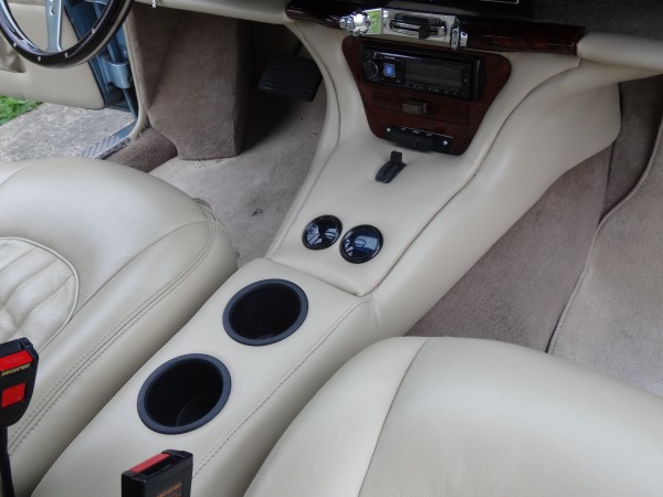

Since the S-Type Forum cannot post pics on your thread due to memory limit right now I saw your post here and posted some pics.
What I recommend is to do what I did which is use a simple not expensive but good quality Alpine CD unit with Bluetooth, Pandora, Ipod, Aux input, HD Radio which can be had for about $300 US then couple it with a five channel Alpine amp which is also inexpensive. The spend most of the money on the speakers which is what I did. I went with Focal separates front and back and two 6" long thro JL Audio subs in the passenger firewall facing you. By facing the subs to your ears instead of from the rear, etc. the 6" will sound more like 10's. If your budget is limited just start off with the fronts only and add the rest later. Good rule of thumb is 80% of your costs should be speakers and more like 20% on head unit and amps to get best sound.
You can see from my pics that I retain the classic wood around the radio and it looks factory yet is better than any new car audio system. Then for navigation you can replace your factory rear view mirror with ones that have both navigation and rear view camera and mount a high quality license frame camera set up. The rear view mirror will be split in half for the screen to display your rearview camera and navigation. That way you have all the modern features yet keep the classic Jag interior looking like it came from the factory. Also all speakers are hidden from site completely using Porsche speaker carpet. That is one of the only carpets that allow full range sound to pass thru with no problems. My center council is stock other than the addition of two battery volt meters and the two cup holders.
Attached Thumbnails Fitting a modern stereo/sat nav to a MK II-dsc04770.jpg   Fitting a modern stereo/sat nav to a MK II-dsc04768.jpg   Fitting a modern stereo/sat nav to a MK II-dsc04769.jpg   Fitting a modern stereo/sat nav to a MK II-dsc02628.jpg

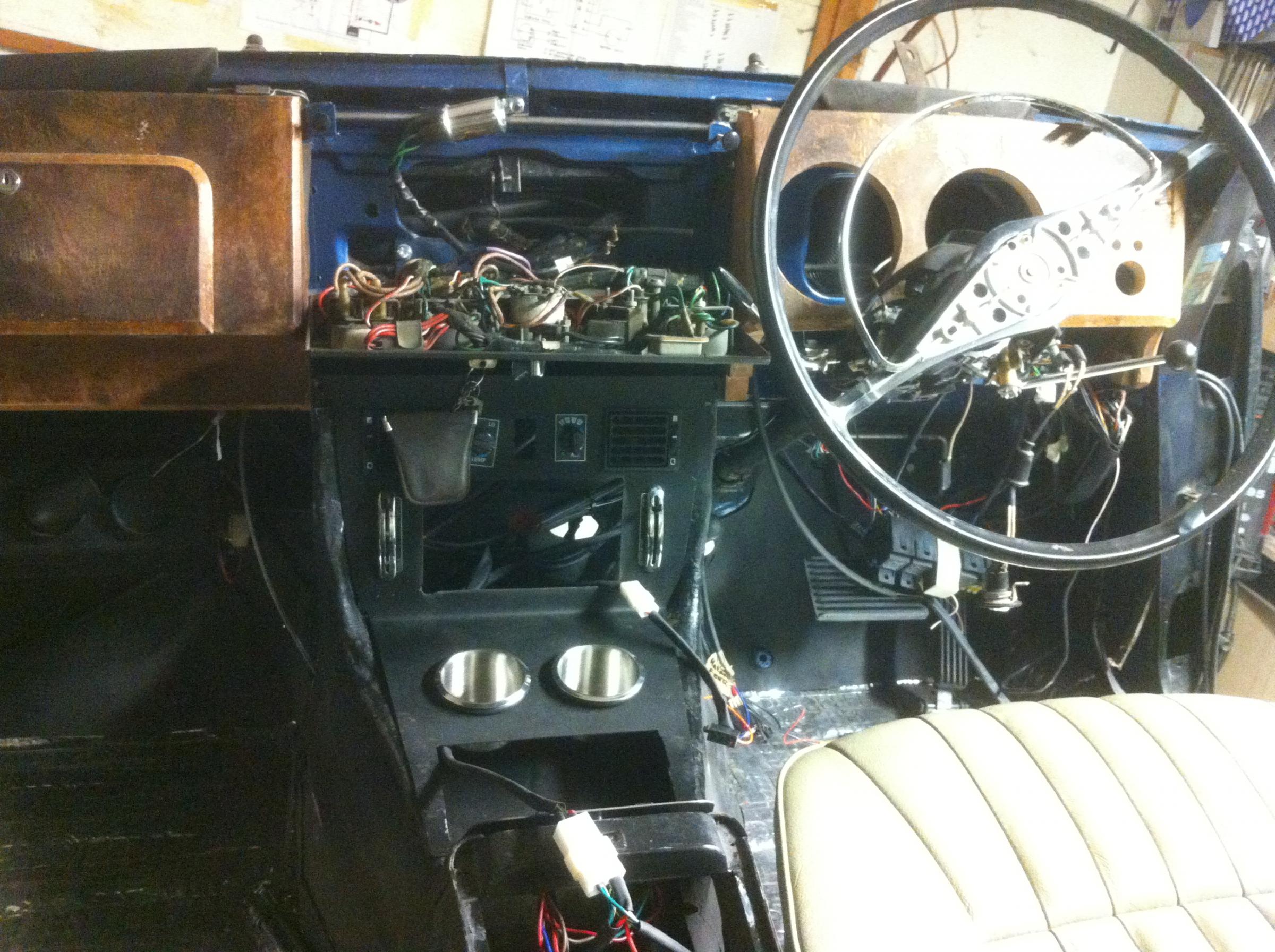

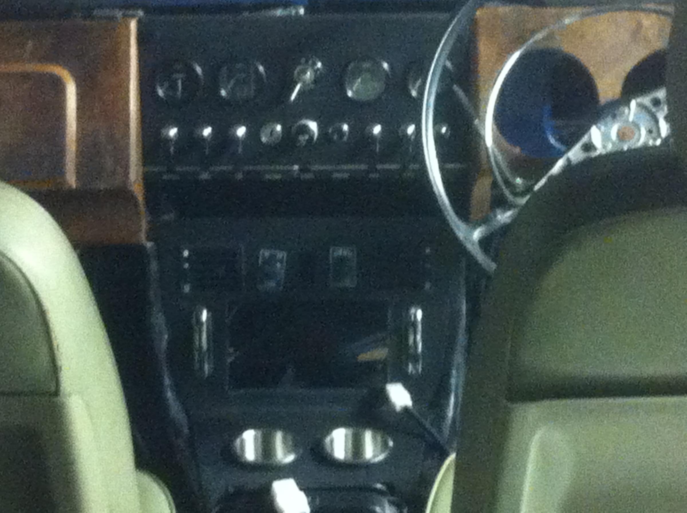

I went for a new centre console from an XJ 40 but with a modern twist I have added a double din radio with Sat Nav and rear view camera. I have also gone for a sliding screen to allow for the screen to be more angled when you are driving.
I have not got picture of final installation but can show basic concept of centre console when I did a trial fit last year.
