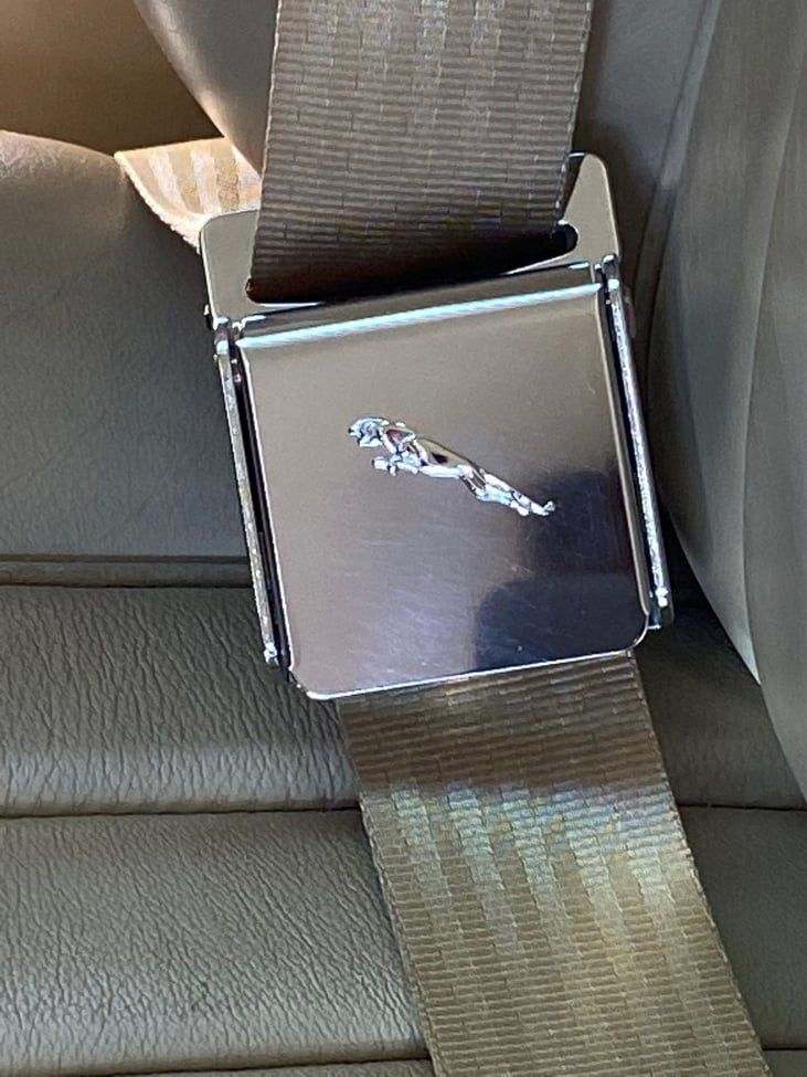

Safety Belt Services | Seat Belt Manufacturers & Seat Belt Repair
Pictures credit Primaz ~ California.
And they have many other options to mount on the B pillar. They also do Daimler buckles.

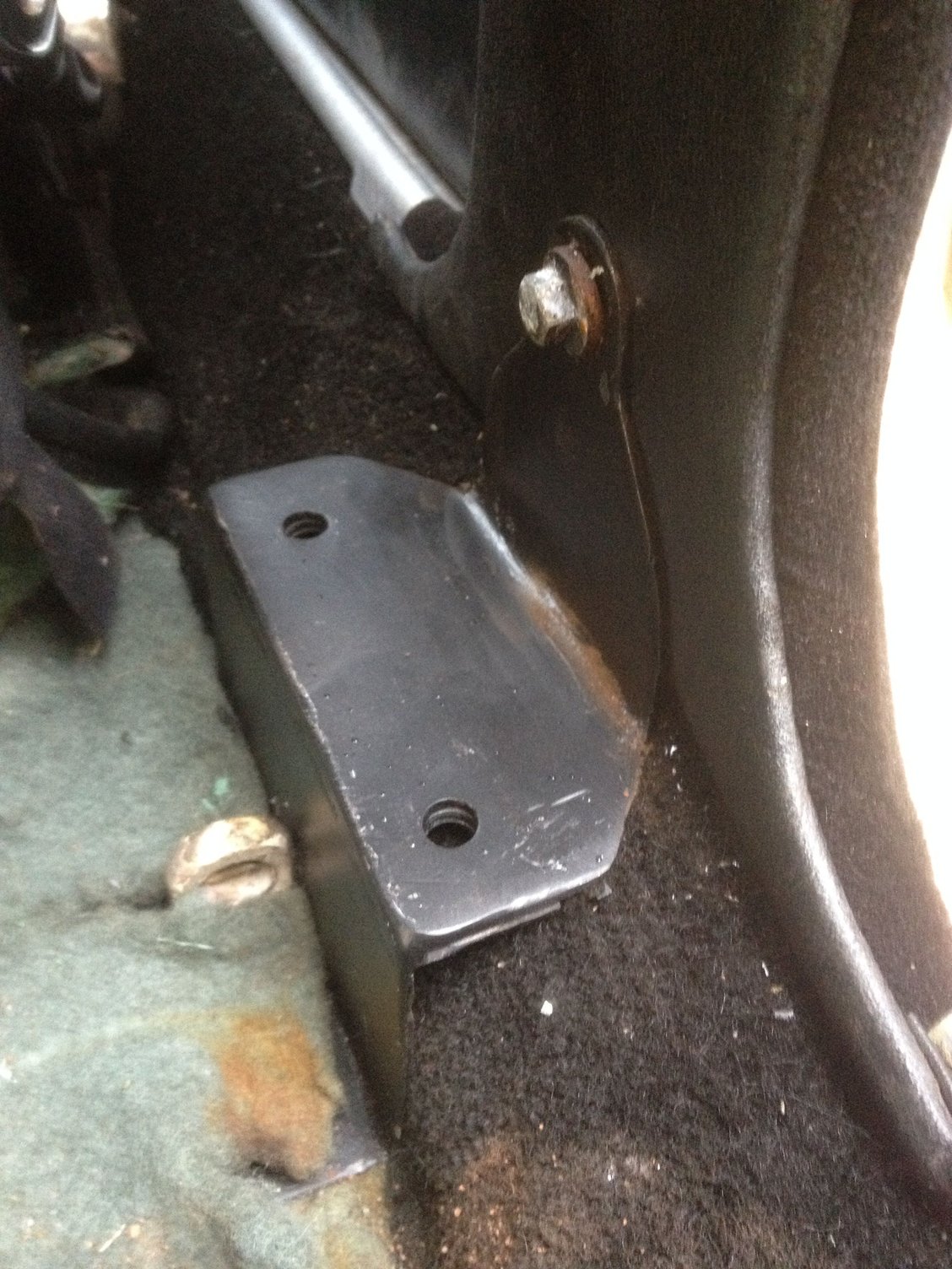

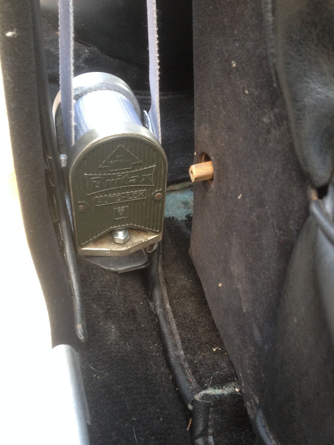

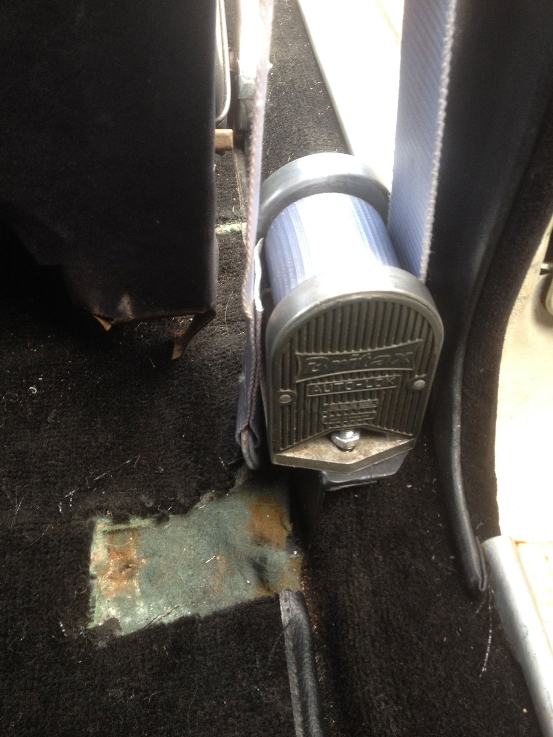

There are a couple of methods of bolting the inertia reel to the floor or rear parcel shelf.

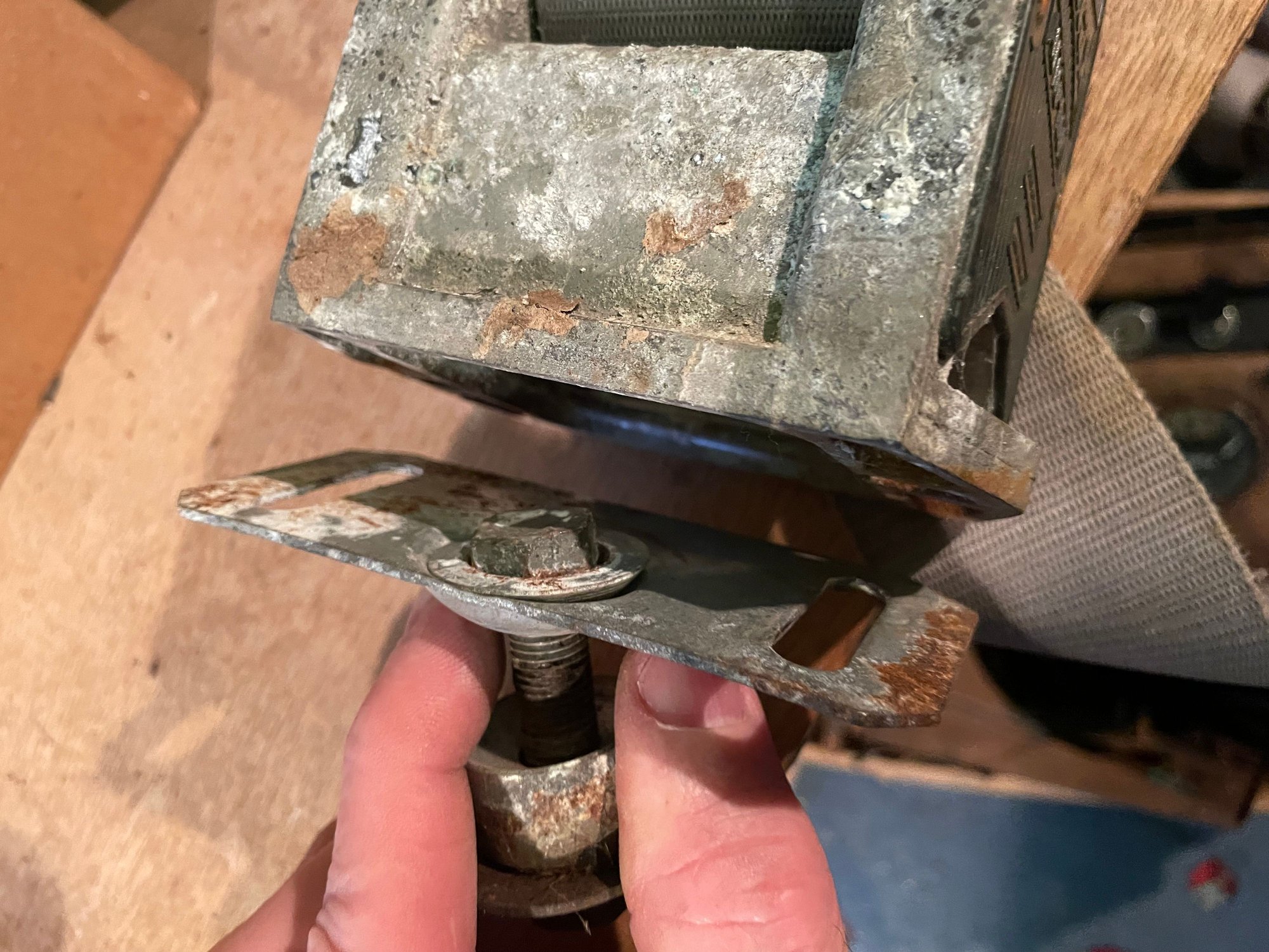

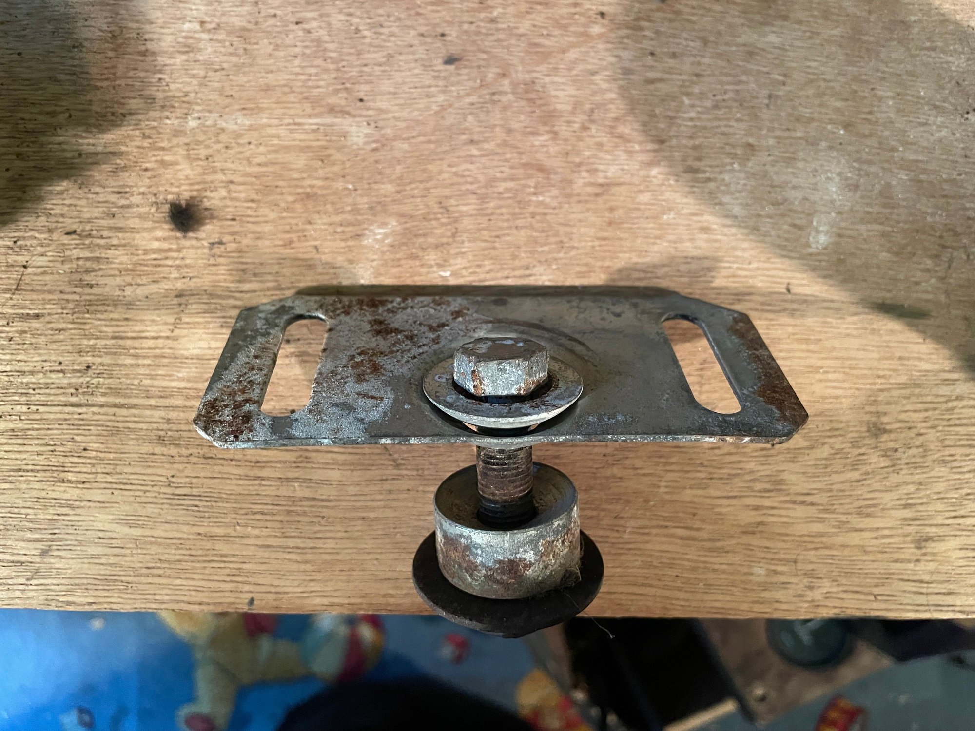

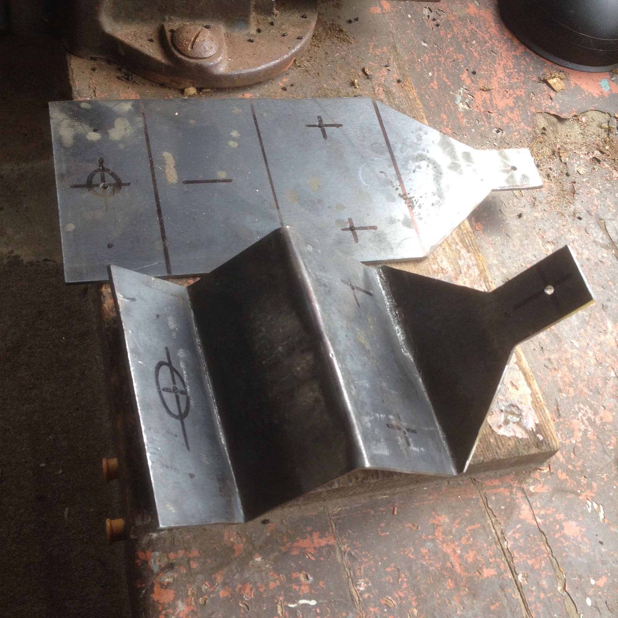

This the original type of bracket for attaching the initial reel block to the rear parcel shelf. It is a plate with a single bolt going through the factory fitted threaded hole in the rear shelf and on top of that is a swivel plate onto which the inertia reel is bolted. It allowed the inertia reel to have some slight sideways movement for comfort. Ignore the condition of the reels these are not ones I have used. I also only fitted standard belts in the back as the inertia reels on the rear parcel shelf looked really ugly and blocked a lot of your rear view.

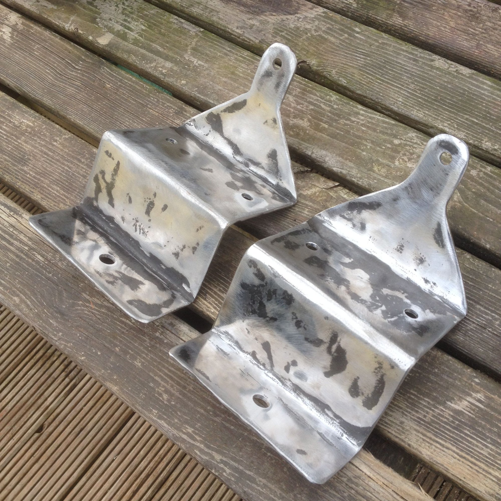

For the front seats there was also a bracket made. When I first fitted my inertia reels in the front I noted there was not enough room for the inertia reel block to sit between the side of the seat and the "B" pillar so I mounted it on the floor just behind the seat. Problem with this is that it got in the way of people getting in the back seat as they were hitting their toes on t all the time. No good for a wedding car. So I was at a show one day and saw another S type with inertia reels fitted to the front seats but they were mounted on a bracket which sat over the top of the sill adjacent to the "B" pillar. I went home and made a couple of brackets to fit my car which are both bolted to the floor via the eye bolt and to the "B" pillar upon which the inertia reels sit out of the way. The only thing I had to do was remove the recline handle on the side of the seat as this interfered with the reel stopping the seat from sliding back or forth. The handle is in the glove box now if I ever needed to recline the seat.

The set up in mine looks very similar to your final two photos, they are the same sort of seatbelts and a virtually identical bracket arrangement (although the bracket looks factory made rather than bespoke).
