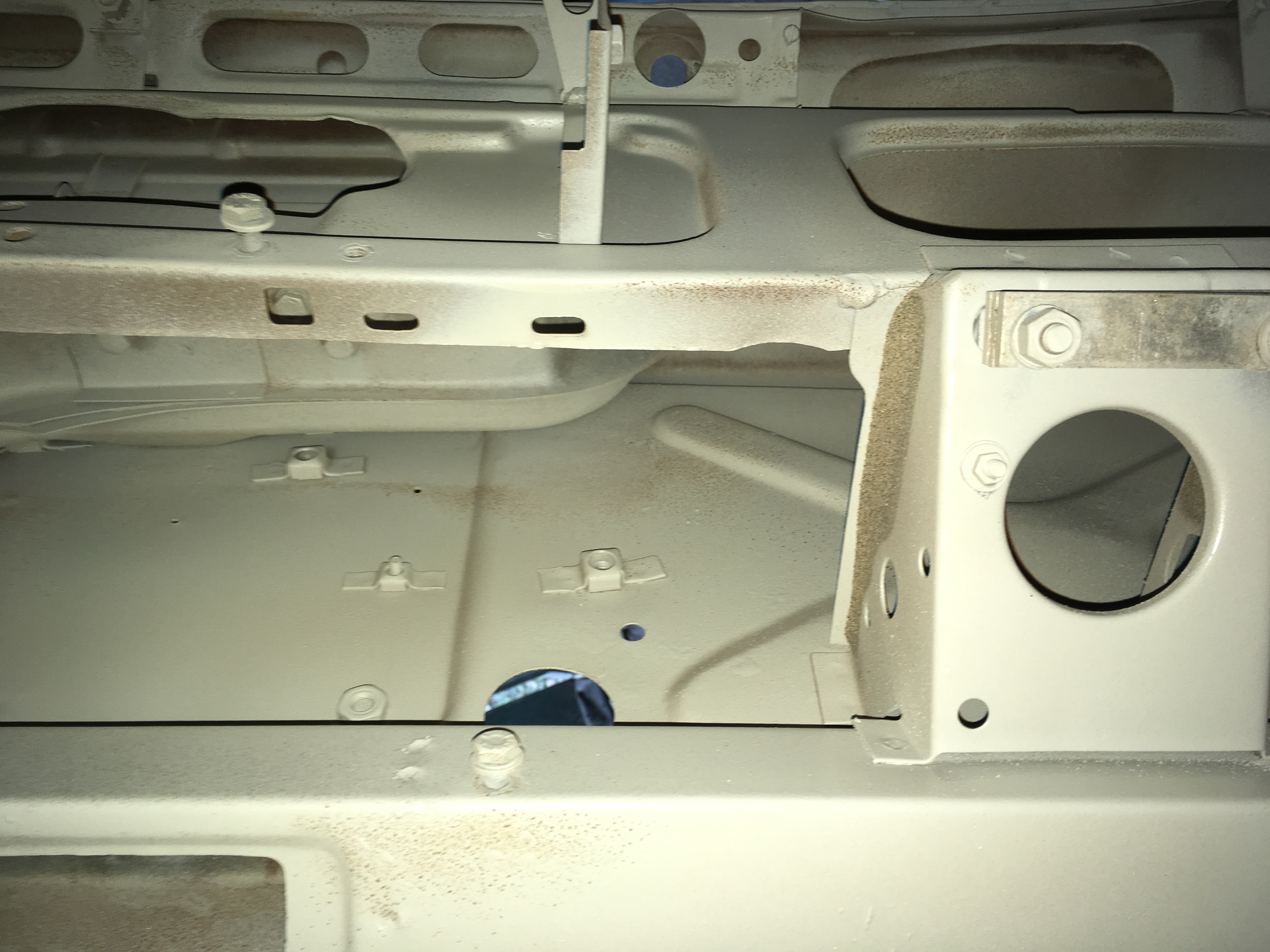

Ah I see, I assume it all goes internally (not through the firewall), mine is manual so I can't give you a complete answer, but as no one else has chipped in here, I can only help so far. I have attached a shot of the stripped internal, I can't see an obvious fixing point for the bracket, I don't know how stripped your car is, but maybe you can see if there is some difference which may help.

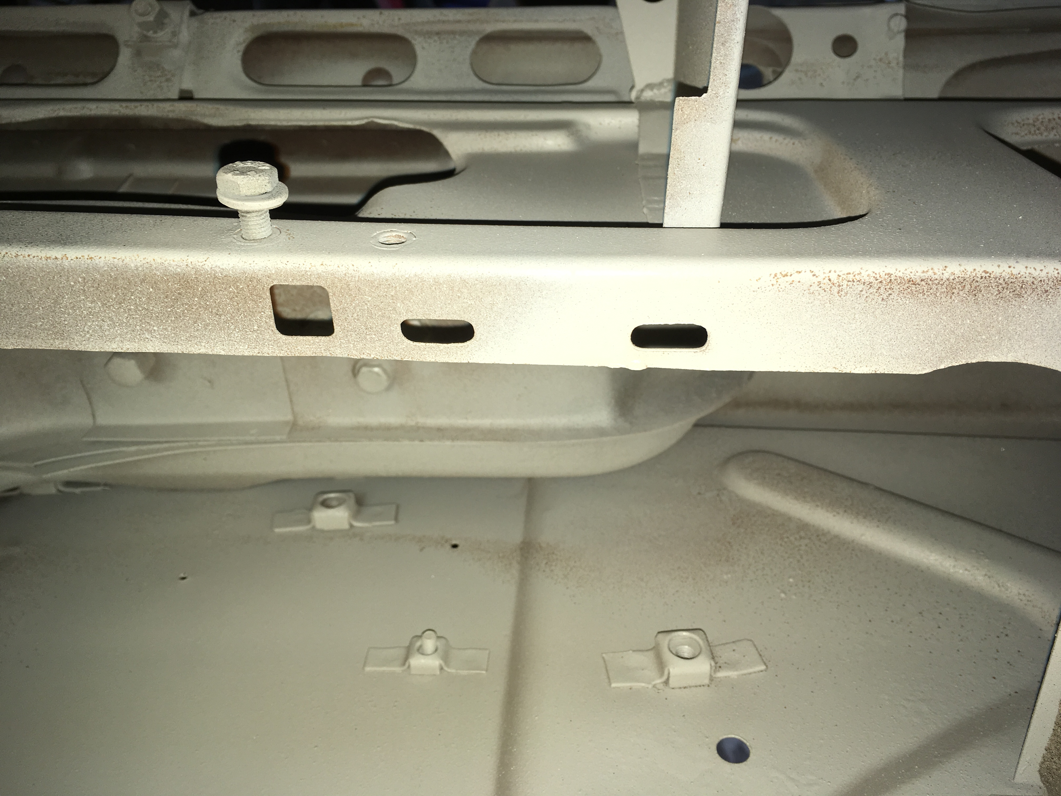

I have looked at the parts diagrams, I see the early version is on the left, I have taken another look at mine, attached attached are 2 pics of where the bracket may attach (2 slotted holes to the left of the steering column mount), it appears to be in the correct place / area anyway.

Thanks for the photo, my car has two holes in the bulkhead just to the left of the two pictures you have taken which appear to be the correct spacing for the bracket but when fitted in this location the cable doesn't seem to be long enough so something isn't correct.

That makes sense, mine is a later car, so as your linkage is on the left I would expect the bracket holes to be further left too.
Unless I'm going mad (which is possible) if the linkage is fixed to the steering column the bracket can only go in a fairly specific place as such ? I assume it's the original cable, how short is it and where are you routing it ?

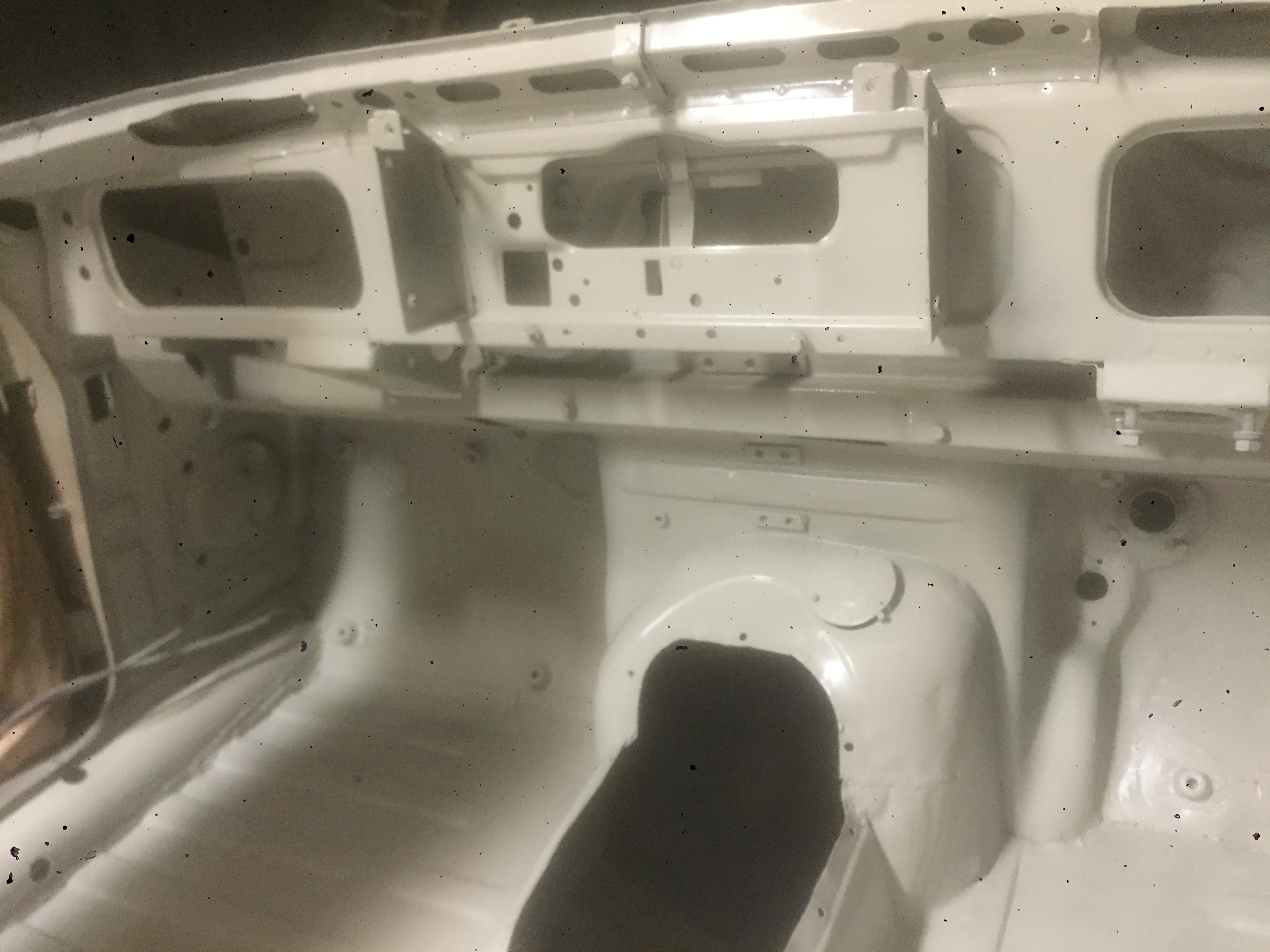

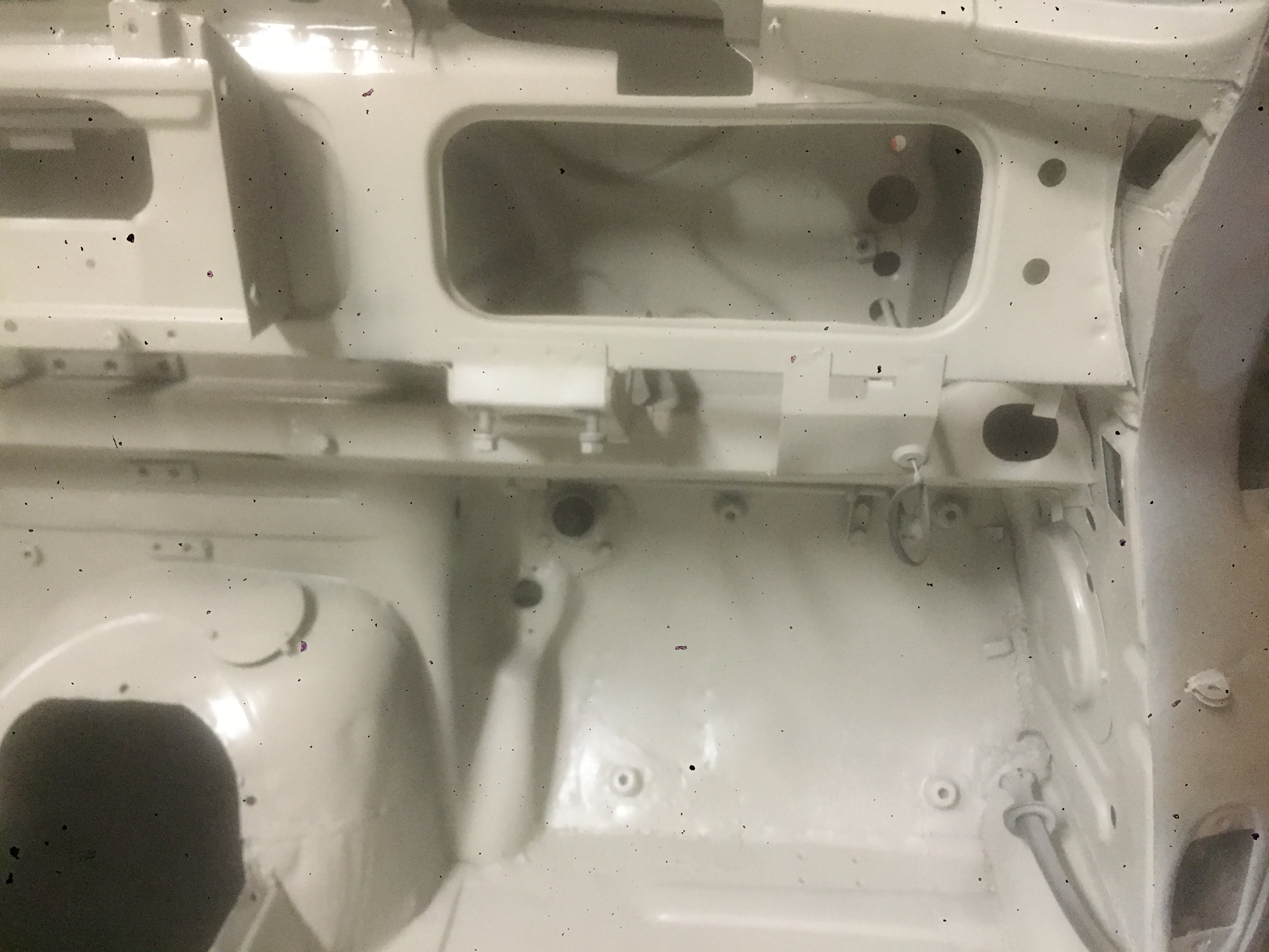

Hi,
Your correct that the brackets can only go in a specific place which is where the holes are however, there is a metal plate welded to the bulkhead at right angles which fouls this which made me think that I had the wrong arrangement or the bracket needed to be rotated 180 degrees (which makes the cable far too short).
Having looked at my old photos it appears that this plate was bent initially and I bent it the other way when I replaced the scuttle air intake plenum.
The bulkhead on my car may have been converted from a MK1 as it has several large holes that have been welded up and a few that are just blanked with grommets and it may be that this metal plate did something in a MK1 (possibly the gear change which was in the centre of the dash I believe).

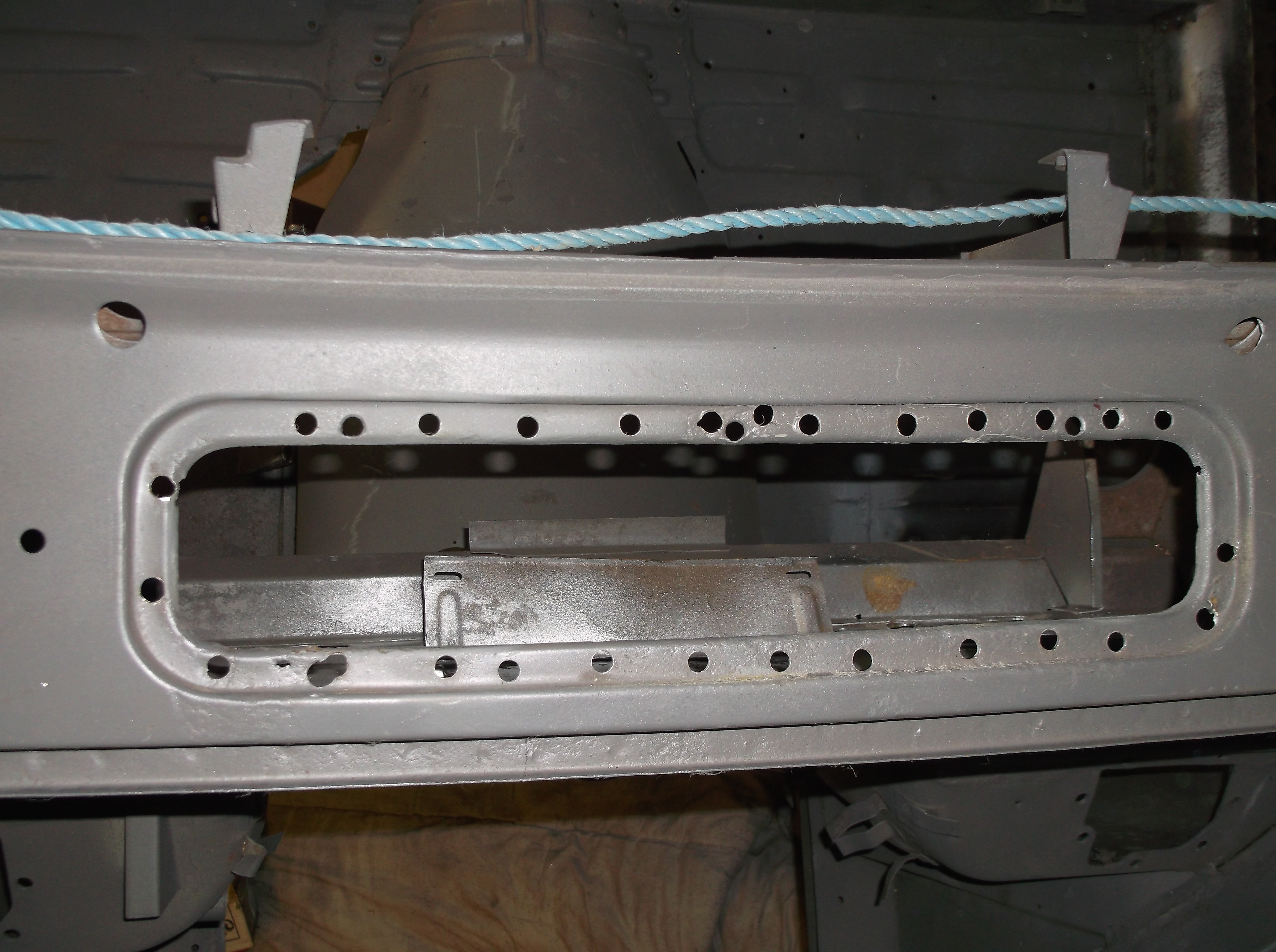

From the photos above it appears that your car doesn't have this, the photo below shows this bracket.

Blimey that does look odd, is that bracket inside the scuttle plenum ?
