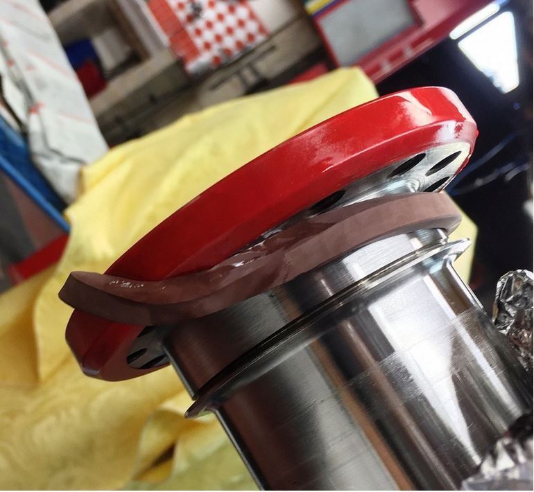

The latest seals are not in two parts/split. They stretch over the flywheel flange on the crank & reform themselves to size. The housing compresses them. The seal appears to be just slightly oversized until installation of the bottom cap which is part of the compression mechanism in place of a garter spring.
Acetic acid curing RTV sealer should never be used. It promotes rusting. Use Yamabond. Vastly superior.
You have to be ultra careful that you don't pinch the seal at the upper/lower joint interface.

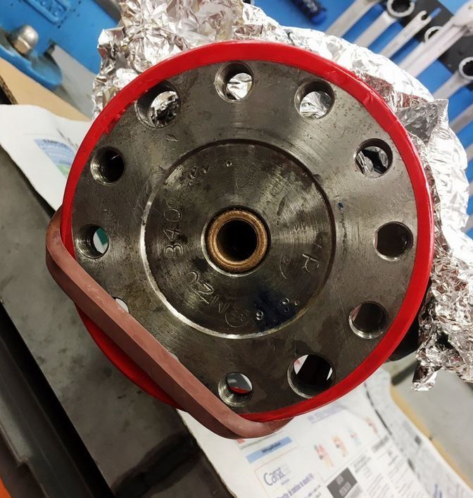

Latest conversion. Seal should be well oiled before stretching over red protector. They are produced for a number of makes.

At last, an upgrade that looks worth effort! It's the one from Rob Beere, so it should be good.
