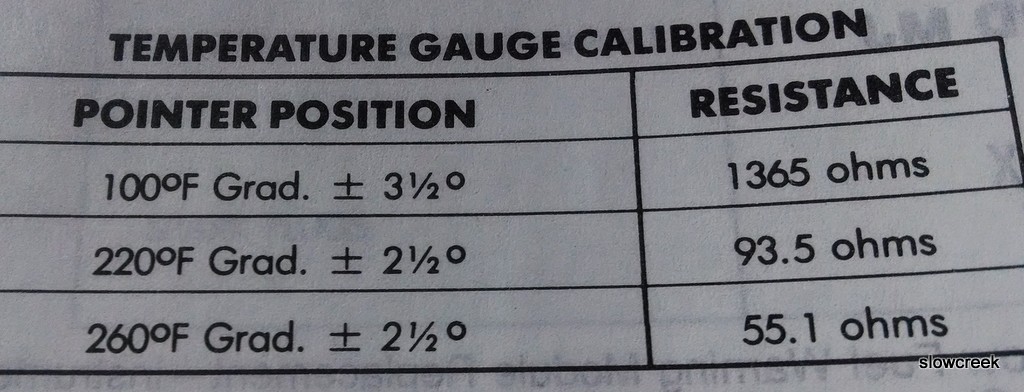

Does anyone have the ohms values for the water temp gauge?
I've got a gauge that reads high after rising quickly, even though the temp is just fine.
As an example, here's what I have for my Jeeps:

Are you looking at the actual gauge resistance, or the temperature sender resistance.
The gauge should be the same at all readings, it is the sensor that changes value.
I would check the voltage stabilizer output voltage, and look at the sender, the gauges are usually fairly reliable.

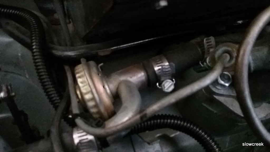

My heater valve looks nothing like the C16559 pictured in the online catalogs. Mine is vacuum actuated and it's stuck open.

Here's what my heater valve looks like.

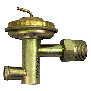

I already replied to him. The original heater valves for the S type are no longer available.
What he needs is a Normally CLOSED, opens with Vacuum, Heater valve with 5/8" ports and a 1/8" to 1/4" vacuum port.
you can get those in autoparts stores locally.
What he may have is a Normally OPEN, heater valve, or a bad heater valve. Easy to replace.
the valve in his picture looks like one from a GM car, (picture below), but it doesn't matter as long as it is NORMALLY CLOSED / OPENS WITH VACUUM.
