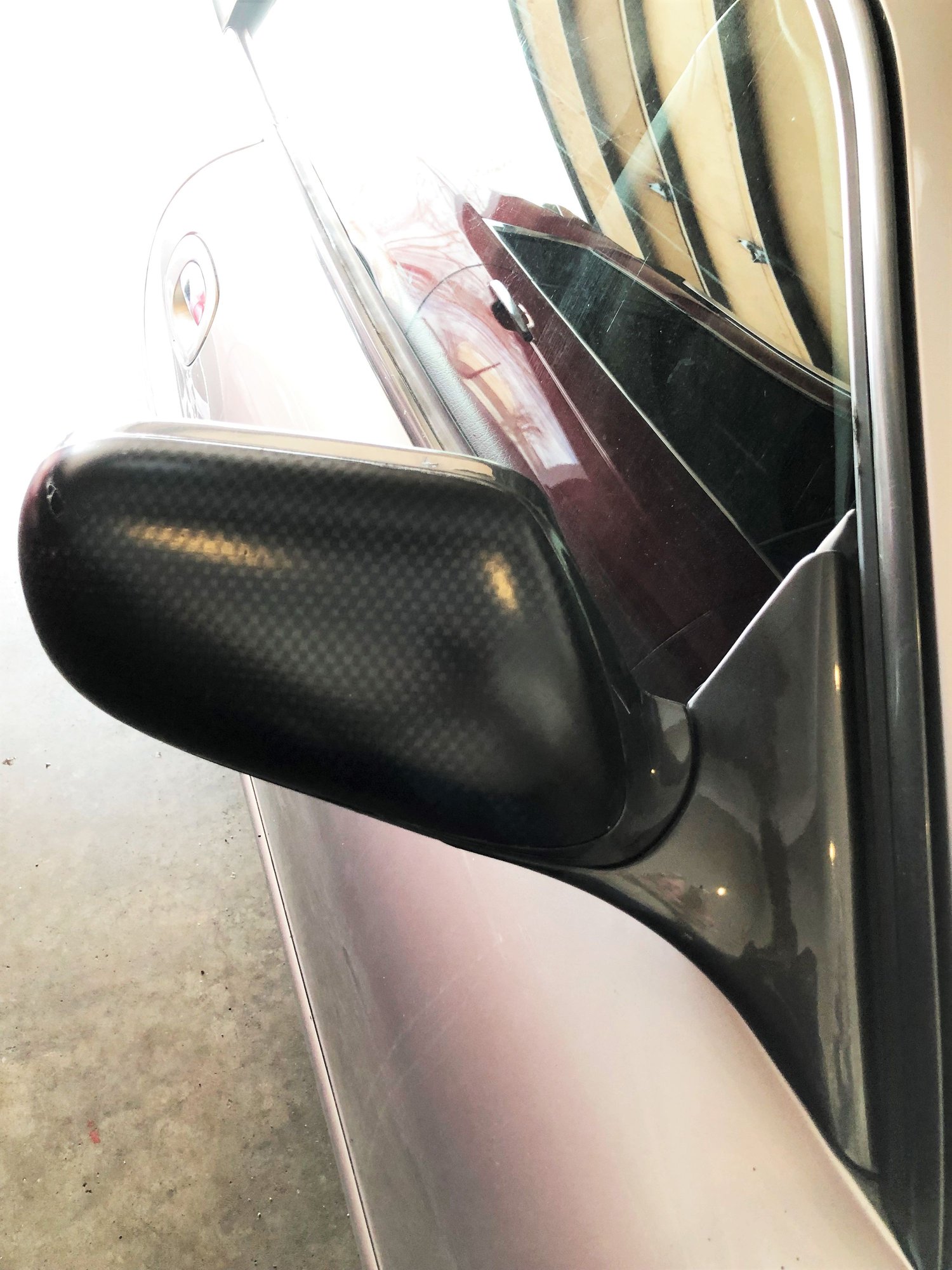

If you want the look without the rest I've found the best for me is the Dupli-Color Carbon Fiber Kit.
1. Prime it
2. 2 coats of base coat (light):ten minutes between
3. Walmart (or their) template laid tight to the area. One hour.
4.Top coat: 2 wet coats back to back (no dry)
5. pull the template and put a clear coat over
Done deal
