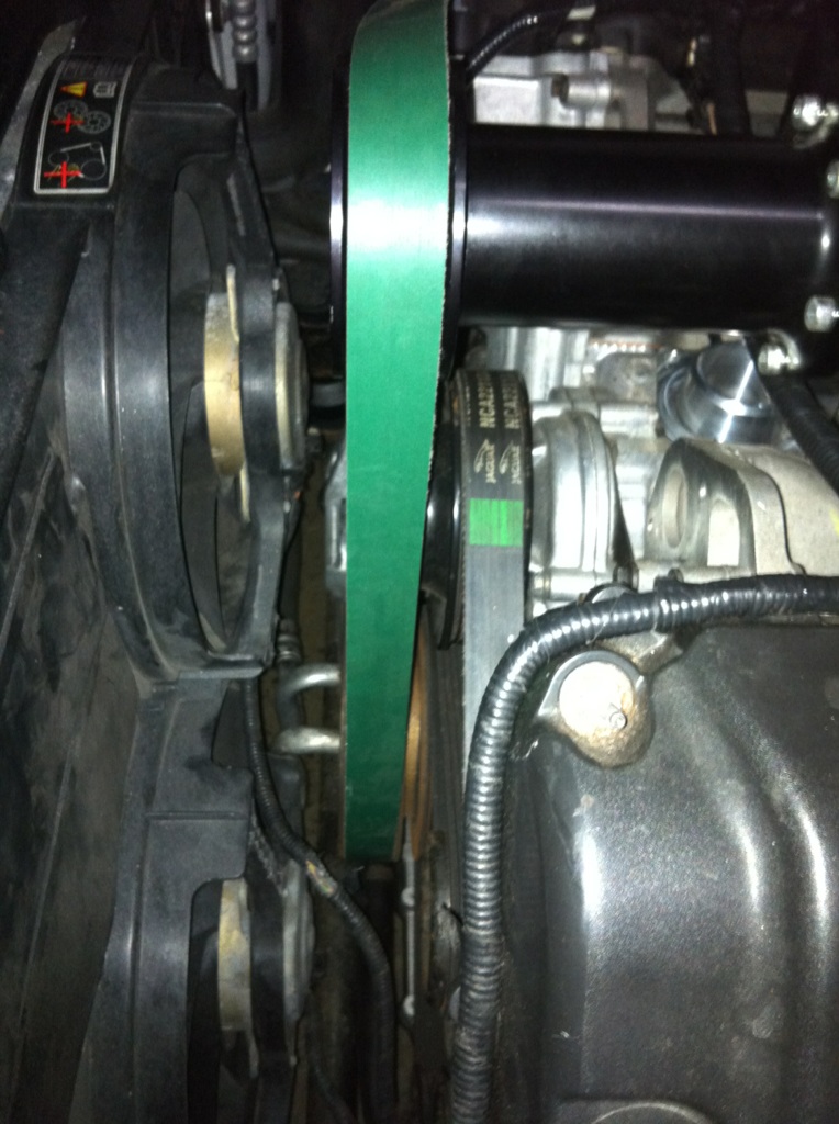

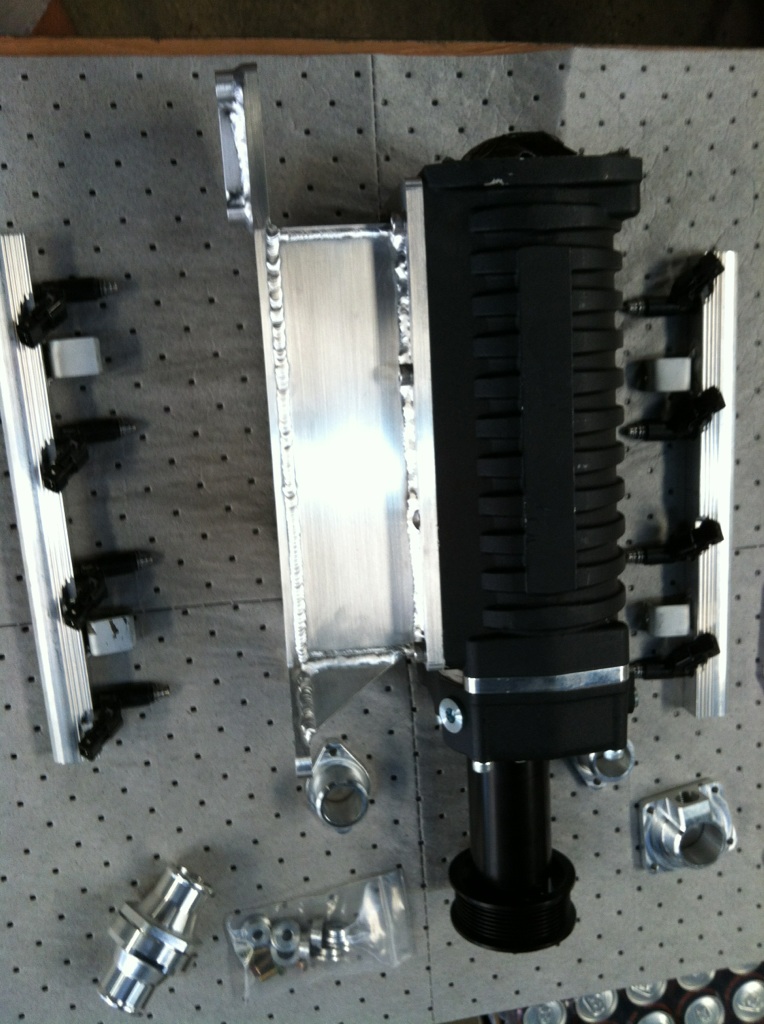

Our customer came to us and wanted an extreme build making around 700HP, so we went to work and this what has transpired:
  • BIP Steel sleeved XJR block
  • BIP ported and polished heads
  • BIP custom fuel rails and injectors
  • Forged Ross pistons and rods
  • 2.9 whipple with custom intercooler and intake manifold to bolt to the Jag block
  • BIP custom built longtube headers
  • BIP tuning done by Tony Lawshee
Thanks for looking and let us know if you have any questions.
Whipple 2.9 with intercooler, rail, injectors, throttle body plate etc...

BFSGross, to answer your question, yes sir we can. We are going to be cutting an intake manifold for our E85 E55 car, so we can install a Whipple 2.9 on it.....
The 2.9 whipple that is going on our customers 4.0 XJR, is actually the second intake we cut, and second Whipple been installed. We originally went with a 2.3 Whipple and specific intake for that size blower, but it was not going to generate enough power, so we sent that unit back to Whipple, and got the 2.9
As a result, a second intake had to be cut for the larger unit.

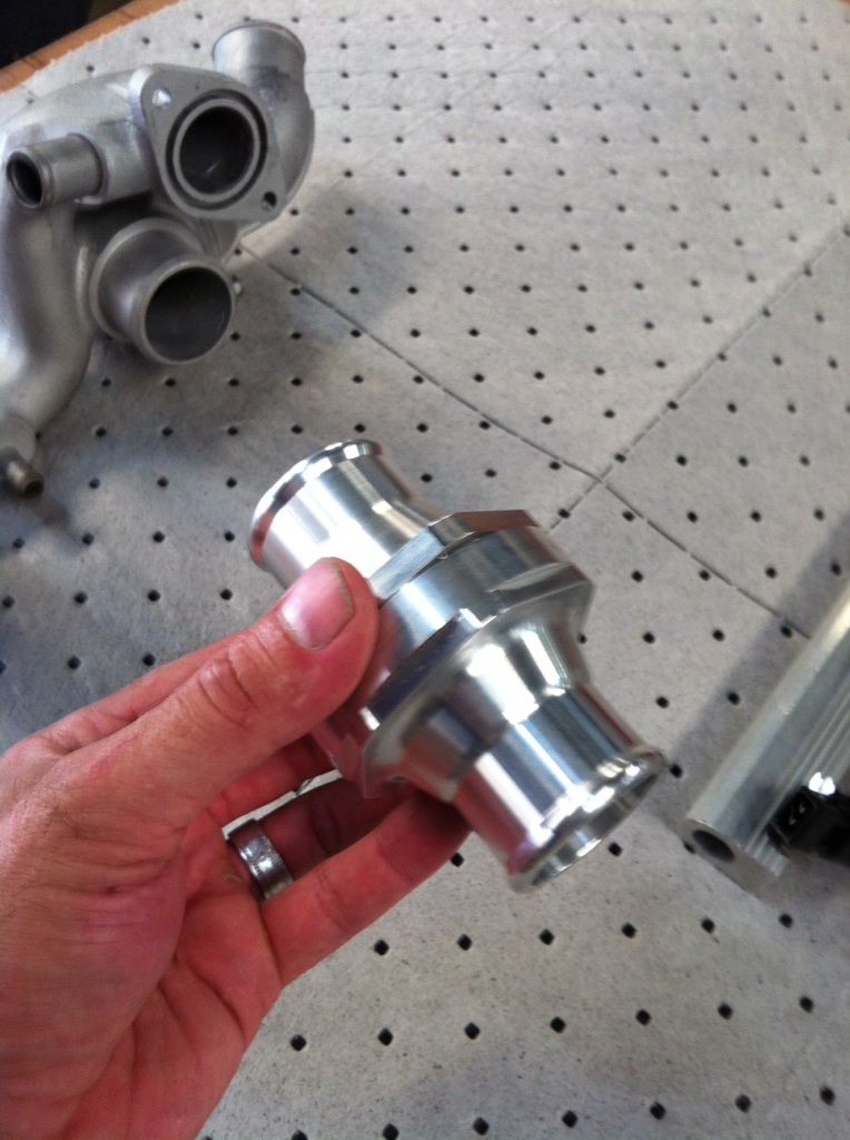

Also I love that fitting for the water pipe under the sc. Any one who has pulled the sc off has looked at that hose and thought WTF.
