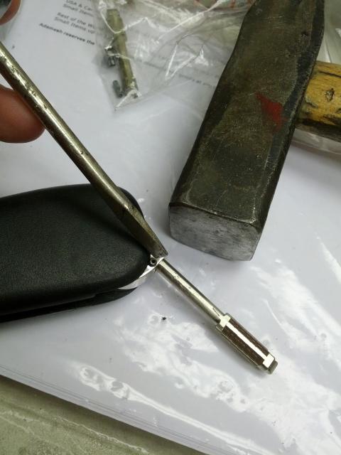

Yes you can, the key is held in with a small pin that you just drive out, but you probably don't need to,
The fob and key/transponder sections can be separated so you just need to replace and programme the fob.
