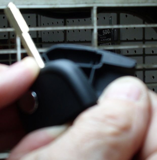

Now I had a strange problem when I purchased new keys/FOBs on EBay. One of them came without a transponder!! This would have been a real disaster because I only had one key for this car and after wiping all the keys only to find out one of the new ones would not program!! I was lucky and got curious about how these keys are made and took both of the new ones apart and found it missing.
Terrible picture because I had to hold the FOB with one hand and try to take a picture.
