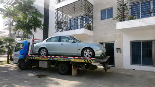

Hi guys, here I will be updating my progress with the repair of the Jag and asking for some help.
This is how I end up with the S Type.
https://www.jaguarforums.com/forum/new-member-area-intro-must-5/new-jag-guy-241342/
And for the update, I couldn't start the car, I think is not a security system problem. So, yesterday I put new tires on it and send the car to my mechanic, let's see what happens.
One thing that I want to ask is about the key Fob. I opened and cleaned it up, but still not working. I read that if you don't use the key fob for more than I year it stop working and will have to be reprogram, is this true?

Glad to hear the progress! Easy fix too. They are the best.
Now be sure and get 2 keys that work.
Before it's too late.
