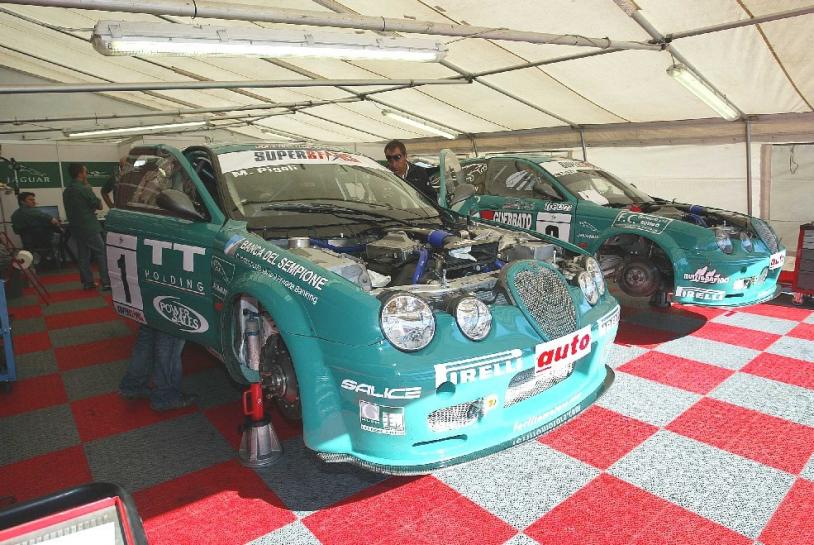

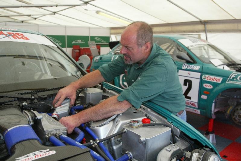

I think there was a post a while back on this you may want to look for, there is a Jaguar racing team that has the same set up but they had to move around a lot of parts to make it work.
Old Feb 10, 2009 | 01:03 PM
jaguarevan's Avatar
Joined: May 2008
Posts: 92
From: Toronto
found it...the post was by WhiteSTR, the racing team was ferlitomotors. If you could somehow replicate this and then schedule me in to get it done it would be appreaciated. I think I attached the pics correctly...

Thanks for the pictures. Their intake is made of carbon fiber, mine would just be plastic from a corvette intake not sure what year yet pre 04 or after 04 depending on fitament. Then some fabbing to attach it to the intake inlet since it is oval. They also did not put the filter in the same location, my idea was to put it behind the mesh grill. Car won't be back till tomorrow now, so still waiting.

Your main problem is going to be clearance.. What you would have to do is move your coolant expansion tank to another area inside your engine compartment to allow for the tube to bend over the area behind the grill.. The second problem your going to have is that you need a custom tune or your car is going to take a sh*t.. When your MAF starts reading that much air its not going to know what the hell is going on.. Do a simple test like driving with your airbox lid detached and observe the results.. These cars are just wayyy to sensitive.. Lol once I forgot to snap the lid on my intake box down and it threw a CEL, it really did, that's not a joke.. Snapped it down and vuala reset it and it never came back..
I really don't want to burst your idea bubble.. I'm not that big of a jerk, I just want to put a little FYI out there.. I spent like a month trying to design new feed tubes for the factory intake box (one to the engine, and another to the grill), and after breaking a lot of stuff, the car still ran like crap until I put it back to stock.. Its a shame no one like K&N or Fujitsu will design an intake for our cars, but that's just the price you pay to drive a car they made less than 2,000 of..
Don't just take my word for it though, its better to experiment and get your own results, maybe you'll figure out something I didn't?... Best of luck to you and let me know if you have any other questions.. Eric
