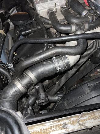

Part 4 of DCCV install. Topped off the Jag on coolant before, and attempted to purge the cooling system of any air in the system.
Went for a quick drive around the block and as luck wouldn’t have it the temp gauge spiked after struggling to climb initially almost to the red. Keep in mind I also had a device plugged into the obd2 to monitor coolant temps and they were steady for 5-10 minutes before I drove. Before I drove even I let the car idle for some time to let it sort itself out and it was still cold.
Highest I saw the temp get to before I shut the engine off while rolling was 245 and I cut the engine off and coasted into my driveway. Checked everything on the car and it seems okay, but I’ll let it cool off and try and purge the cooling system again. Guess I got lucky, but I’d rather that than an engine with a warped block.
So far since having let it cool down for a few hours, it’s been topped off twice so it seems there was a lot of air in the system.
Really baffles me as I even removed the Hex bit on top by the supercharger to get all the air out before I drove the car, and topped off the reservoir of course, and it was fine..
Also will be interesting to see how this Walmart AGM battery holds up.
O Riley batteries I’ve had haven’t been the best to me. Last one leaked battery acid which I had to neutralize with vinegar, and the one before that only lasted a few months before it simply tested bad. Alternator has tested fine, and of course orileys didn’t warranty the last battery even with a receipt so I let them keep the leaky battery.
Was extra careful to ensure the little clip to the reservoir was on properly. Had to do some maneuvering around to ensure so, but it seems it’s keeping coolant.
Might want to get a pressure clamp on that top radiator hose, as opposed to screw clamp. It will back off over time.
