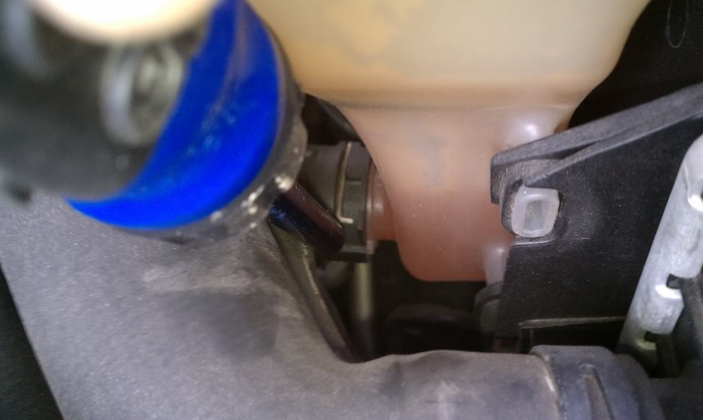

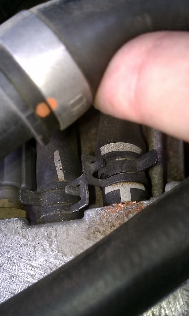

Took the intake and expansion tank off today. All 3"nipples" were fine, however I saw some signs of leakage from one of the upper radiator hoses. Went to Advanced Auto Parts, didnt have it in stock, but was around $75 just for the hose and would take 2-3 days to come in. I may have lucked out with this one. There were no cracks or cuts, but as you can see from the pics it looks like it expanded before the clamp probably causing a bad seal. I filled the tank, it took both bottles, and am going to see if I can get this tube elsewhere, quickly. The surrounding area had a couple of wet spots, clearly coolant. Could this upper hose really cause such a huge loss of fluid??? Take a look:
Lower Nipple all set:
Orange "blood"

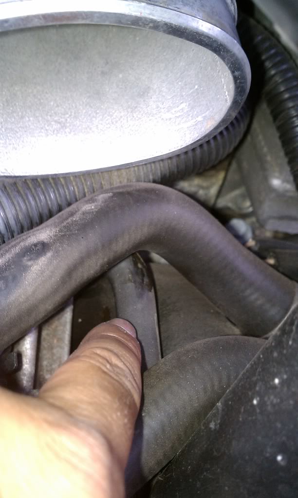

This is the upper hose
The deformed hose
Old Aug 22, 2010 | 08:29 AM

It looks to me like you just need to put better clamps on where the spring clamps are used. For the water connections that are metal take a SS brush and clean the metal really good to get rid of any corrosion. Even a strip of emery cloth works really nicely. Then coat them very lightly with some silicone grease (NAPA) or Dow Corning 111 "the best". That will forestall future corrosion and it makes getting hoses off a lot easier later on.
Check those plastic fittings very carefully. One could be cracked.
The best clamps to use are the ones with a rolled edge. Don't tighten the life out of them. With the grease on there they will still slide around a little on the fittings but that's OK. They won't come off and it helps to seal minor leaks due to surface irregularities.
I've been having to maintain vintage Italian alloy engines for 30 years and this really does help. The collant stagnates in between the fitting and the hose just before the clamp and deteriorates.
A system pressure test before you took everything apart might have been helpful. So do one when you're done to be confident.
BTW, if you have too much antifreeze in there it will just degrade your cooling system's ability to cool a bit. You could drain twice the amount you added and then replace it with distilled water.
