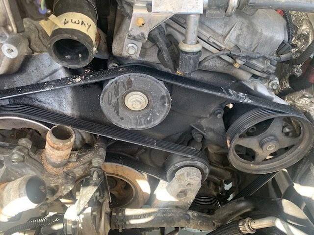

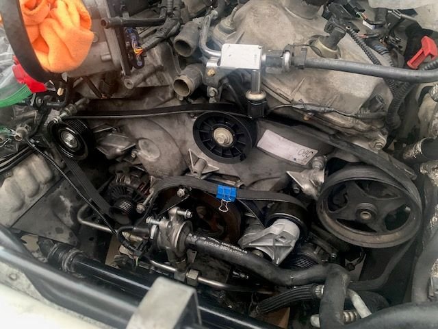

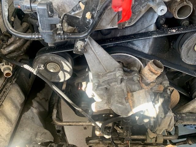

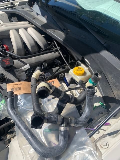

Finally some completed work on my cooling system. When I bought the car last year. I drover it home 100 miles fingers crossed guessing that there was a coolant leak somewhere. I drove the car locally over a few months but had to keep topping off the reservoir and would often get the odor of coolant. I assumed buying the car it would need a Water Pump and belt at minimum. 99K miles and no real service records. A nice driving and looking car. All the service has been DIY. Oil change, Transmission fluid and filter and Diff. I slowly collected every hose and component of the cooling system. The good new is. As of March 2025 , one can buy every hose, pulley, water pump, belt and tensioner. FCP auto, Rock auto, parts geek and ebay. Not a single source has them all. The water pump was the worst. Oh yes a Nissen radiator. From FCP and they do come packaged well and functions great.
Boy this project needs a lot of patients. The bottom apron and chin plastic all need to come off, Ramps are needed to access everything from below. The hoses are complex and all need to be labeled on removal. The water pump is easy except for a bracket holding a vacuume line that needs to be loosened before final removal of the pump. The thermostat housing was so corroded it was trash. Everything had a crust of crystalized coolant and or corrosion. When everything was off i used Gunk spray to clean the engine front before replacing pullys, tensioner and pump. Like many forum members mentioned, The radiator is tricky getting out. I had to manipulate the side foam and bend the aluminum AC pipe slightly to slide up the radiator. I'm glad I went for the whole system. It's about 600.00 parts. Some Jag original, some rein, some Uro and Gates. I think I researched all the steps and difficulties well before. I have the shop manual. I had the torque specs ready. No rushing and I quit when I felt fatigued. I'm 71 and an a home DIY mechanic.
Now,
The car runs great. Not a drip anywhere.
note below the rein 3 way hose is a perfect copy. I also purchased a rein 6 way hose.
Below cleaned up, new tensioner and pulleys. ready for the WP.
I replaced the coolant reservoir too so I can trust this system 100%.
A few more project to go. Re plumb the windshield washer system. Sway bar rods and tie rod ends. Plus new tires.
I hope this helps of inspires someone to keep another s-type on the road.
Hirst

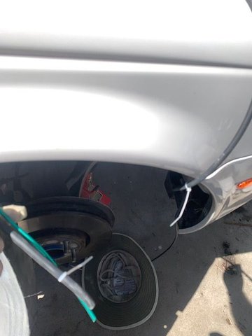

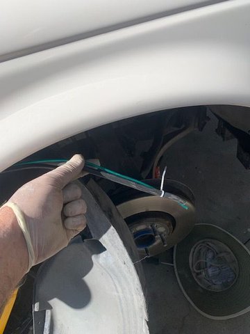

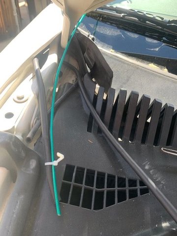

My 2007 S Type needed another project. The windshield washers were not spraying. I could hear the motor running but no evidence of any fluid. After spending some time on the hood restoring the cooling system I could see that the feed hoses were just hanging in shreds. But why no fluid on the ground. I diagnosed two problems. 1) The common clogged filter inside the tank / pump. 2) degraded hoses, possible rodent damage from the past. I read the threads about removing the tank but wanted to try a different approach. I filled up my tank with hot water and coffee machine cleaner. I used Cafiza brand which is used for espresso machines. It says sodium percarbonate and sodium carbonate. I believe this is the same as tsp and backing soda. I left the mixture in the tank and drove around for two days. Each time I siphoned out the tank there as a bit more dirt. finally I filled the tank with water and volia! water was squirting on the ground thru the leaking hoses. Last I bought new hose material from Napa. Both diameters will be needed. I used a plastic coated wire "Green in the photos" to help pass the new hose from the right front fender liner to the right hood hinge and finally re plumb the washers. I did have to remove the front half of inner wheel liner. Pretty easy. There I was able to splice into an intact hose exiting the washer tank. Great to have the washers working for spring as there are big bugs in the air. Photo 2 with the white zip tie shoes the line from the washer tank.
I hope this can help someone with the same issue. Wheel off, Wheel liner 1/2 way off and plastic cover off where the cabin filter resides. That's not too bad.
Hirst
