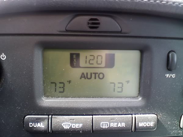

I'd advise picking a cooler day if you can.

Glad you found the leak, and thanks for the tip....
120 degrees, huh? I assume that's in Phoenix. I'd have to either buy myself a walk-in freezer to live in, or put a bullet through my head. No way could I ever handle that kind of heat....

I was in Phoenix on a day like that once. Unbelievable, like a blast furnace. Evaporative misters everywhere outdoors in the shopping areas. It really does work but not in South Carolina because the air is already saturated.
