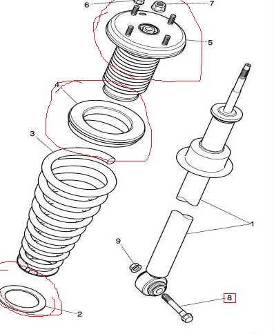

Could be, however if you would take a bro0om handle or a long and not large in diameter PVC pipe and put it on the various parts that could squeak from top to bottom and have some push the side of the car up and down you will probably isolate.
Here are a couple of mechanic's stethoscopes that can help at cheap prices
Mechanic's Stethoscope
Lisle 52500 Mechanic's Stethoscope : Amazon.com : Automotive Lisle 52500 Mechanic's Stethoscope : Amazon.com : Automotive
Could also be in the area of the spring damper mounting, spring isolator or spring packer. Attached is a diagram with red highlights

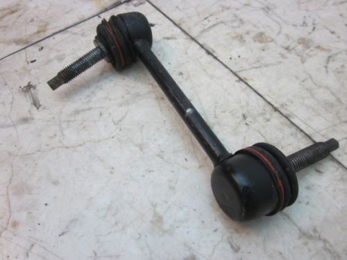

I don't have a picture that shows everything but here is the front sway bar end link. It connects the sway bar to the lower control arm.
If you get under the front end these should be easy to see. They almost always will have split rubber boots so they should be replaced and these are fairly cheap and quick to change. You might consider changing both the front and rear sway bar end links anyway?
I always try to do easy cheap stuff first before changing ANY parts. It could be a lot of things but randomly throwing parts at it will not work and you don't have all that spare money to spend anyway!!
